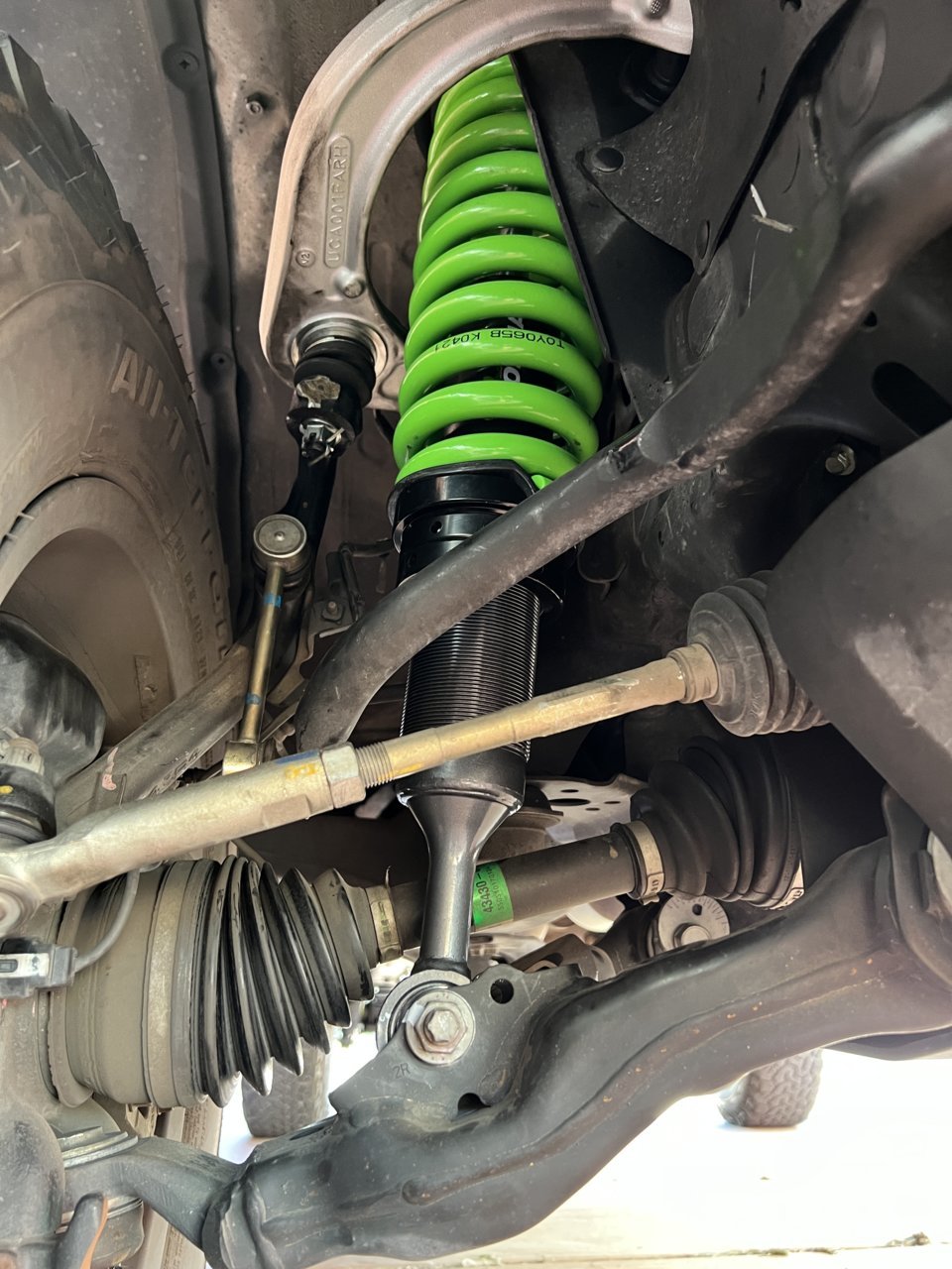

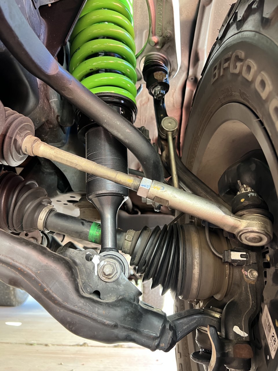

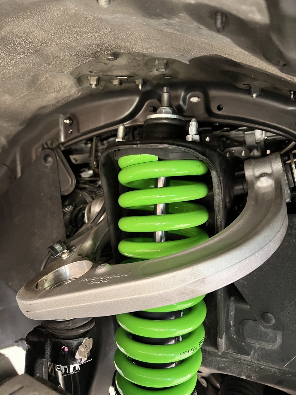

    Great write up! Question, I'm new to this suspension stuff... did some research and got the Ironman foamcell pro stage 2 kit 2.5" lift with performance load. got it installed from a local pro shop, but it has this weird bobbling, bouncing, swaying, can't describe it other than it feels like I'm on a boat. the worse the road the more I feel it. its like its up and down and side to side motion. makes me kind of car sick... when parked if I push the back side I notice it bobbles (like a bobble head), sways, or bounces, about 3-4 times until it settles... so that must be what I'm feeling every time I hit a bump in the road... is this normal? if not is there a way to fix it? anyone else experience this? or is this just how new suspensions with lift works?
  11. Dec 5, 2021 at 9:38 AM
    #31
    hyrule_trd
    hyrule_trd [OP] It’s a Secret to Everybody
    Jan 26, 2020
    #317260
    10,149
    Eric
    Harford County, MD
    2020 Black TRD OR
    Ironman Stage 1 Foam Cell Pro lift kit, 255/85/16 Cooper ST Maxx, SCS BR6 Wheels, SPC UCA, Heated seats, MESO TRD start button, Meso Total Tail v1, Meso V5 mirror white DRL turns, bed decal, ditch and hidden bumper lights, screen protech, RAV4 radio knobs, steering wheel anytime camera kit, dash cam, ECGS bushing, Timbren Active Off Road bump stops with Wheelers flip kit. 35% Xpel CS Ceramic Tint, KD Max Tune, SumoSprings front bump stops, RRW Sliders ‌ ‌ ▲ ▲‌ ▲
    That does not sound right at all. I’ll try and record mine later but definitely sounds like something isn’t right.
    First thing, check that the top nuts are all tightened, then push down each corner and see if there is one that seems easier to move. This suspension is kinda stiff and that does not seem normal. sorry I can’t offer anything else at the moment.
    Try and get a pic of the front struts that show the coils and threaded portion.

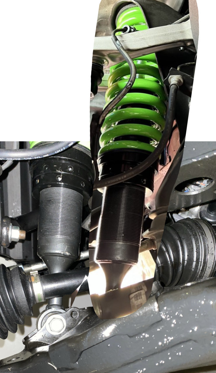

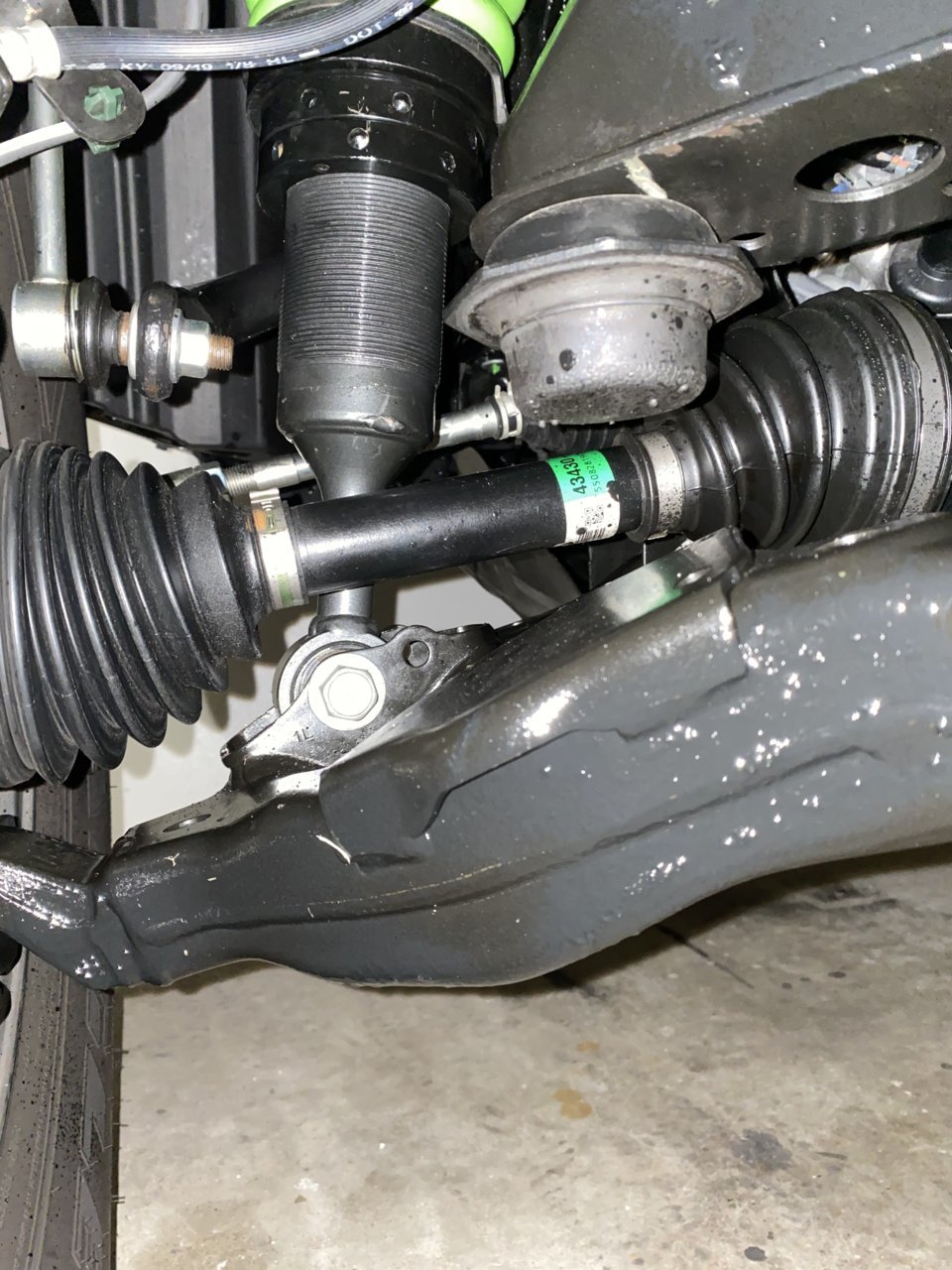

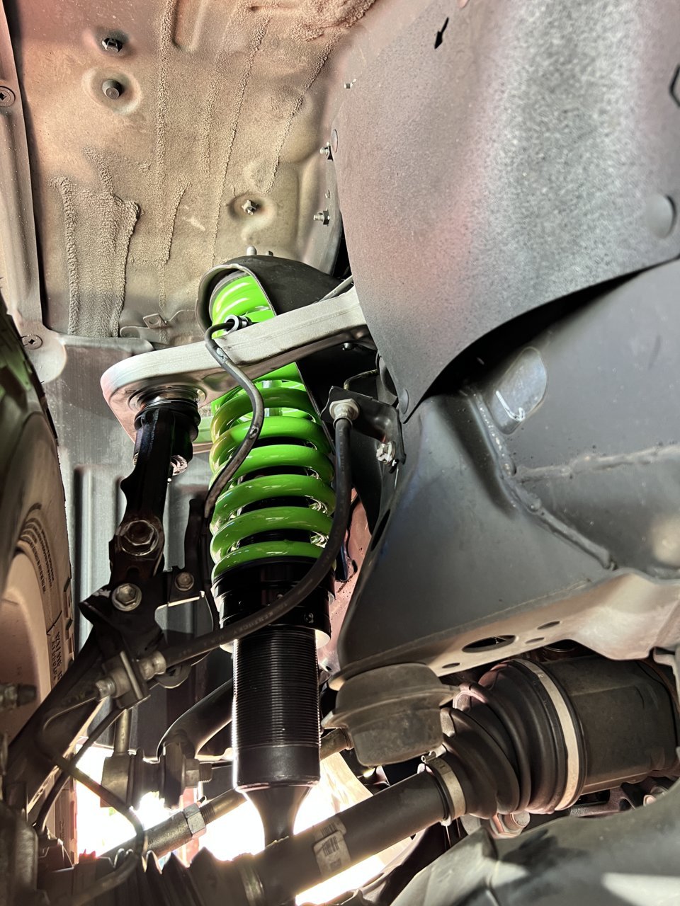

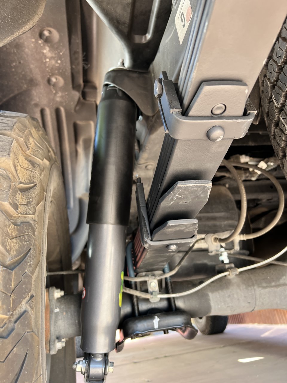

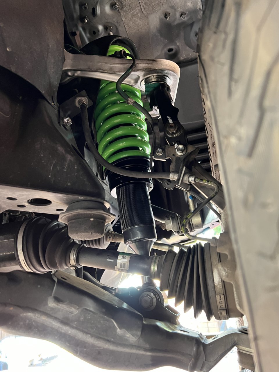

    thanks for the reply, here are some pics from the underside. I'm new to this... but it didnt seem right to me. I've reached out to the installer and they are going to look at it... but just wanted to make sure this wasnt normal behavior. its undrivable for someone that gets car sick easy... like a mile in, ready to spew...
    here is the front drivers side
    here is the rear driver side
    front passenger side
    rear passenger side

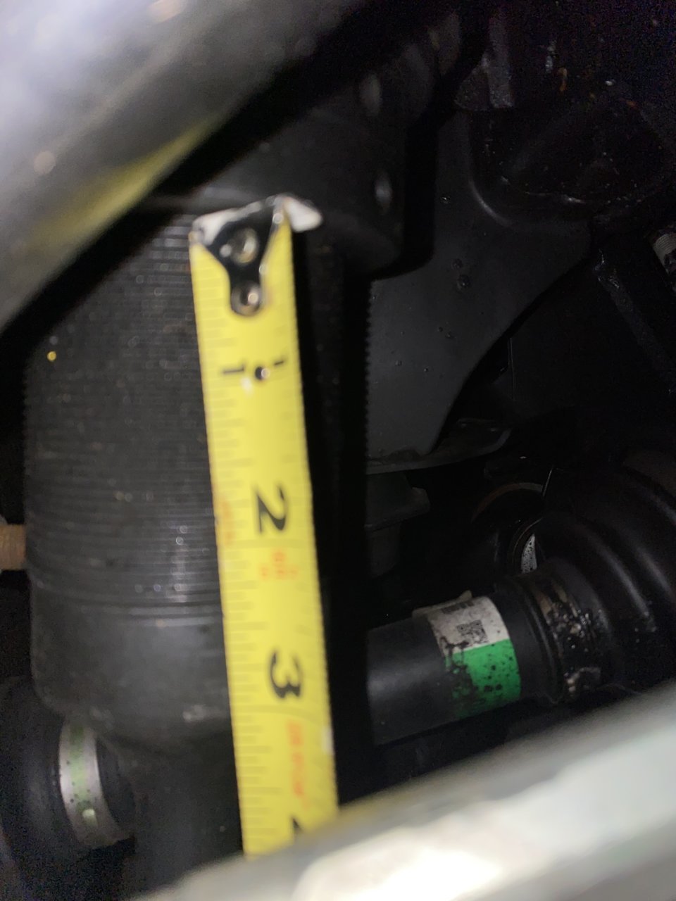

    I’m gonna say there is wayyy to much preload on those spring.
    Take a look at mine. Not an accurate reading but measure the threads and see.
  14. Dec 5, 2021 at 10:34 AM

    Meant this one too

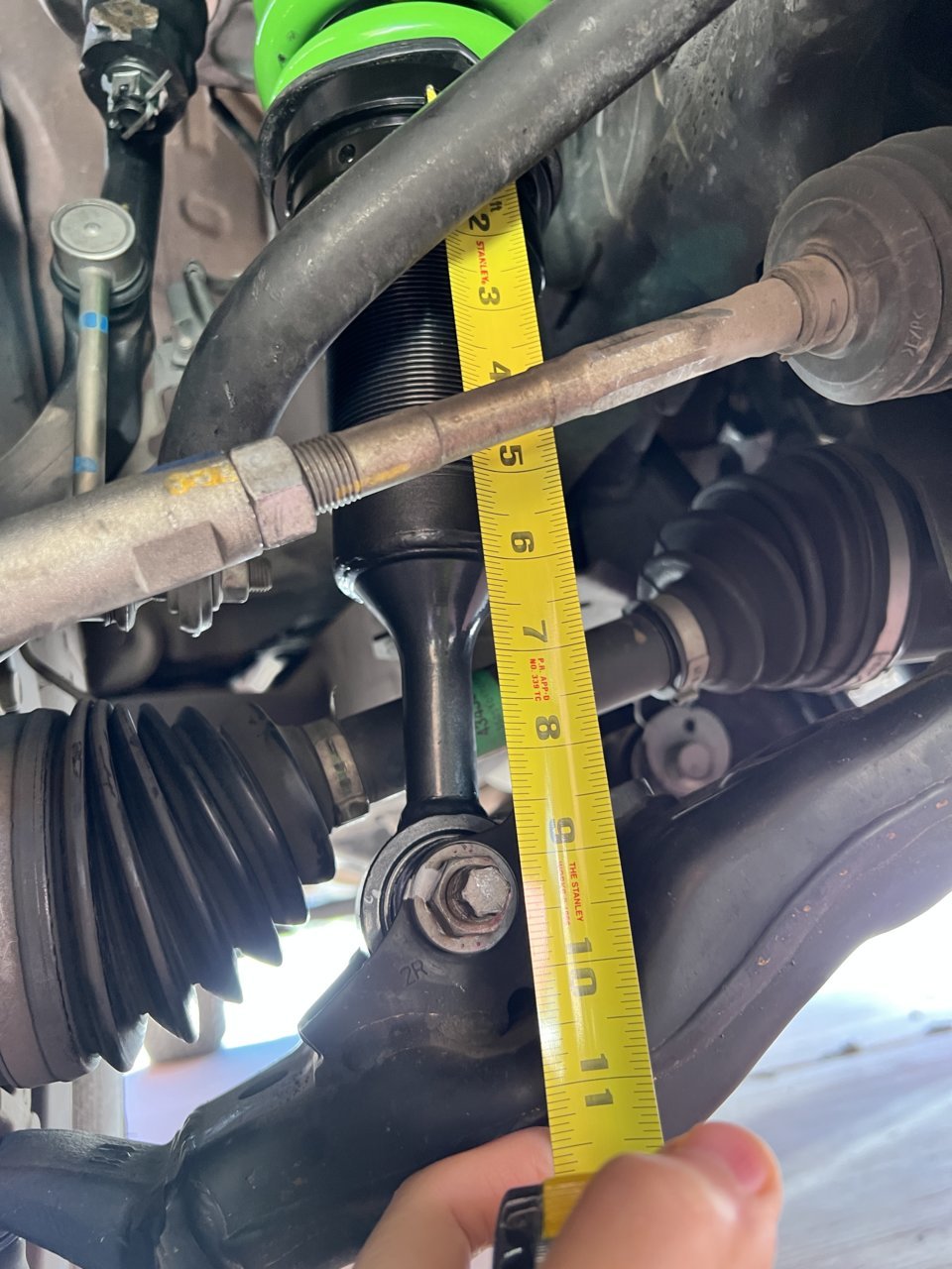

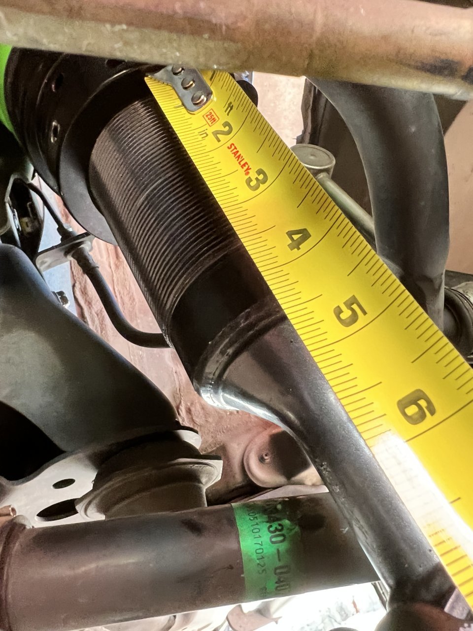

    I bet you have close to 3.5” of lift too, looking at your cv boots, unless your truck is on jacks right now.
    Front the sheet on the first page, you should have just over 9” from the spring seat to the middle of the bolt hole. Looks like yours measurement might have been from the bottom of the lock nut.

    Mine is like 3.5" compared to yours.. no not on a jack... thats how the installer gave it back to me... maybe that is the issue?

    9
    spring seat height seems to be 9 1/4. like the spec on the first post

    Just checking those measurements are from each side right? And the one looks like it’s closer to 10” from seat to bolt hole?

    yeah that was driver side, here is the passenger side.

    Well, I’m not sure, they looked like the was a lot of preload but with your measurements, it does not seem like that is the case. They both look similar in adjustment too.
