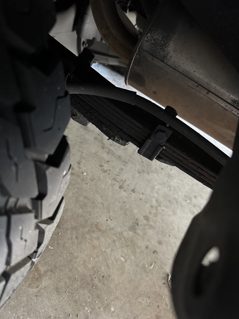

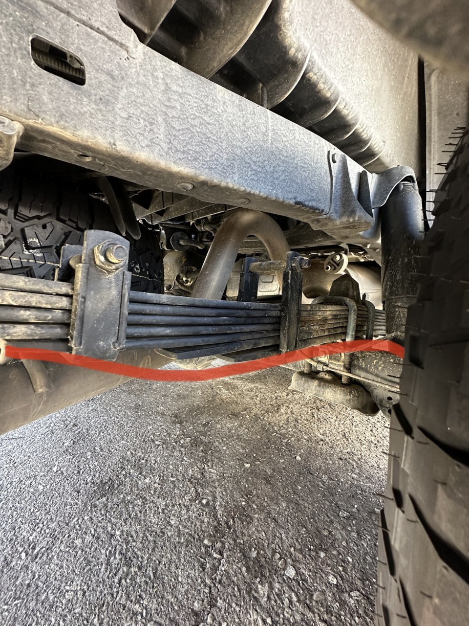

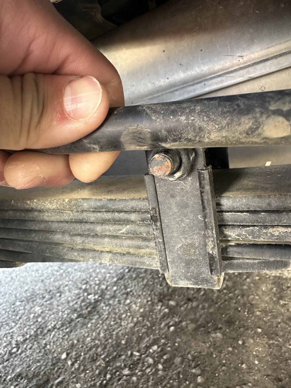

    I installed mine about a month and a week ago and put around just a short of 2000 miles.

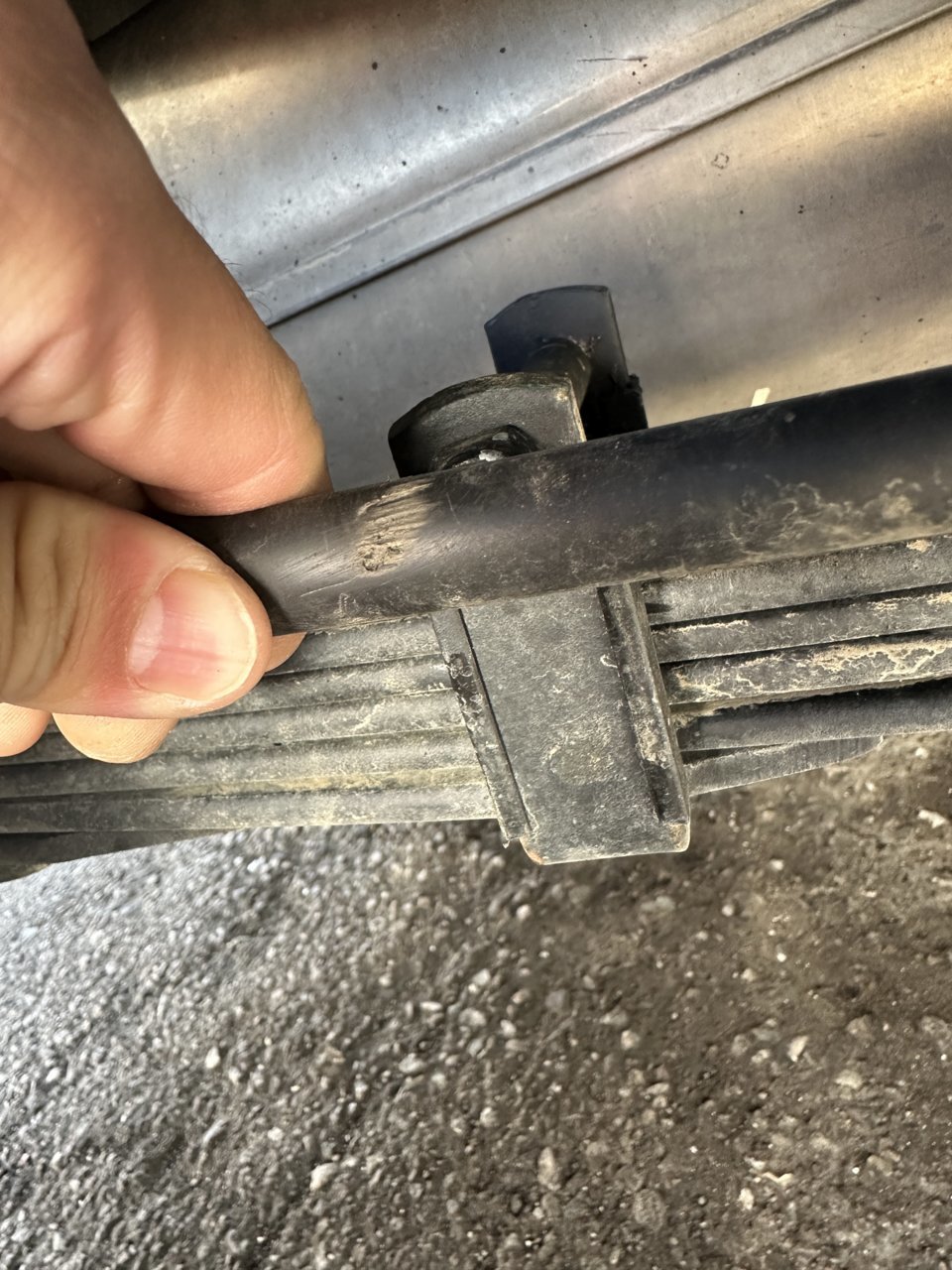

    I'm curious if anyone else has an issue with the brake cable line rubbing + leaf pack bolt rusting. Picture referenced. The cable is starting to show wear already and I'm getting concerned with more severe wear as I go offroad + winter approaches.

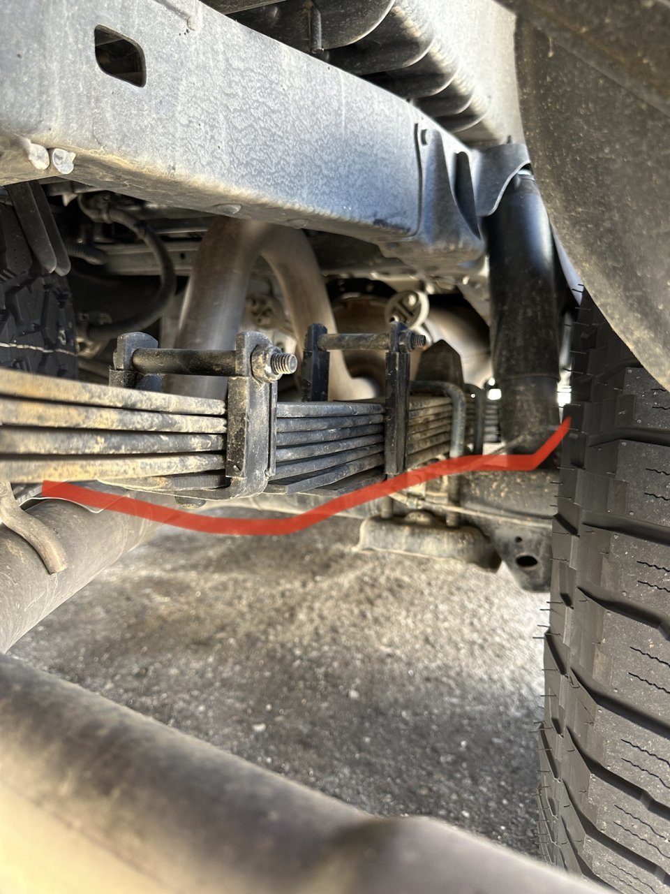

    And, this is how my leaf pack is sitting after the install + with my camper installed now (roughly 270lbs)
    Is this how it should sit normal? or Do I need to go with heavier/stiffer pack?
    I'm currently on Medium Load.
    KakaoTalk_Photo_2023-08-16-14-02-35 001.jpg KakaoTalk_Photo_2023-08-16-14-06-09 002.jpg

    I can’t say I’ve had those problems but maybe send IM those pics of the wavy springs.

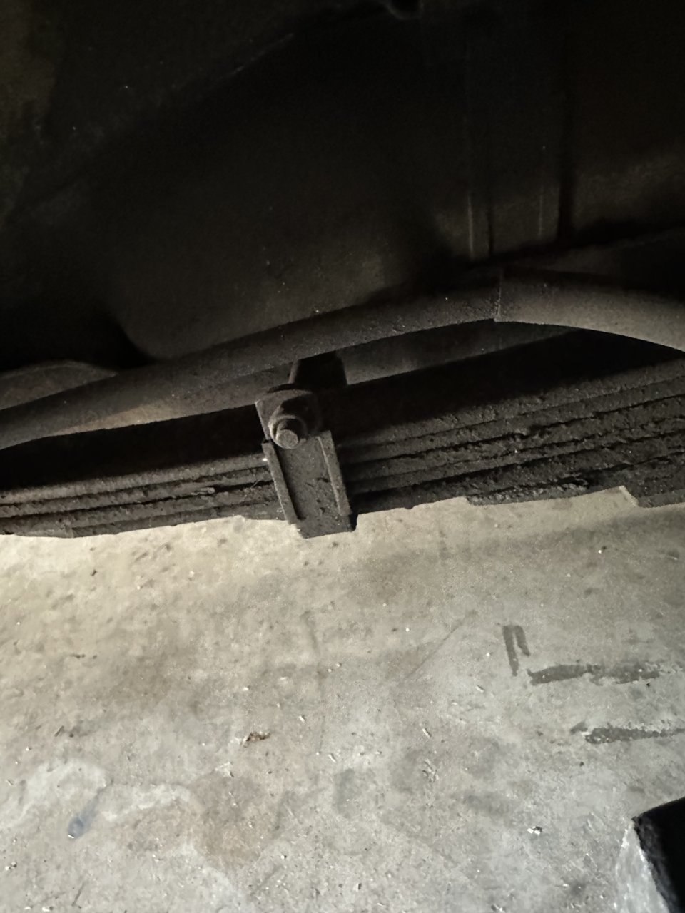

    the ebrake cable looks odd too- I’ve not had any rubbing. here mine

    Try the online chat thing on Monday. I’m surprised they’ve not gotten back.
    Does your e brake cable have the stand off?

    It looks like the bolt head is facing in a different direction from mine when I look at your first picture.
    I wonder if that's the cause of this wear..
