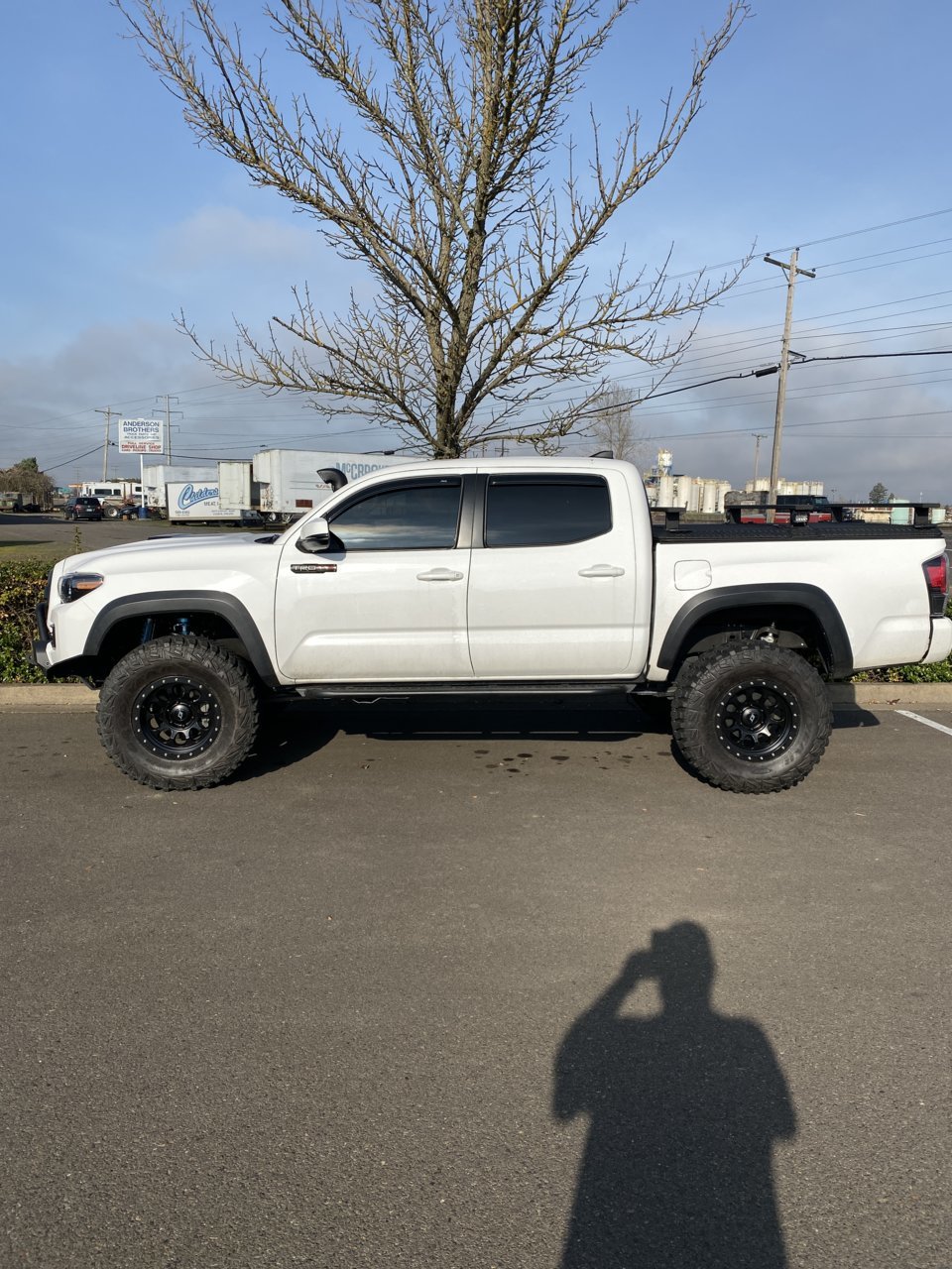

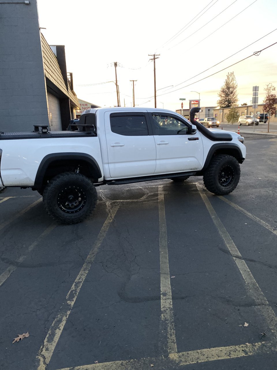

    I guess I should Post up my Truck in this thread too . I'm running 3" up front on Kings, custom 2.25" bump stops, SPC uca's, 4.3+ caster Cab mount is chopped all the way to the bolt's. Pinch weld is flattened outward fully undercoated and sealed, Dobinson snorkel. Total Chaos weld on spindle gussets . Trimmed the fender and the flare about 1.5" on the rear, Foam has been shaved down and then zip tied to the fender mount inside the door opening. Front bumper was trimmed for front approach clearance and I tucked the liners in the front . The Rears are lifted with OME hd 96 leafs along with 1" spacer and a 3degree shim. rear tundra King shocks go on this weekend. Limit straps and custom bump stops . 35/12.50/17 On 17x8.5 Ray 10's 4.3" back space -10mm offset. Yukon 5.29 gears. Full skids and slides, Hidden winch, high clearance rear Mobtown Bumper Is ordered, 17 weeks in the wait game. going on as soon as it get here. IMG_2669.jpgAOHD8378.jpgIMG_2662.jpg

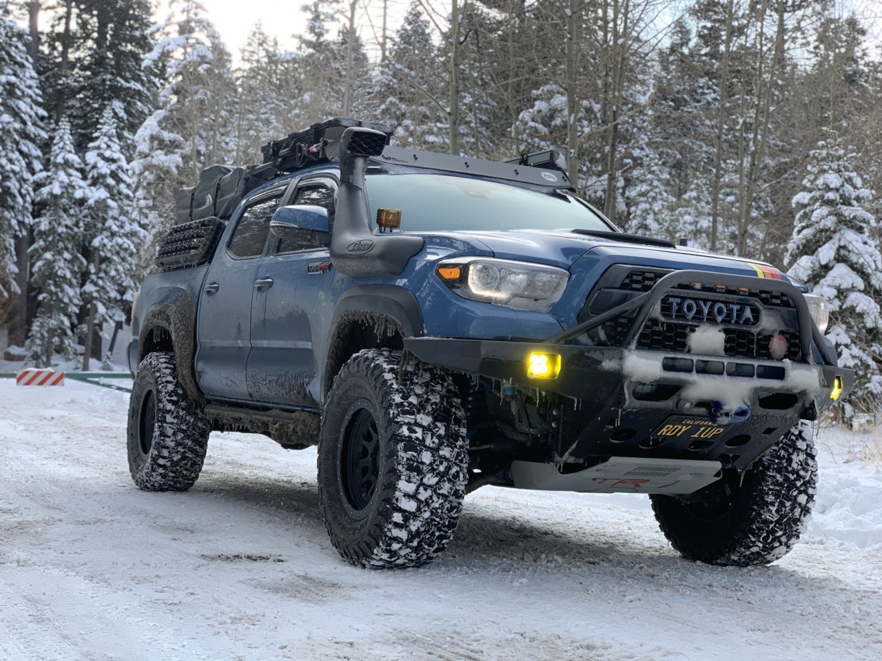

    Joined the club a week ago. No rubbing on pavement but definitely offroading. Fender trimming in the works.ADA43CD1-6993-44D6-B162-14AA1B86CA4B.jpg 79DCBD58-88E3-4DEC-9BD1-C68F459CEB13.jpg

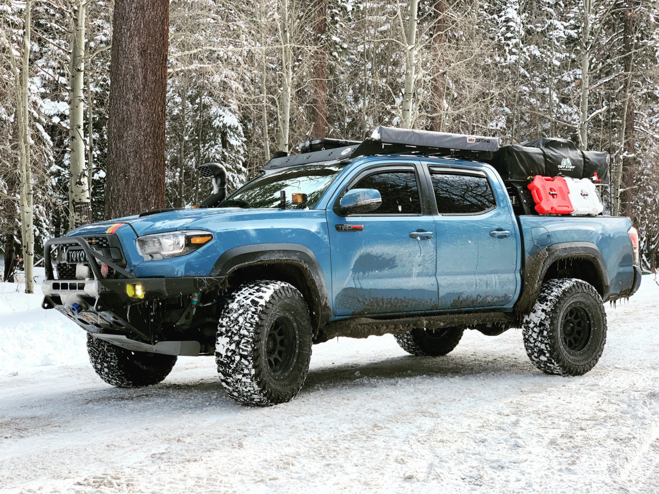

    Changed my setup a little. Softtopper is gone, replaced by a Leer. Also I have a cab mount relocation waiting to be installed since Im still rubbing like a mofo with only 2" of lift. Still wheels fine, just noisy. Since people will ask instead of searching...
    OME885s, 5100s on the second notch from the bottom, Dirt King UCAs, Wheelers offroad superbumps, u-bolt flipkit, headstrong 3 leaf add-a-leaf with overload in but cut down to about 18" long, 17x8.5 -10 SCS Ray 10s. Lots of trimming and bashing of the fenders, CMC but it still rubs.
