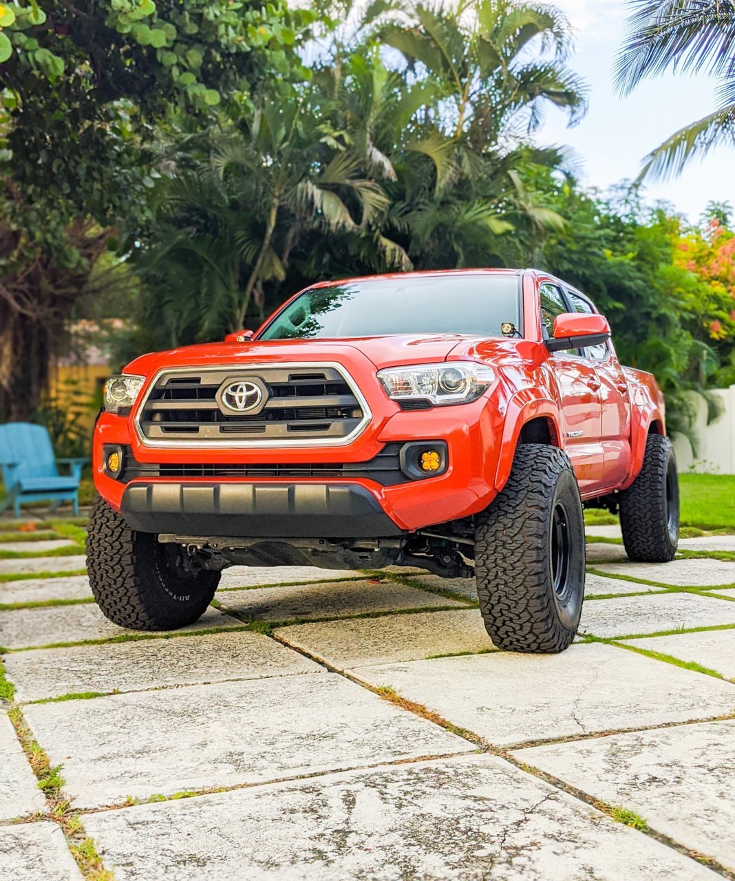

    Damn that looks siiiiiiick. I like the 35s on stock wheels. Looks like you have a ton of lift, maybe its the trimmed fender flares?

    How did you get 35s on stock wheels?

    Thanks! It has a 1” body lift on it right now that may or may not stay.
    Discount tire told me they couldn’t do it but Pep Boys didn’t seem to have a problem.

    A 315/75-16 will fit no problem. Quite a few people on here have done "35s" on stock offroad wheels. Stock suspension is a much bigger deal than stock wheels ha.

    whatre you doing to keep the mud out of the air intake now that you trimmed the fenders?

    lol, yeah until I finish trimming.
    Just taking it easy until my snorkel shows up.

    Ignored the recommended rim width range. Sketch balls. I would never air down.

    Why not?

    Why don't you show us where you found that its beyond the recommended range? Maxxis doesn't list one.
    Why wouldn't you air down? Can you provide a single example of an issue caused by a tire that was too wide for a wheel and had an issue when aired down? No because there isn't one. If anything, it will be worse when aired up because the tire may crown a little and wear down the center when driven on pavement most of the time. Off road the tire will actually hold a bead better and conform to obstacles better with more sidewall flex. Head over to a site like pirate4x4 where people actually wheel their rigs and you will find all sorts of wide tires on narrow wheels. Back to overlanding for you with your rig that is over its GVWR but Im sure its safe.
