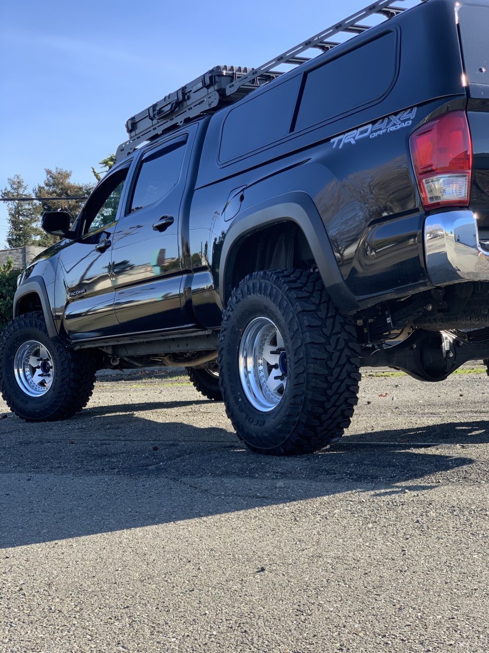

    Sup fellas Just joined you guys on 3 and 35s well 34.8 to be specific here’s some photos.

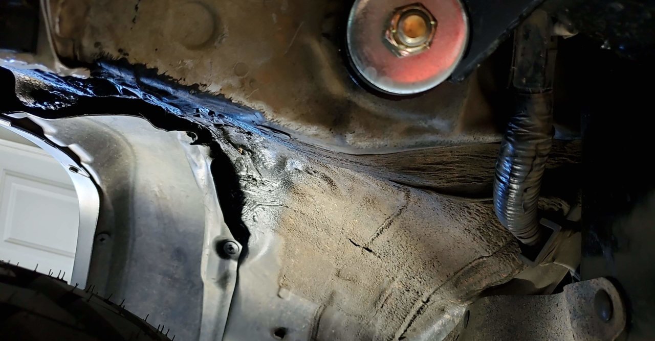

    I removed my coils and cycled my suspension and man, I didn't like what I seen. I'm really pushing against the metal lining in front of my cmr. Tried to hammer it in but no go. Really don't want to tub. Any suggestions? I'm getting my springs swapped right now to add a bit more hieght. Hopefully this helps a bit.received_421520519068066.jpg

    Easy fix. Pull your shock. Cycle suspension. See where you're at at full bump. Space out bump to keep from rubbing.
    I adjusted bump to keep from tubbing but will switch to 37s and tub soon

    you make it sound so simple lol it's hitting hard before full stuff20210202_102034.jpg 20210202_101958.jpg

    Can you add more caster?

    going to try lifting it to a full 3 in lift and add diff drop possibly.

    What’s your cam bolt
    Position?

    I'll try tomorrow morning but I believe I was already 6 plus caster to fit 33 no rubbing with no cutting
