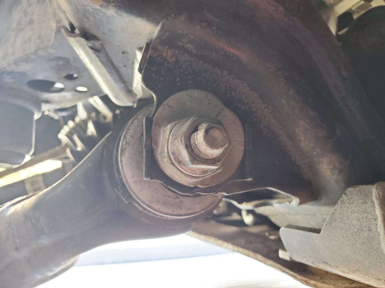

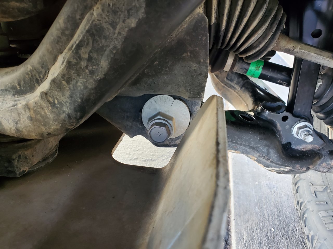

    I believe you have a lot of caster to gain at the bottom. You want your cam bolt to be outward and the marking facing the frame. Opposite on the front cam bolt.
    socalexpeditions and Rockefelluh like this.

    yup, need a pic of the front bolt too.
    Maybe you already mentioned but what UCAs you running?
    socalexpeditions likes this.

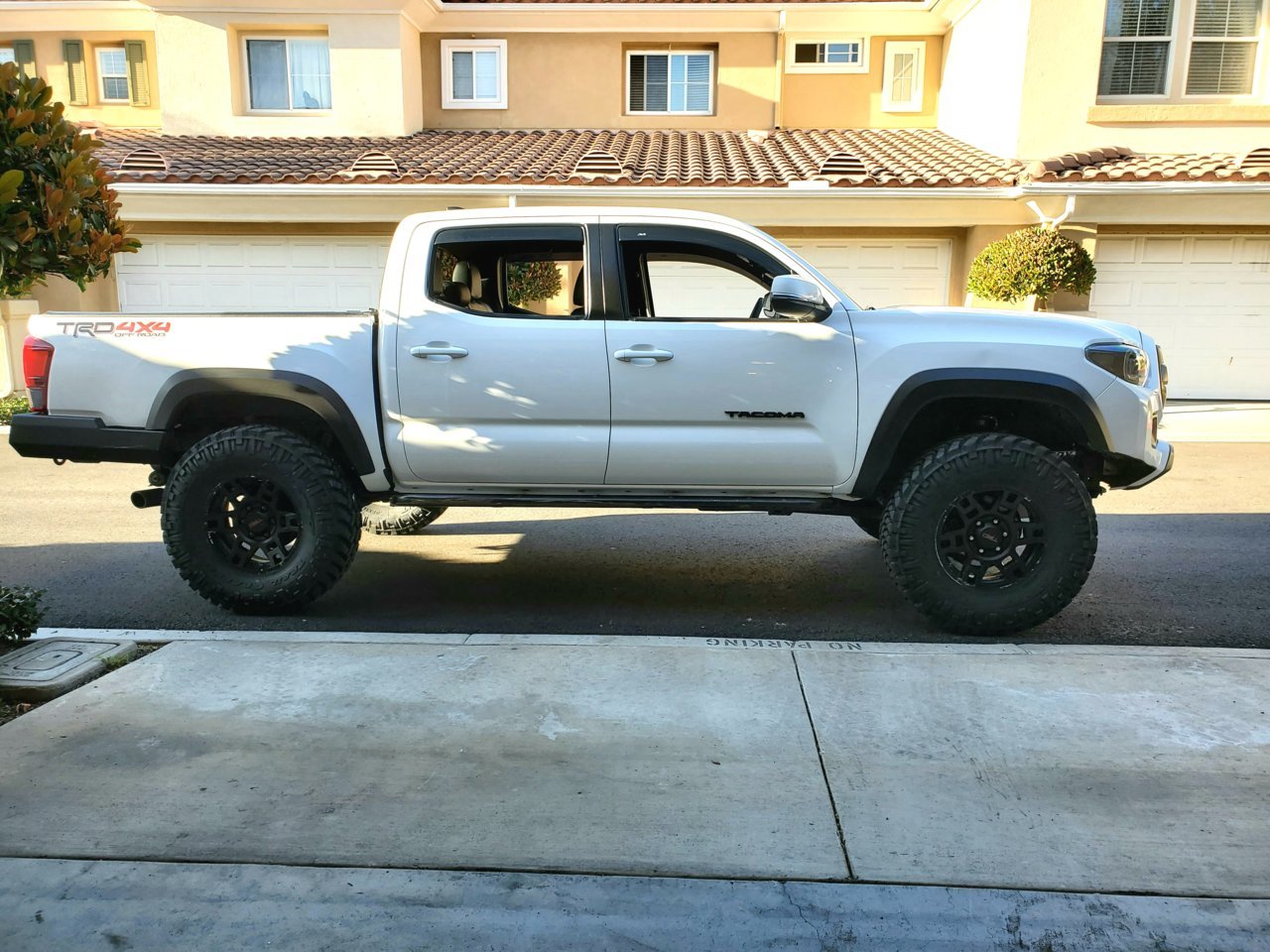

    I added the 650x14 in coils and am now sitting at 23.5 in hub to fender. I got exactly an extra inch of hieght putting me at 2.5 in over stock off road trim hieght. I'm going to see if the stiffer coils allows a bit more clearance. Still going to have to figure out alignment cause the main problem will still be here when I stuff my tires off road.

    CAMS should be outward in the front and inward in the rear so you should gain a bit.

    Alignment is key. Rear cam out, front cam in, only touch front cam. SPC arms help with camber since camber/caster play off eachother. I’m not sure what you have but I’ve seen a ton of setups work!

    I have fox 2.5 with dsc and camburg uniballs. From what everyone has said I should be able to squeeze out a bit more caster. I have to lower my ride height tomorrow (I'm up to a true 3 in lift after swapping springs) to stop topping out, then try to dial in alignment to hopefully avoid tubbing the rear area. I'll trim up my fenders after all that's taken care of. I knew I had to put in some work to do this but I feel like I'm hitting every problem there is lol. I will however see this through and do it properly, I really want to get back to wheeling.

    but I can't lie,, she does look pretty good so far
