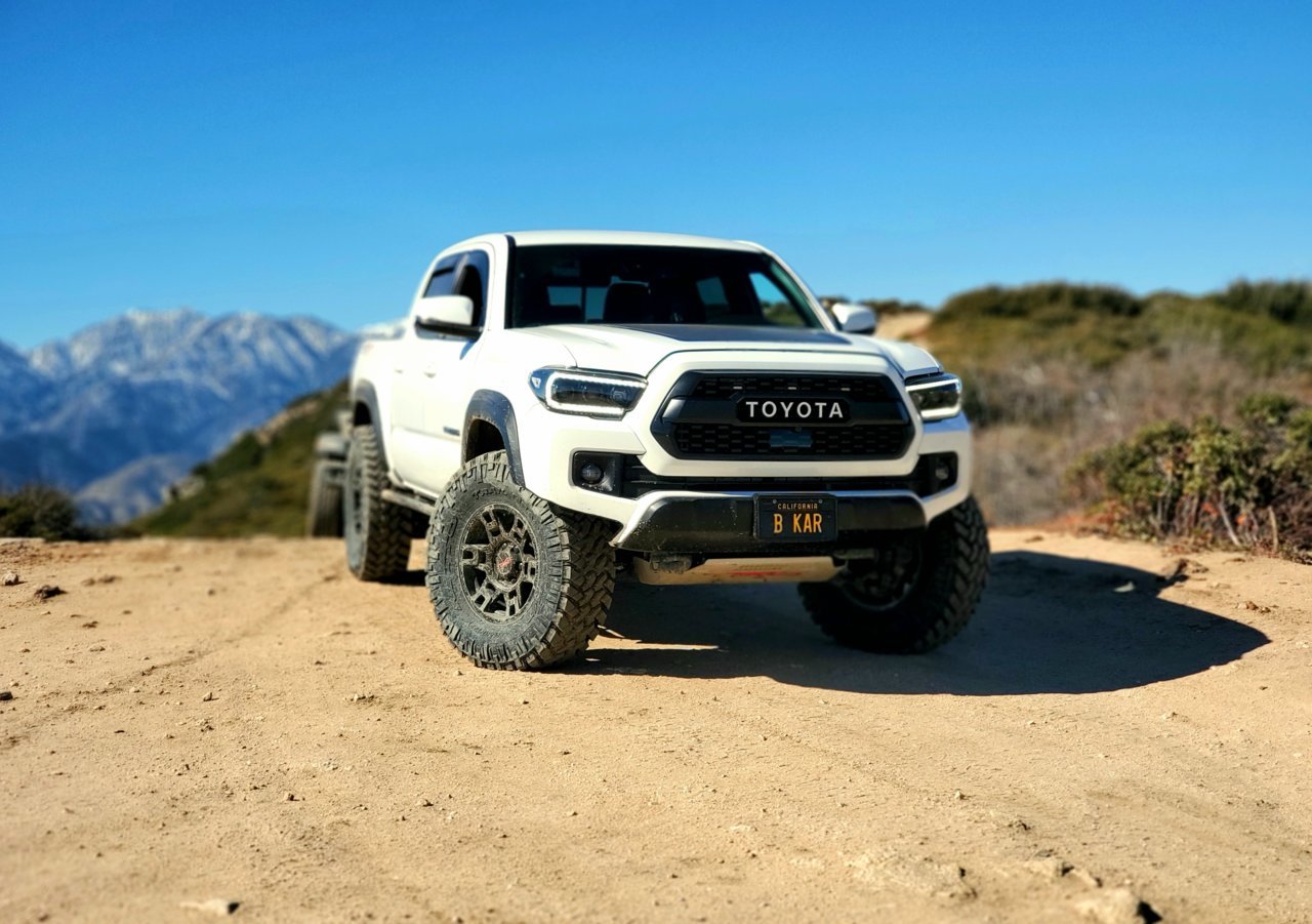

    You should be able to - Caster helps with clearance, but isn't everything. Pushing that rear cam out will do a lot more than adding 4 degrees of caster. But balancing both out and keeping camber in mind too will work! I am 3.5 drivers, 4.2 passenger, 0.0 camber L & R. Regular toe-in. I have SPC's on position D, camber adjusted at home.

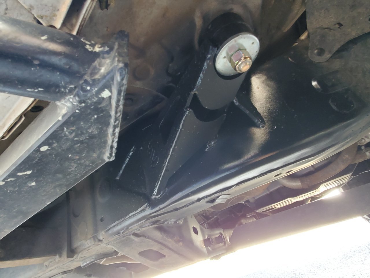

    Alpine offroad offers a cab mount relocation kit that significantly improves your clearance. A bit more involved to install but it's a really good option.

    nice kit but I like Lil B's a bit more. It has more contact points to the frame. I installed this before the tires went on.20210130_123553.jpg

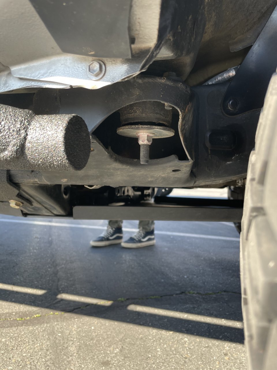

    I’m at maybe 2.5 in the front
    D53053E9-1E23-4094-A7AF-17EB9DD8392E.jpg AFB9DF91-46CE-44C9-8AEF-0405B4B6F54B.jpg

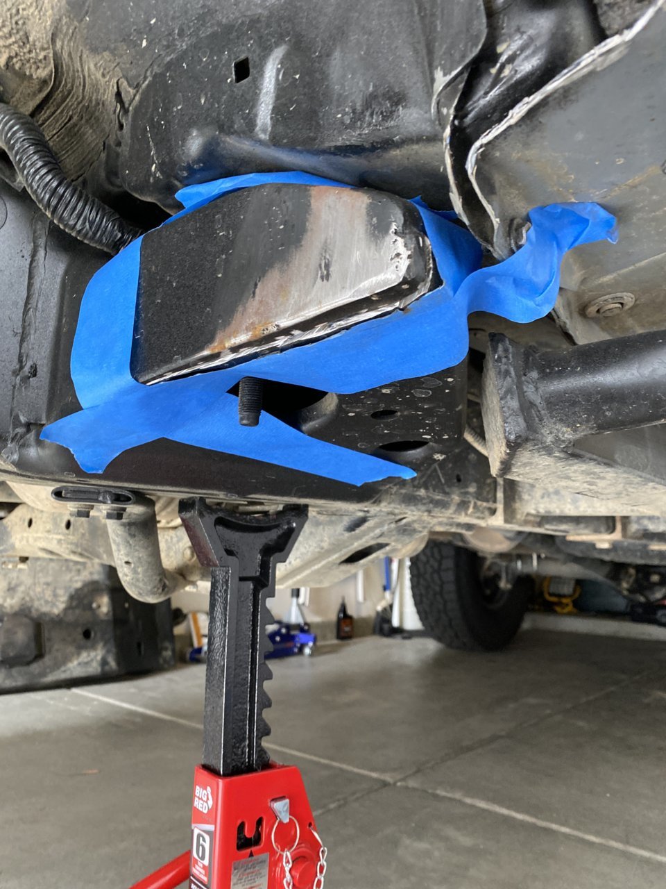

    Well fuck.
    I had an appointment this Friday to get my CMC done but with that being said, I know I could get up in there with a cutoff wheel...hmmmmm

    If you’ve cut metal with a cutoff wheel you can do it. Took me about 1.5 hours each side with the grinder. So maybe plan just plan on doing 1 on the first day and see.
    Definitely sand and paint after.
