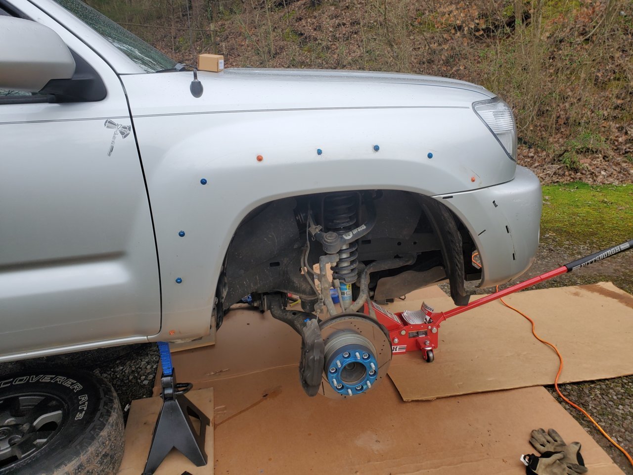

    I got this one which I put on the actual sheet metal I cut.
    Trim-Lok Edge Trim – Fits 1/16” Edge, 3/8” Leg Length, 25’ Length, Black, Pebble Texture – Flexible PVC Edge Protector for Sharp/Rough Surfaces, Easy to Install https://www.amazon.com/dp/B00NL45NQ...abc_CBR2VPKV6D9P5396CD7K?_encoding=UTF8&psc=1
    If I decide to put some on the actual fender flare I’ll probably order some meant to fit a 1/8 inch edge. I don’t think the one I ordered would fit the plastic well.

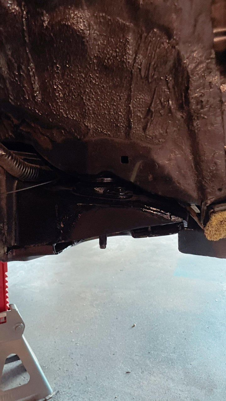

    Got my pinchweld done this afternoon.
    Probably have Discount tire mount the tires to the wheels tomorrow.
    CMC Friday then I'll puttem on and see where and how much fender I need to trim.

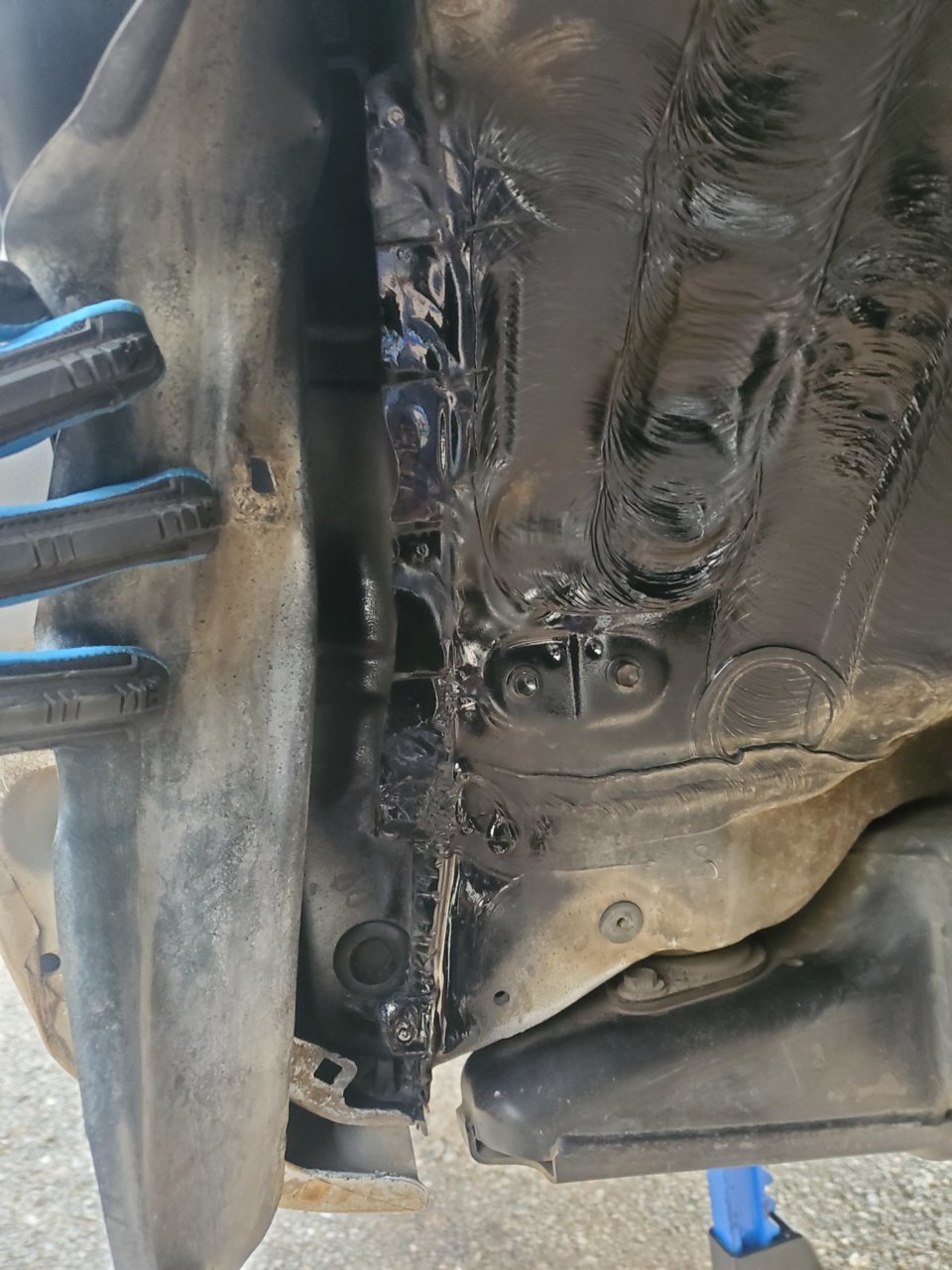

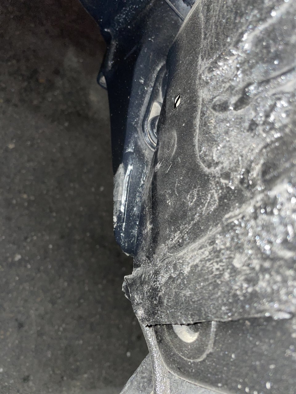

    I trimmed wayyy more of the cab mount today :sawzall:Still wasn’t enough :mad:
    It still rubs as you can see in the picture below. I wonder if my 1.25 spacers are the problem. The wheels are 7.5 wide with 4.5 back spacing. Maybe if I did like a 3/4 spacer instead it’d be better. :annoyed:

    Yeah spacers create issues right there. I’ve been fighting that same issue on my setup up until recently when I did the whole jd fab lower subframe setup. That’s the extreme option but if you know someone who can weld nice it’s solid

    to me it just looks like you're trimming the wrong area.
    trim the rubbing area, not the whole area underneath where it isnt rubbing!

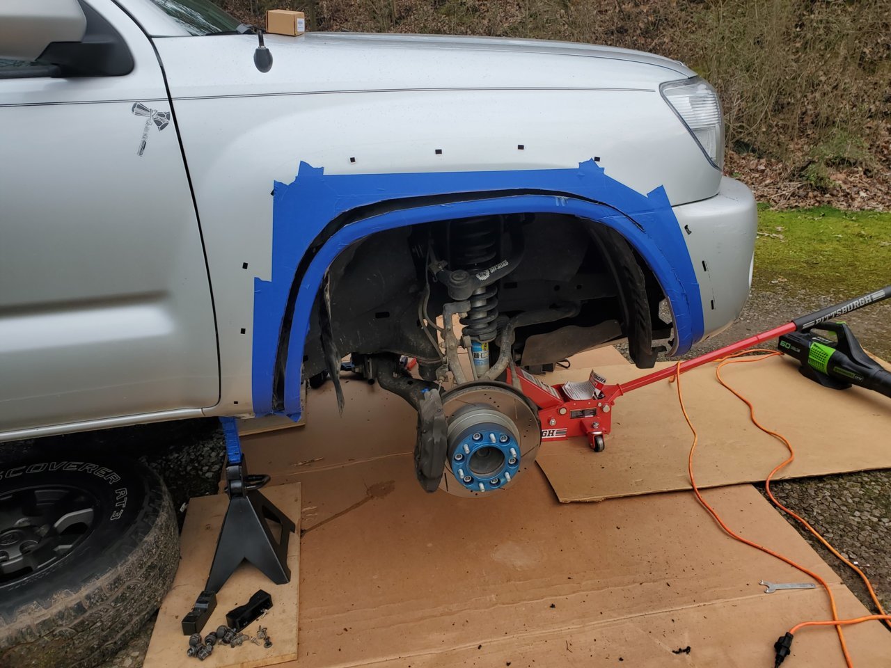

    Make way bitchez! Ma 35's need room to breave.
    Cut 1 1/2" inches off, I hope that was enough?
    Getting Lib's Cab relocate done on Friday.
    Shop labor is only $75 an hour and these guys are legit so it shouldn't be more than $225+tax
    Still gotta trim and reinstall the flares but all the "necessary" work on my part is done.
    Probably gonna trim the rear too but at least I can get them put on this weekend and not have a major flop like this past friday where I went for a CMC and to get them put on but they wouldn't clear the front fender flares.
