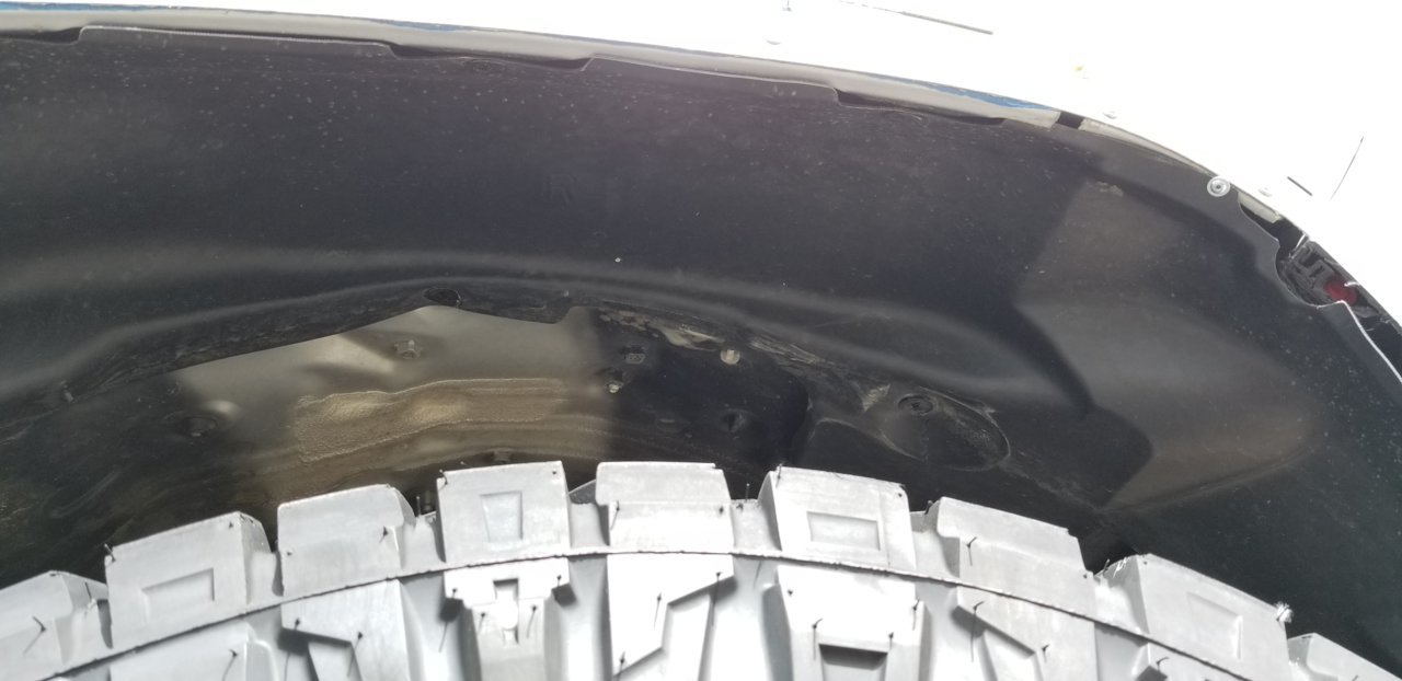

    Some shots of the trial run with the 35's to check clearance.

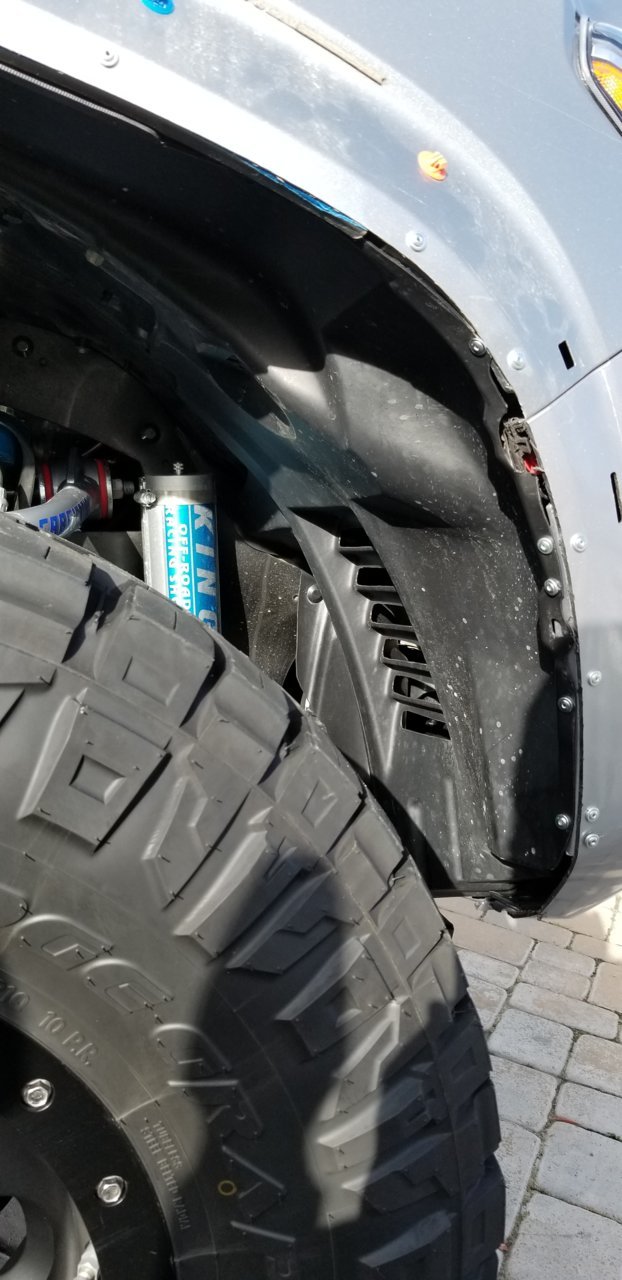

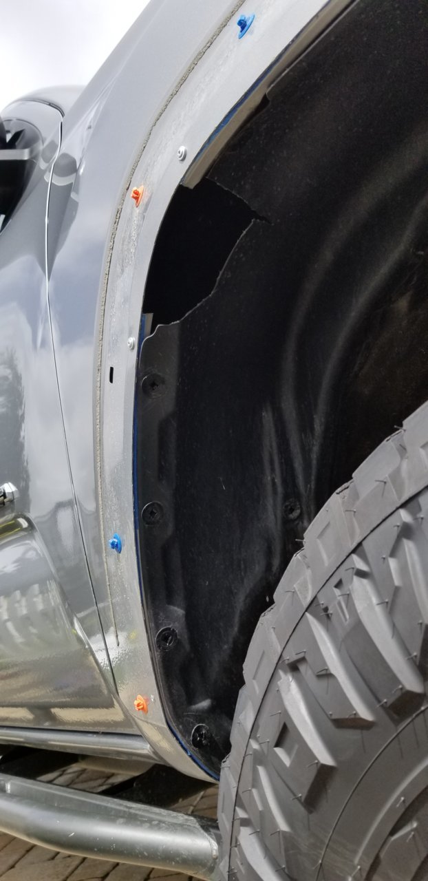

    As discussed previously in this thread, what could be done with the finder liners and wheel well plastic liner. Here is my solution. I used the piece of fender that was cut(about 1.25" in my case) and riveted them to the interior of fender. I did this because those trimmed fender pieces had little tabs that held the plastic locks. It turned out OK. I did this because little breather vent under passenger side was exposed and I didn't wanted to get the snorkel.

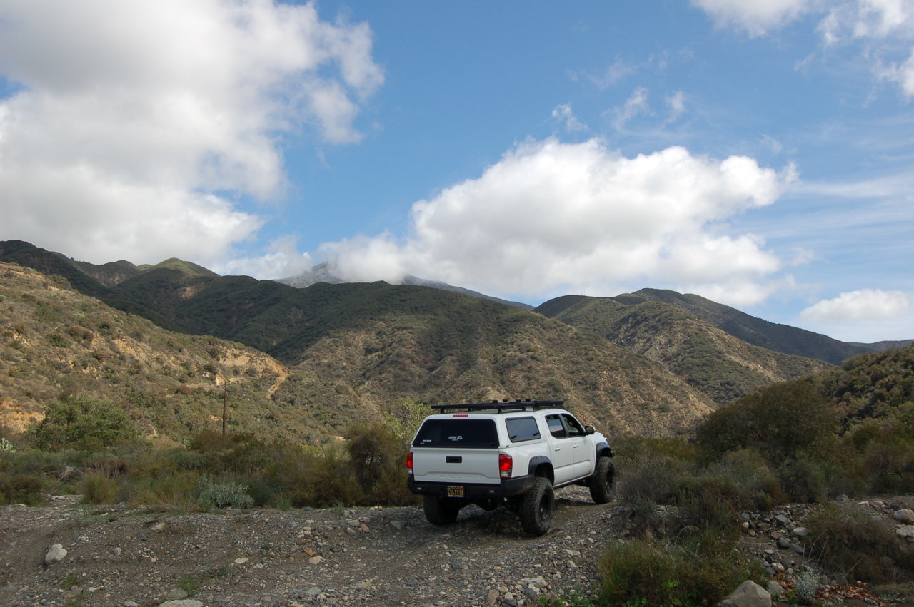

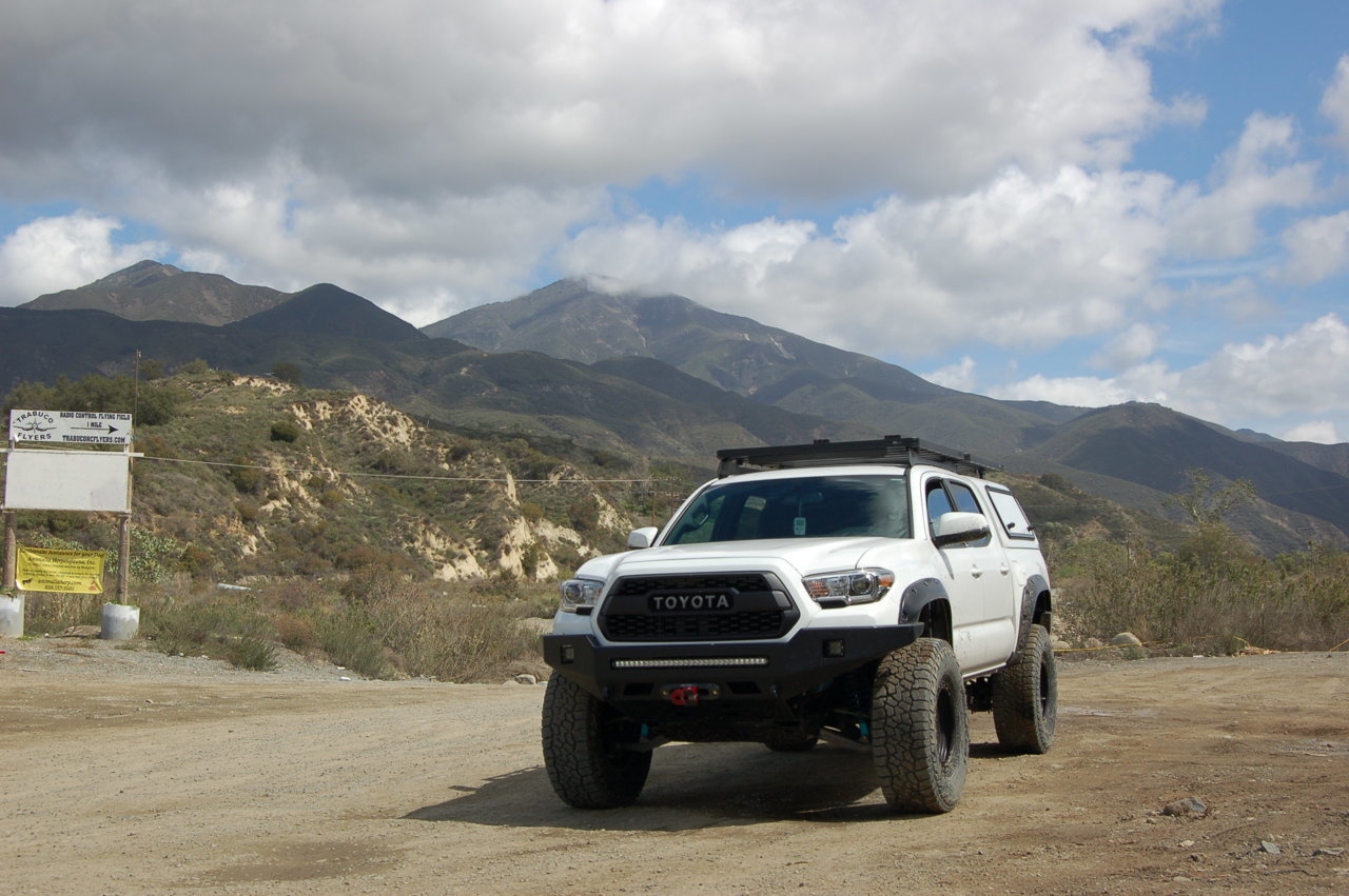

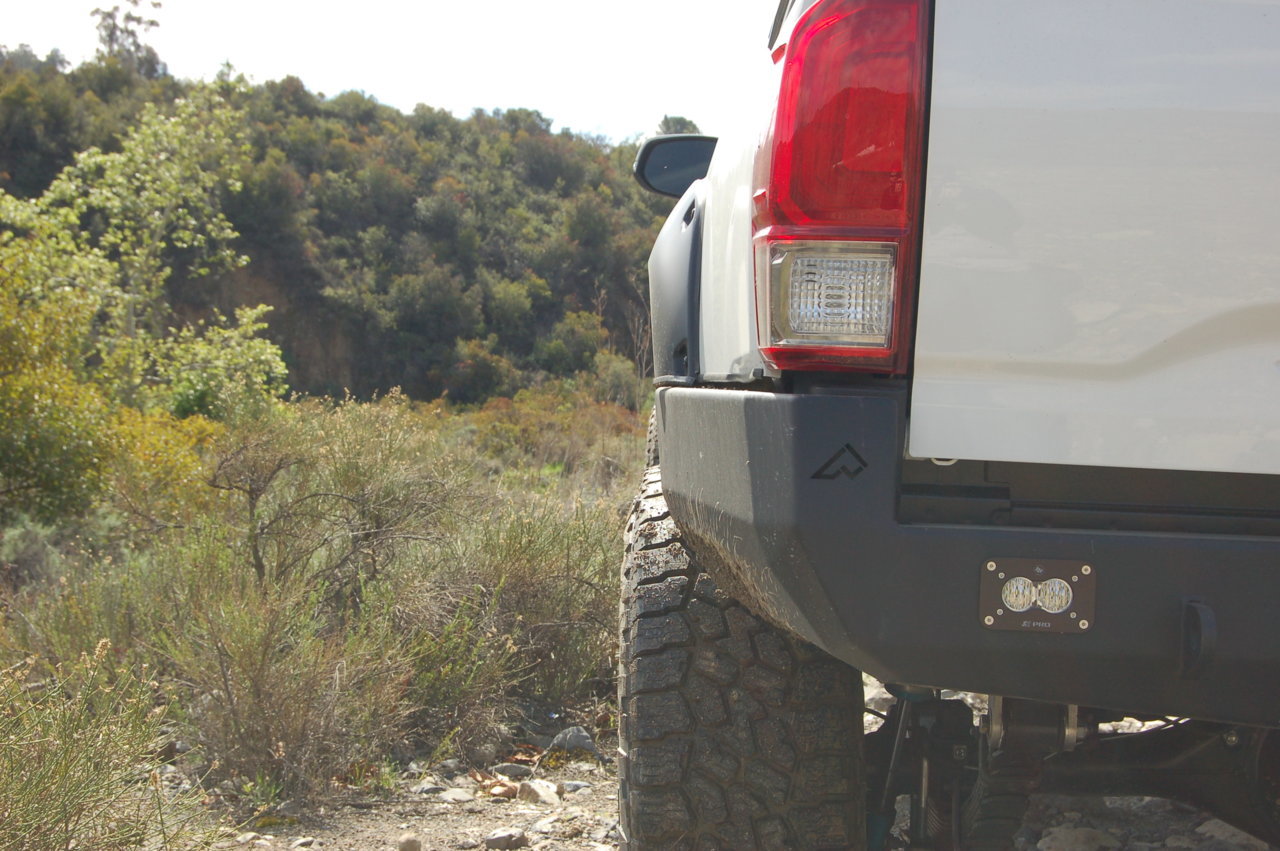

    Who's the Rear and front bumper by?
  8. Jun 15, 2018 at 9:13 PM
    #148
    90yota
    90yota Instagram: 90_yota
    Apr 13, 2016
    #184183
    5,417
    Dixon, CA/Truckee,CA
    88 T4R / 15 F350
    Stock....ish
    SOS
    AHEE_adv[QUOTED] likes this.
  9. Jun 15, 2018 at 9:13 PM
    #149
    MESO
    MESO Major Modder Vendor
    Feb 16, 2015
    #148809
    16,292
    State of Jefferson
    2016 DCLB TRD HELLCAT SWAP
    Front SOS. Rear CBI

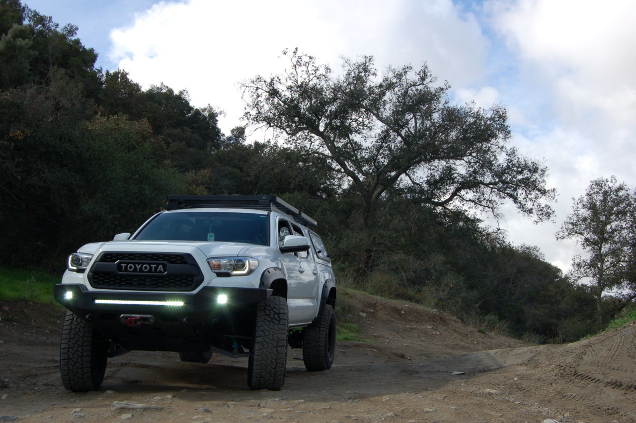

    How do you have no rub with no trimming? This is an anomaly.
    jq1604 likes this.
  13. Jun 15, 2018 at 10:11 PM
    #153
    Catfish21
    Catfish21 Well-Known Member
    Dec 18, 2015
    #172515
    2,047
    Stockton, Ca.
    Trd off road 4th Gen
    how much lift (did/do) you have?
  14. Jun 16, 2018 at 2:32 AM
    #154
    Red18Taco707
    Red18Taco707 Well-Known Member
    May 29, 2018
    #254905
    1,123
    Richi
    Nor Cal
    Red 18 TRD POOR
    Great... now I have to throw away my mod list and make a new one :annoyed:
    I want it all:pout:
    H3llRid3r likes this.
  15. Jun 16, 2018 at 5:57 AM
    #155
    Trident904
    Trident904 Touching Drum Sets
    Jun 13, 2014
    #131875
    5,089
    Brian
    Treasure Coast, Florida
    17 4Runner TRD OR
    Modded it so much it turned into a 4Runner
    Proper suspension and alignment. True 3” measured lift, not the 2” over stock that everyone claims is 3”. Lots of cutting on the cab mount. Fenders didn’t need trimming at all.

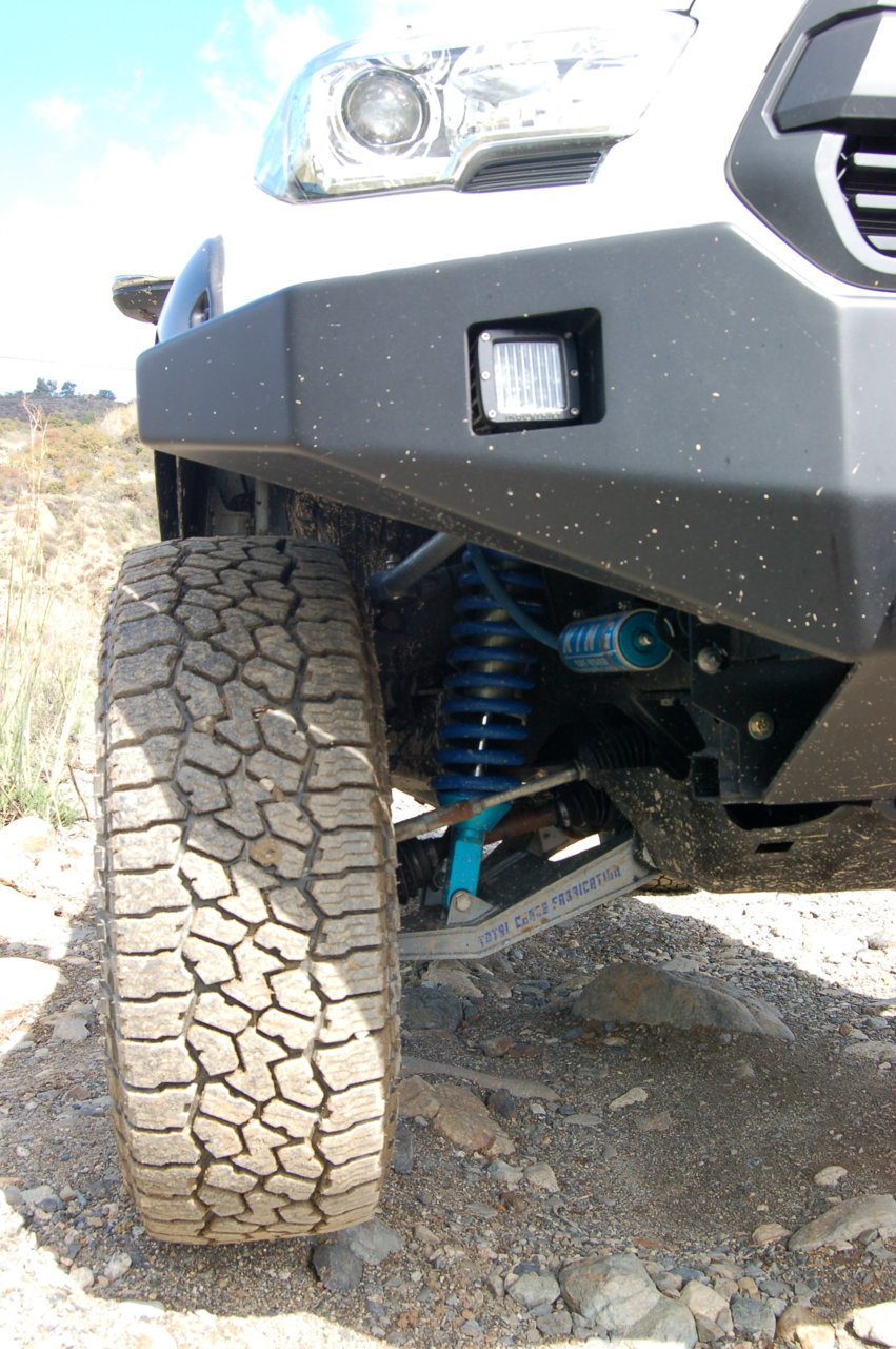

    What wheels are those? F5?
  19. Jun 16, 2018 at 10:32 AM
    #159
    Snatch Me
    Snatch Me Yeehaw
    May 14, 2018
    #253416
    160
    PBC FL
    Cement TRD OR 4x4 DCSB
    I have to say I really hate your truck.
    I say that 100% out of jealousy.
    Sorry if you already posted this and I didn’t see it, what is the width/offset of your wheels. And what is the listed tire size you are running(35x12.5 or 305 or 315s or whatever...)?
    Thank you kindly.
    TheTacoma likes this.
  20. Jun 16, 2018 at 11:21 AM
    #160
    JoeCOVA
    JoeCOVA Well-Known Member
    Nov 15, 2016
    #202463
    9,657
    Joe
    Colorado Springs
    Ford F350, Lexus RX450h, FZJ80, Jeep YJ, Jeep LJ
    Found his build thread
    Wheels / Tires -
    SCS F5's 16x8 3.5bs
    35s (315/75R16) Firestone Destination MT2
