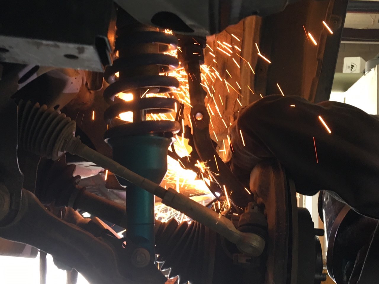

  11. Jun 24, 2018 at 10:58 AM
    #171
    JoeCOVA
    JoeCOVA Well-Known Member
    Nov 15, 2016
    #202463
    9,656
    Joe
    Colorado Springs
    Ford F350, Lexus RX450h, FZJ80, Jeep YJ, Jeep LJ

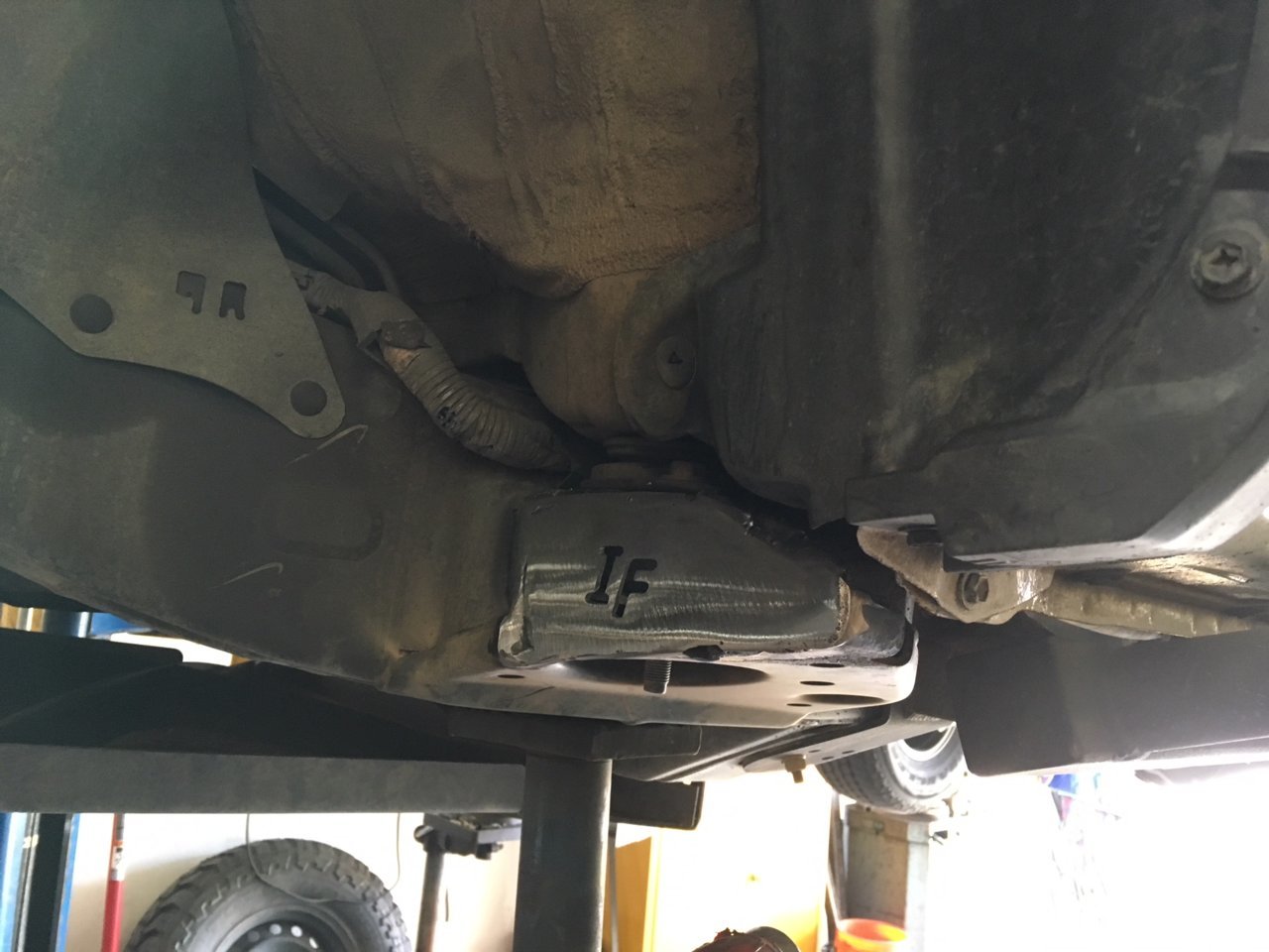

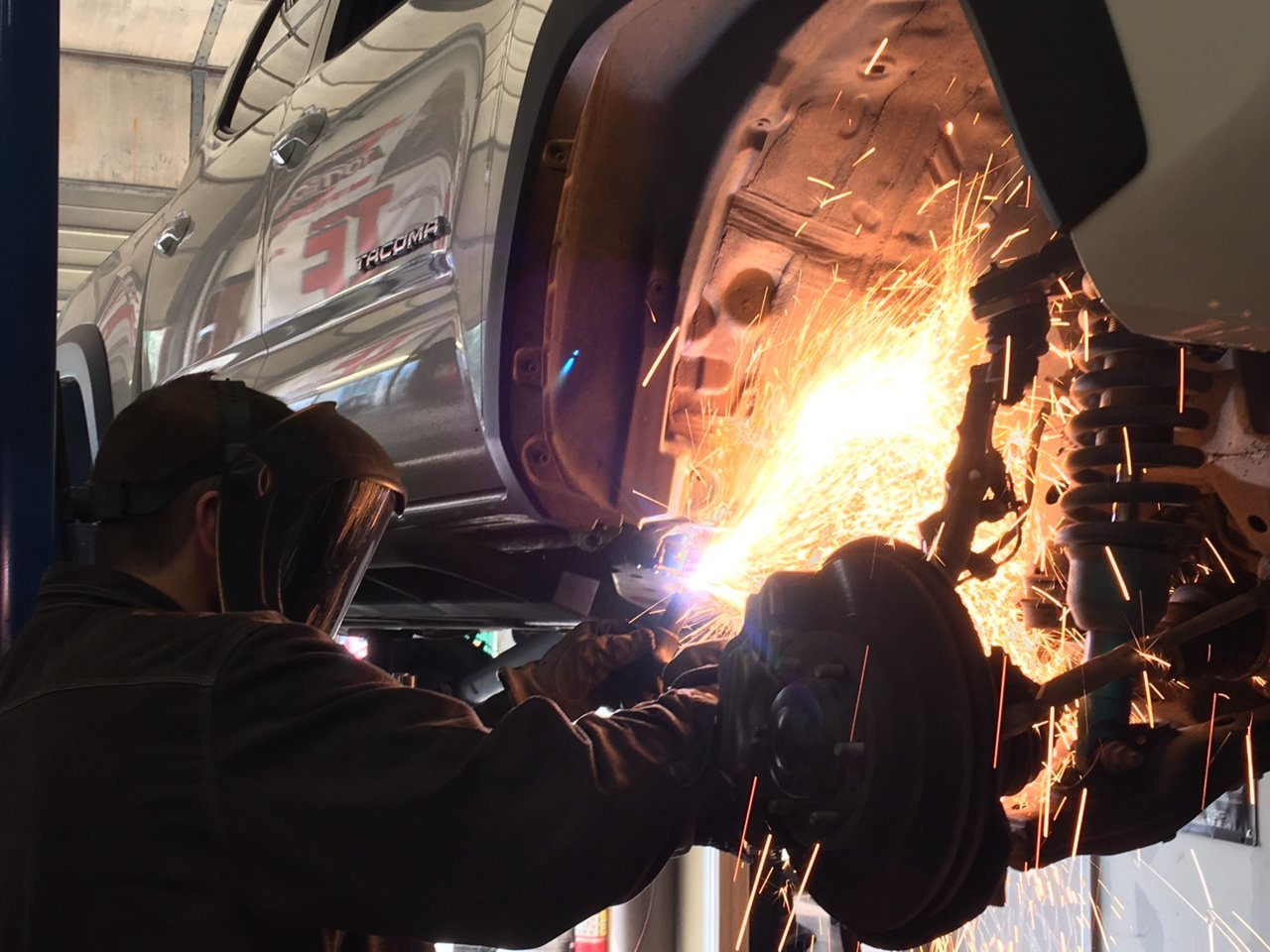

    Corey from @InSainFab hooked me up. Did the CMC, flattened the pinch weld, cut the inside fender liner and moved and remolded with torch..awesome guy and awesome work.
    Relaxo, JDSmith, Age315 and 3 others like this.

    You have after pics of the cmc?

    What do you mean by lots of cutting on the cmc? Do you have pics of the cmc? My 315s still rub after the cmc

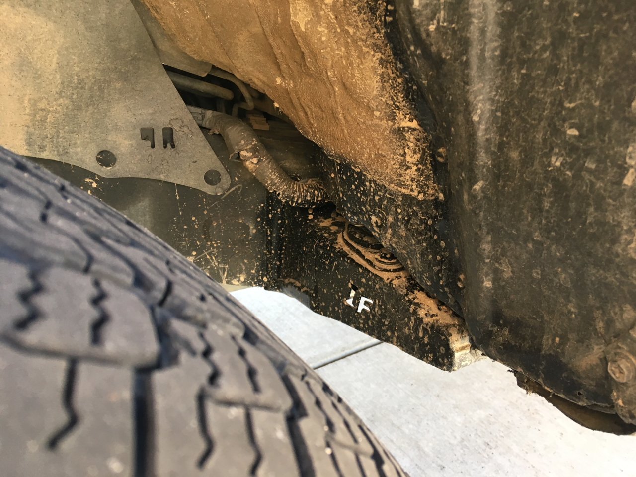

    Once it was done I completely forgot to take photos. Too busy BSing with corey.
    I didnt really measure before but all said and done gave me another inch or so.
    J2L4U, EdgarDLP[QUOTED] and H3llRid3r like this.

    Cut the cab mount as far as it can be cut and don’t plate it.

    If you don't plate the cmc, make sure it doesn't have sharp edges. Otherwise, it will mess up your tire big time. Don't ask how I know.

    It will not affect structural rigidity at all. The plates are purely vanity.

    I did plate it. At first I didn't, but then it was messing up my tire. So, I end up plating it. I'm glad I did because it still rubs the plate and doesn't affect the tire. . Also, you can only chop off the cab mount so far. Unless you don't care about that little hole for changing the mount. In that case you will never be able to replace the mount.
