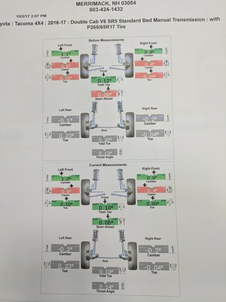

    Knowledgeable commentary welcome, I need to go back to the guys who did the alignment and have them clean it up.

    Yep,all they did was set the toe.

    Set an appt for Thursday to have them wrap up. With all the conversation prior what should I look for on the caster when they are done? Installed a OME lift kit that is ~2.5" with oem UCA.

    Yup, lazy tech toe&go alignment. Fuckin assholes...

    Can probably get caster of around 2 with OEM UCAs

    Aim for as much as you can get without sacrificing camber too much. I'm at 1.56* of caster and it's not too bad.
