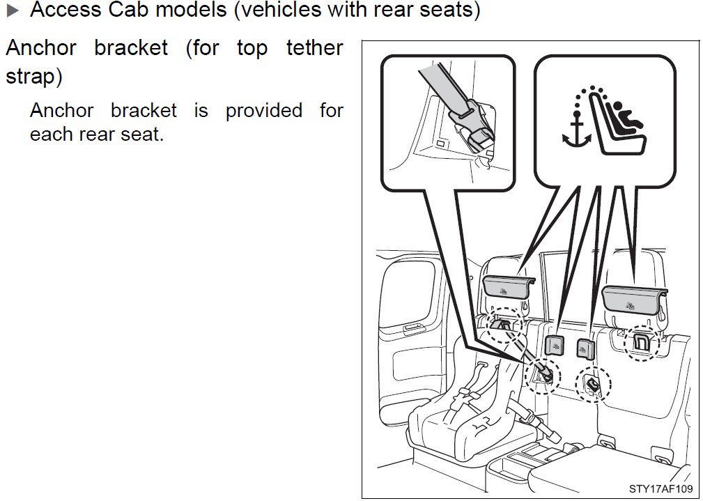

    While I doubt a police officer will know nearly enough about car seat safety to check, car seats are tested against manufacturer built cars - not after market, in your garage DIY (as clean as this looks)
    I know people want the trucks and cars they want, but putting children’s safety at risk isn’t worth it.
    All forward facing seats need a top tether anchor, which I’m not sure the access cab has even for the two outboard seats it has. The only exception is on an airplane.
    Have I read every single car seat manual? No, but please don’t do this. And don’t give me the “when I had kids we didn’t even use car seats” excuse. Seat belts didn’t exist for the longest time either. Also cures for diseases!

    I stand corrected. But that middle seat he’s got doesn’t have one from the factory which is the culprit and why I went on my soapbox.

    Indeed. Post is 2 yo, It's only a guess how he attached all 3 seats "properly".

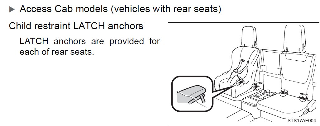

    So two seats, legal, maybe. As I mentioned, the door sticker states the maximum occupancy of the vehicle. If the door sticker only says 2 because of the utility package option, you COULD get a ticket, insurance COULD deny your claim if your kid is maimed, and family COULD sue you for wrongful death or any other thing that sue happy folks like to come up with.
    Three seats, probably not legal, fully not safe since seats are supposed to use the OEM LATCH systems.

    You could just get the regular access cab that retains the rear seating and wall anchors to attach to, and just remove the lower seat platform if you aren’t running the kids seats and need the space. 3 bolts and each seat is out. Sure it’s a little more expensive but you have all the seat provisions in place and not need to worry about if a diy setup is going to hold in a collision, nor worry about the legalities.
