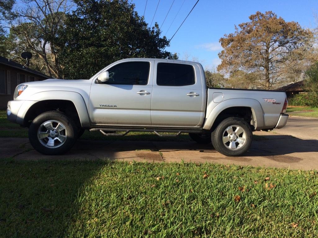

    This is 5100's front and back with OME 885 coils and deaver AAL. Even with this lift 285's would not fit. They rubbed multiple places. The picture shows 265/65's and I have since moved to 265/70's with no issues at all. I would have liked to have kept the 285's but I'm not going to butcher my truck to make it happen.

    Thanks for all of your posts. I ended up going with the Pro Comp Nitro 3" front/1" rear lift. My tires added about 1/2 inch of height and this kit made it perfect for what I was looking for. The truck is level. The ride is still good but feels a little heavier (if that makes sense) and it seems to downshift a little more often. The truck rides nice on the interstate. All in all I'm happy. :)
