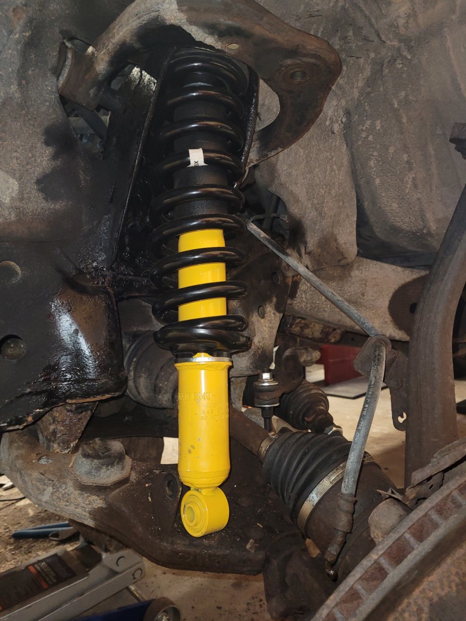

    Progressive add a leaf kit from old man emu. 883 struts from old man emu. (3 in suspension lift)
    I've pushed with all my might and even put a pry bar to the lower control arm. Can't seem to line up the hole

    Screenshot_20210302-160139_Chrome.jpg Screenshot_20210302-160139_Chrome.jpg Check to see if the lower spring perch should be faced up or down.....

    It looks like the lower spring support on the shock may be flipped? That would sit the coil too high

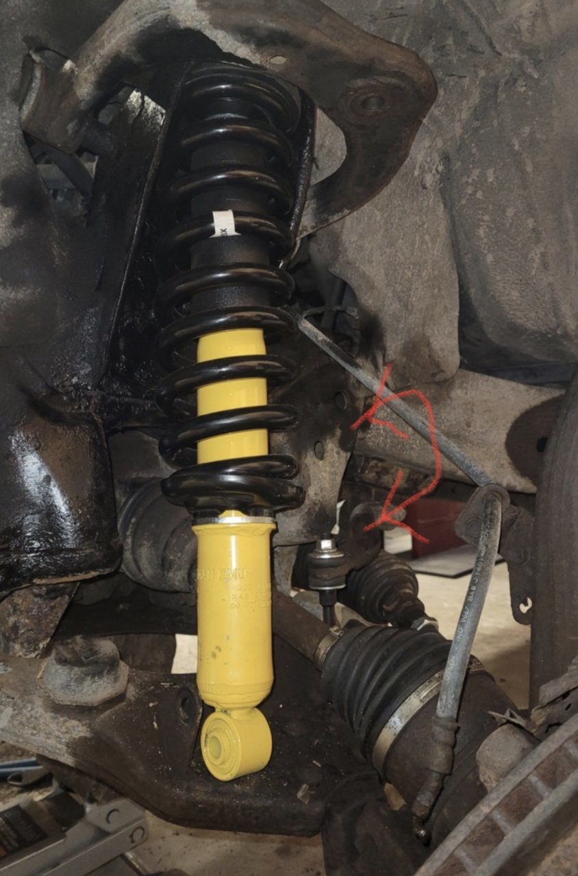

    yup I think that’s it! It doesn’t look right.

    I think the part I circled is upside down. I know I don’t have the same shocks but it should look similar to the picture of my shock that I posted.
