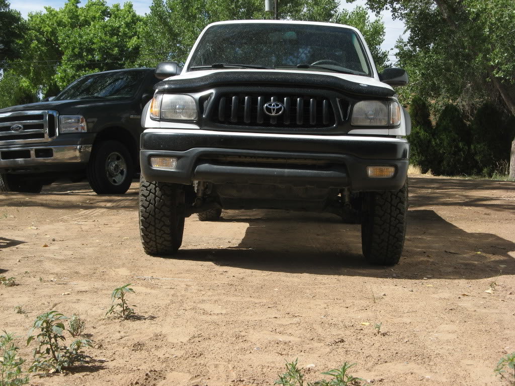

    Inner fender plastic but you really have to hit hard to get it too. It also rubs the frame at full lock but just barely with my stock rims.
    I also did the "pinch weld mod" which helped a lot with rubbing.
    Heres a pic that shows just how narrow they are.
