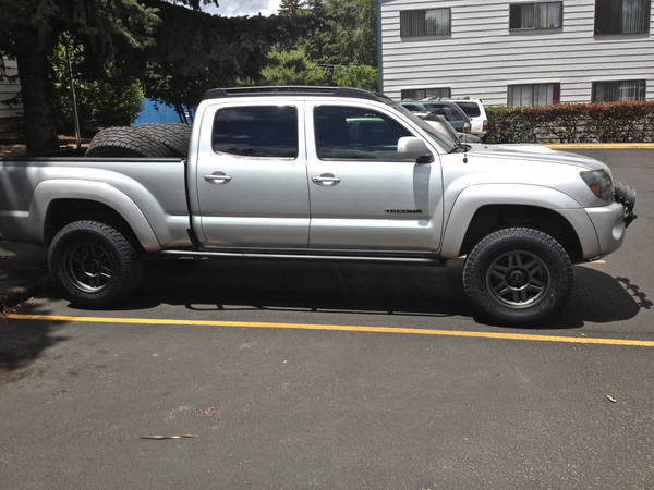

    3 inch suspension lift.
    Yes, the tires stick out a little past the fenders and mudflaps. and yes they are 17x9 -12 offset.
