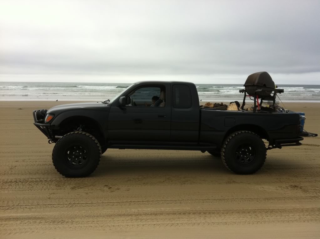

    1st gen:
    2nd gen:
    I just don't see the appeal.

    first pic is definitely loaded down. And I am sure the 2nd gen has full drop, uca, spindle etc. I am just looking to do a 2.5"-3" leveling kit. Either with billys, spacer or whatever you all recommend.

    Yeah, the top pic looks like the rear shocks and leafs are about to pop lol

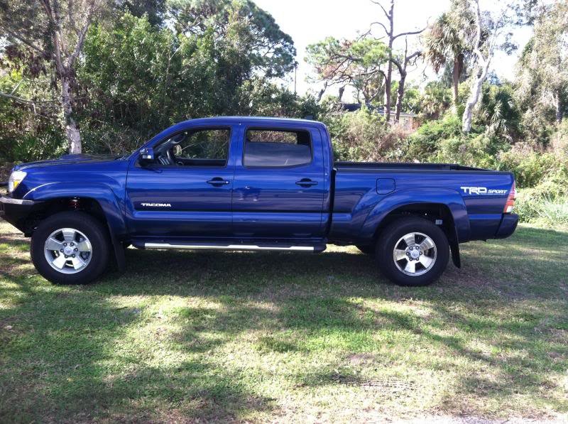

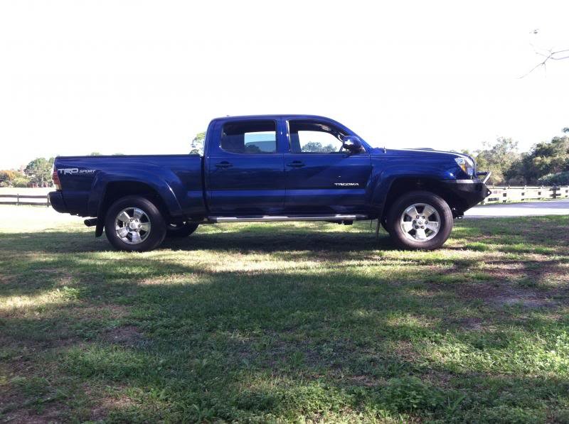

    Can you all tell if I have a level yet? Or is this what the stock pre-runners look like?

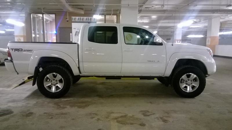

    Bilstein 5100's @ 2.75" FR, Deaver 1.5" TSB leafs RR, SpiderTrax 1" spacers, custom LED interior & bed lights, 2005 4Runner Sport 17" wheels powder coated satin black
    Bilstein 5100's (@ 2.5") in front / stock springs
    Deaver 1.5" tsb AAL in the back / stock shocks
    (total cost after installing them myself = $370 + $120 alignment)
