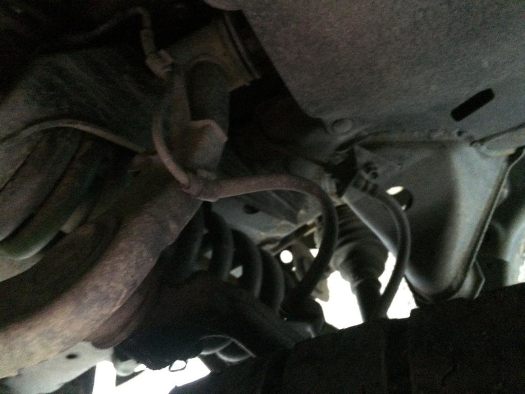

    While i was looking through the glove department i found a paper from the dealer and it said that mine came with Bilstein 5100s but i havent had the time to check and i dont know how true it is but i was thinking off saving but right now i dont have a job but i also have a birthday coming up in july so ill prob wait until then

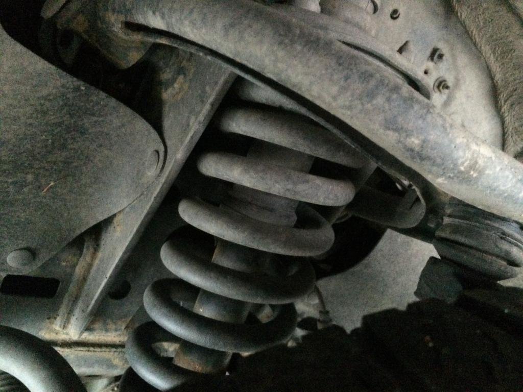

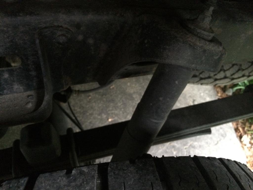

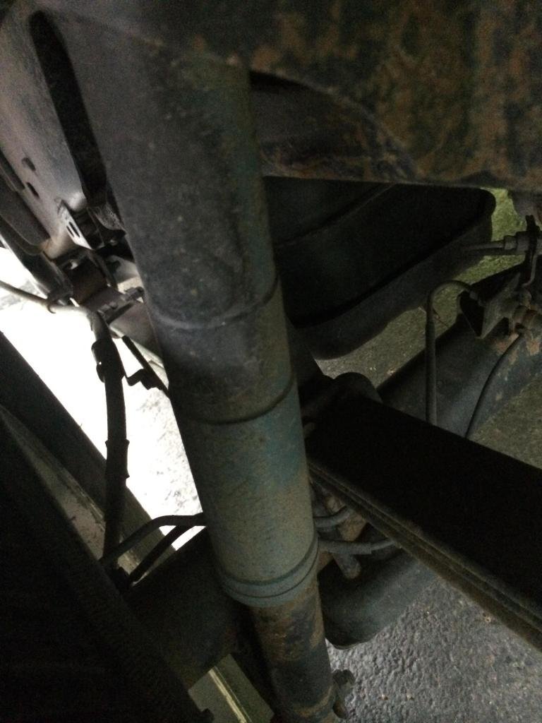

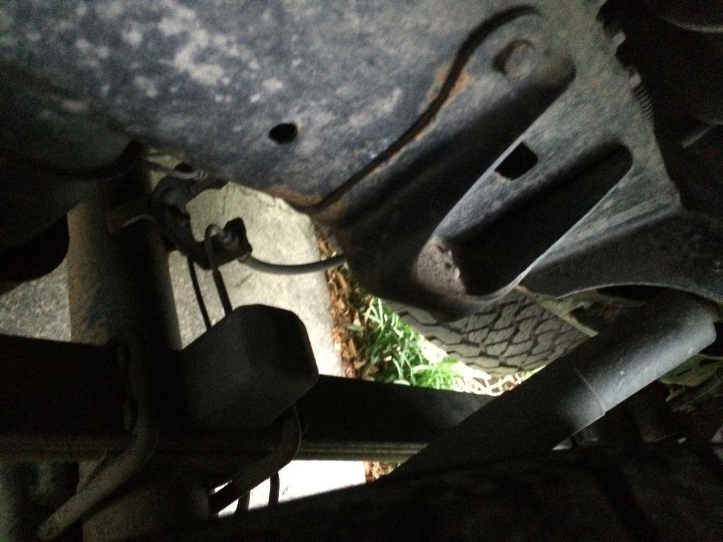

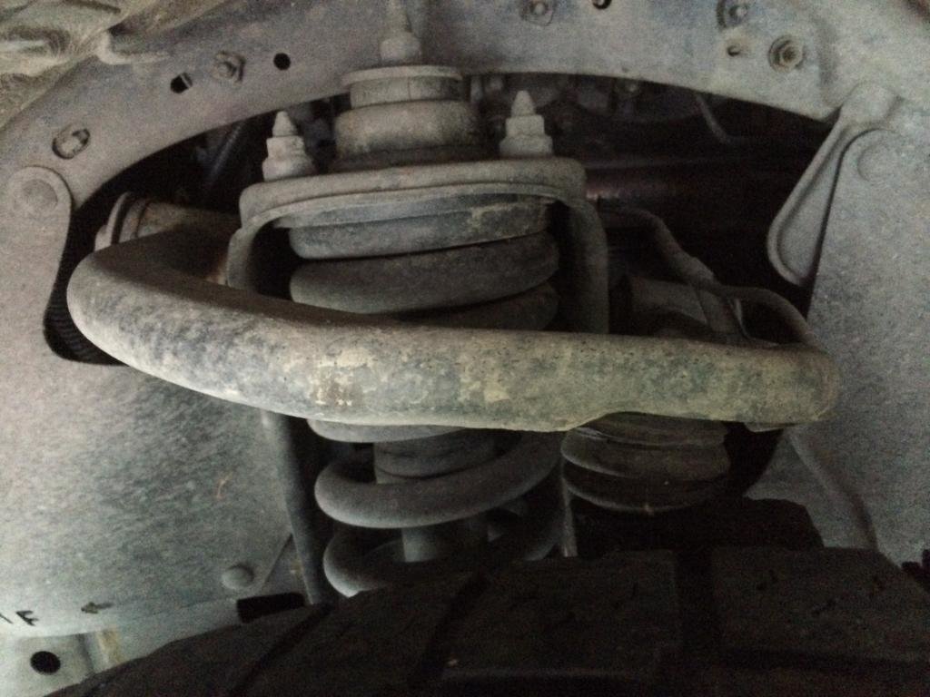

    take some pics of the suspension, we'll tell you what you have. you might be thinking of the stock bilstein HD's

  7. May 15, 2014 at 4:21 PM

    Those are stock shocks. 5100's would be an upgrade. I agree that you should save up for what you really want. I almost went the 5100 route due to impatience. Instead, I just got Icon Stage I all around with their progressive ALL and light racing UCAs. I told the shop to see what kinda lift the AAL gave me in the back and match that up front. Ended up with just over 2" and quite satisfied with it. No issues so far with VSC, vibes, etc. Alignment came out great.
