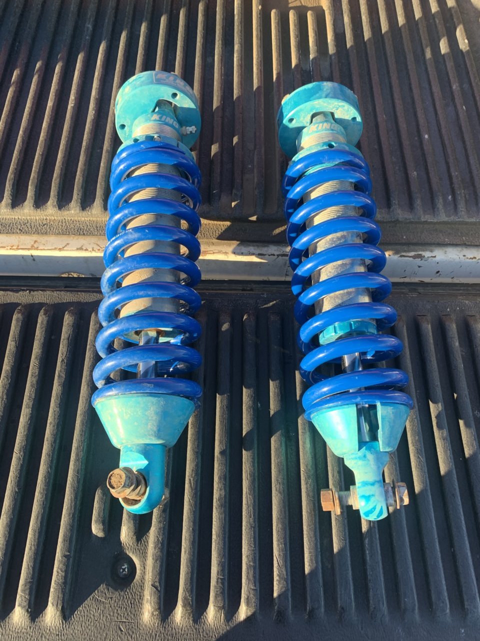

    Could you measure your coilover for me? I seem to be topping out on these kings over speed bumps. Measure from the top of the shock to the bottom bolt pleasse

    I would normally oblige in providing any info I can, but at the moment it would be irrelevant.
    My coilovers are compressed slightly due to the weight of my vehicle. You've got a Tacoma whereas I have a 4Runner; my truck weighs more than yours.
    I will say I have the extended variants and have 10 threads exposed.

    Well it’s suppose to be at 2.5 right now but I talked to king and it has to much preload

    I had about 11 threads exposed when I got my Kings -
    As you can see I bought them new. They had preload for 2.5" of lift for a 4x4 Tacoma/4Runner

    I bought mine used but rebuilt. We’re on a 4 runner though

    Go back to the important details I gave you; how many threads are exposed?
    And confirm your springs by looking at what's labeled on them (weight rating/length).
    I'm running 14/600lb springs.
