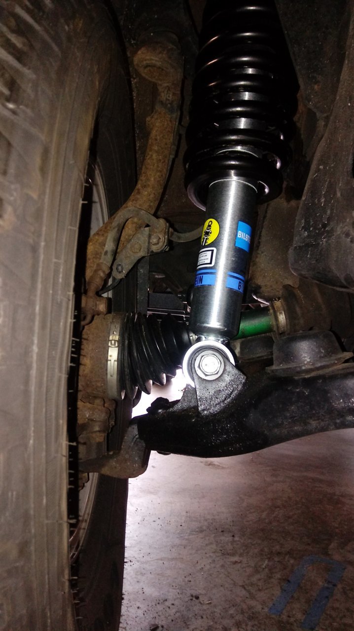

    You will get more than 3" because you have a 4 cyl. I would think it would ride as stiff as a board and a diff drop may not be enough to correct your CV angles. When I first put my lift on, I had my 5100 struts set too high and got like 3.75". Here's a pic of my CV angles. 0324181507.jpgYou may have better luck with an OME 881 coil, I plan on installing 880's in the near future and those should give me 1.75-2" on a 4 cyl. I would think an 881 would net close to 2.5-3" on a 4 cyl.

    Surprisingly those were Moog 81102 coils at the 1.33" setting. I imagine they wouldve settled to around 2.5" at that setting. I put them at the lowest setting and got 1" of lift. I'm not overly impressed with their ride quality so I'm gonna replace them with OME 880 which should net around 1.75-2" on the lowest setting.
