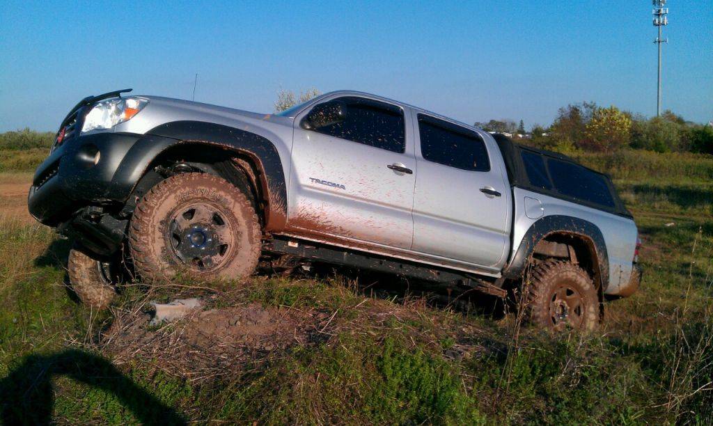

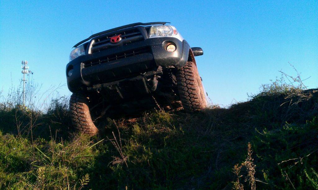

    My front end lift is Blstn 5100's set at 0 with OME 885x springs, and Toytec .25" spacers to give a total of 3" of lift. I also have LR UCA's set with the emblem facing strait out. I have stock steel sr5 rims with 1.25" spider traxx wheel spacers, and my tires are Definity Dakota M/T 285/75/16. The only rubbing I've expirienced so far has been on my front mud flaps, which I removed, now I'm good.

    This looks amazing :eek:
    And ill report back when i do this. I have the 285/70/17 duratracs, and the truck, just need the rest...
