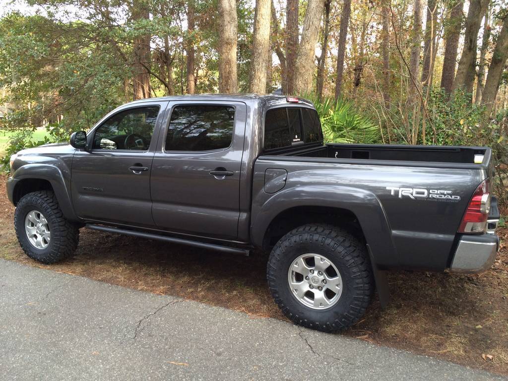

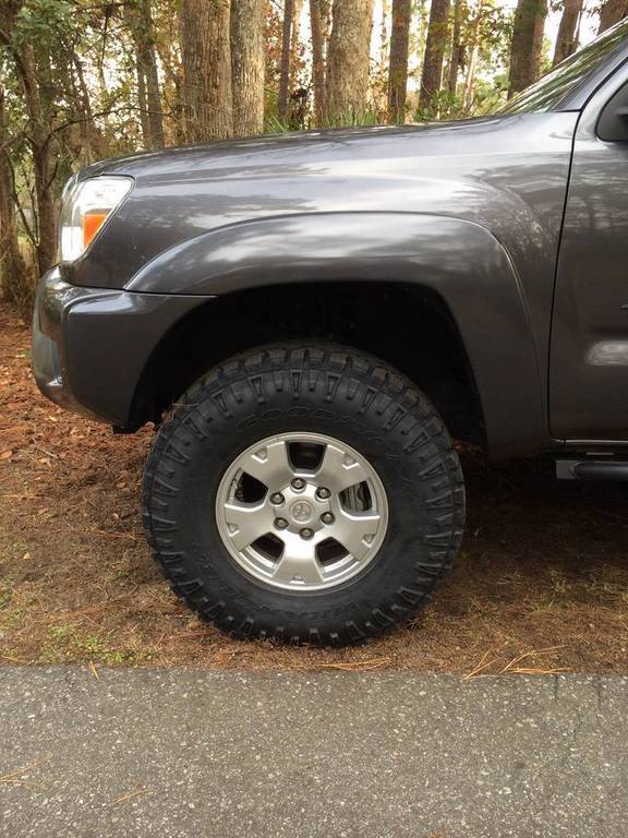

    I'm running a 2.5" lift in the front with 5100s on stock sport springs. I was able to get 1.7 caster, and I'm running stock off-road wheels with 1". Bora spacers all around. I had to take off my mudflaps but did not have to do any trimming at all. Also running a 1.5" block in the rear.

    These are 285s, yes? I'll be going back to my stock 16s and staying with 285s here shortly. I've got the same lift as you, but I think my BORAs are 0.75". After going back down to 0 on the Billies and adding OME886s (with 3/8" and 1/4" TP spacers), new UCAs, and a TJM...I wonder if the difference btw me needing a CMC will be the 0.25" difference in wheel spacer. Looks like you have plenty of wiggle room to stuff those tires. And I should have more height than I do now.

    Yes, they're 285/75s. To be honest, I don't think the lift is the issue with rubbing. I think it's the wheel offset/backspacing/width. I searched on here for months debating lift, wheels and tires, and no one I found with this combo had any issues. Granted, I haven't fully stuffed them as I don't do any serious off-roading, but I've been out in the woods to hunt, and wheeled in the mud a bit and I haven't rubbed once. My mudflaps did have to go, but that's it. No trimming at all and I don't rub at full lock in forward or reverse.
    Edit: I think your caster will play a part in it too.
