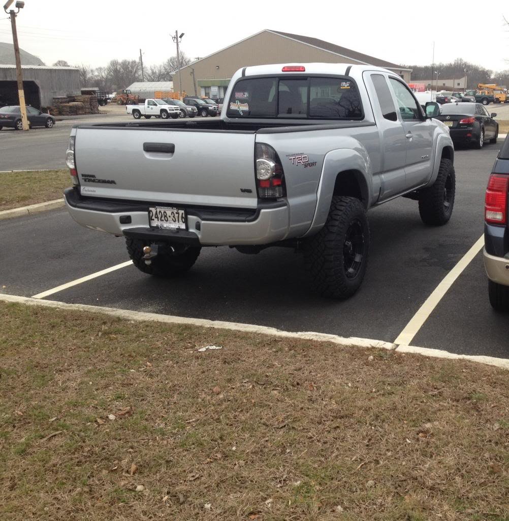

    Just finished the lift on the replacement taco last night
    - 5100's at 2.5
    - stock UCA's
    - wheelers 3leaf progressive 1.5" HD. With factory overload left in
    - raceline raptor 981 wheels 17x9 5.0" backspacing
    - 285/70/17 duratracs
    -removed all mud flaps and the little ones in front of the front wheels
    Need to trim just a little plastic near the cab mount. Doesn't hit the cab mount at the moment. Still need to get it aligned so I don't know if that will change that

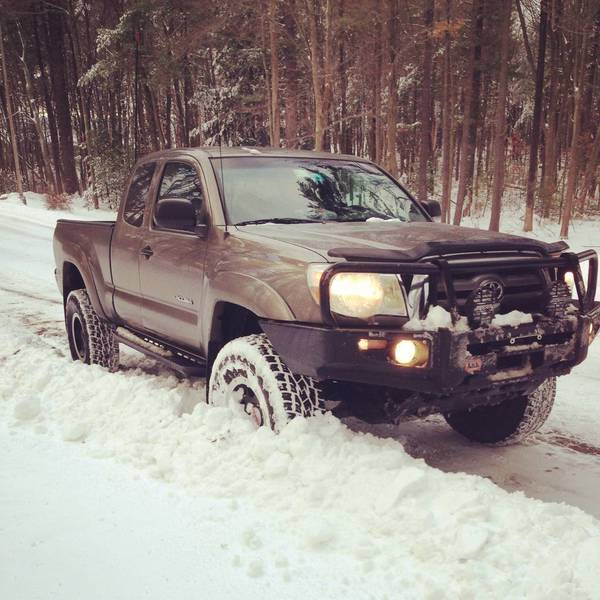

    I'm currently running the OME heavy 2" lift with 285/75-16 Toyo AT2's. No rubbing or trimming at all so far. Haven't done any extreme off roading yet, but it can hop curbs no problem.
    2010 with T|X wheels...apparently I get about 2.25" of lift with the OME setup; not sure if that's going to settle any more or not...

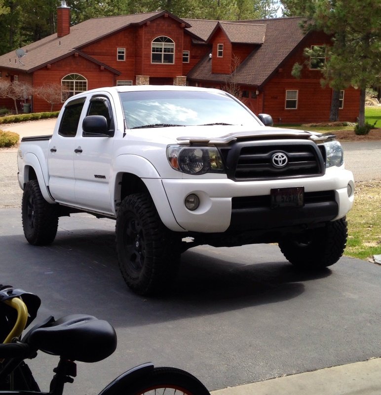

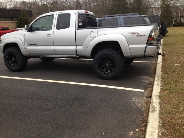

    3in lift, 5100s front and rear, OME 887 springs 2in aal, 285 75 16 Duratracs, mb 352 black wheels, white sport grill, derp'd lower valance, derp'd front toyota emblem white, tinted windows, tinted tail lights, trd shorty antenna, trd hitch cover, trd valve stem caps, trd neoprene covers, trd all weather floor mats, kenwood double din, stampede window visors, flyzeye interior leds, anytime fog light mod, flashlight mod, kool vue intake, LED dome light, Lund bug shield, TRD shift knob,front mud flaps removed, Debadged, truxedo roll up bed cover, led fog light bulbs, led parking light bulbs, led dtrls bulbs, led headlight bulbs, led back up light bulbs, led license plate bulbs, tinted license plate covers, 18" magnaflow muffler, 32in ebay, light bar, coverking neoprene resr seat cover, oem trd skid plate, trd decal on center caps, oem trd exhaust tip, blacked out pinch welds, color matched mirror covers.
    Here's mine just took my spacer lift off a month ago and put 5100s on set at 2.5 has a AAL in the rear 285 75 16 duratracks no front mud flaps and minor trimming 1.25" wheels spacers stock wheels
    Thanks man new wheels are next so many choices tho only rubbing on that set up is when reversing
