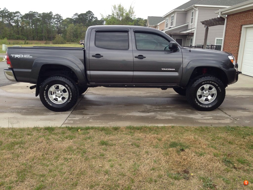

    I'm running 285/75/16 Duratracs with Procomp 7089's and 885's and 5100's at 0" and wheelers rear progressive AAL. Minor rubbing on the front mudflaps at full lock. Nothing bad though.

    285/75/16 BFG AT, stock wheels, 1.25" wheel spacers, 3 inch lift, Icon coilovers, LR UCA.
    To test for rubbing I took out the coilover and compressed suspension fully to see where I was gonna rub while at full turn in each direction and full compression. I wanted to make sure there would be no rubbing if I completely bottom out the front end while my wheels are fully turned. So I let the whole weight of the truck set on the bump stops and turned the wheel to each side and checked the clearance.
    I had to do the CMC, trim plastic on bottom rear of fender flair and extend the height of my wheelers super bumps to eliminate any possibility of rubbing.
    I think I had so much rubbing because I have 1.25" spacers and I told my alignment shop to give my over +2.6 degrees of caster so maybe my wheels sit further to the rear.
