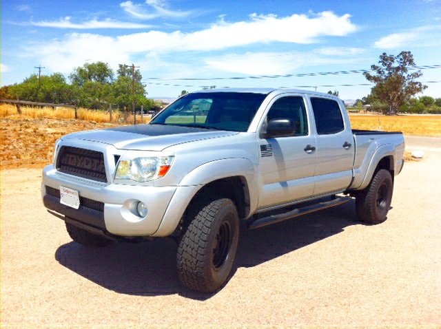

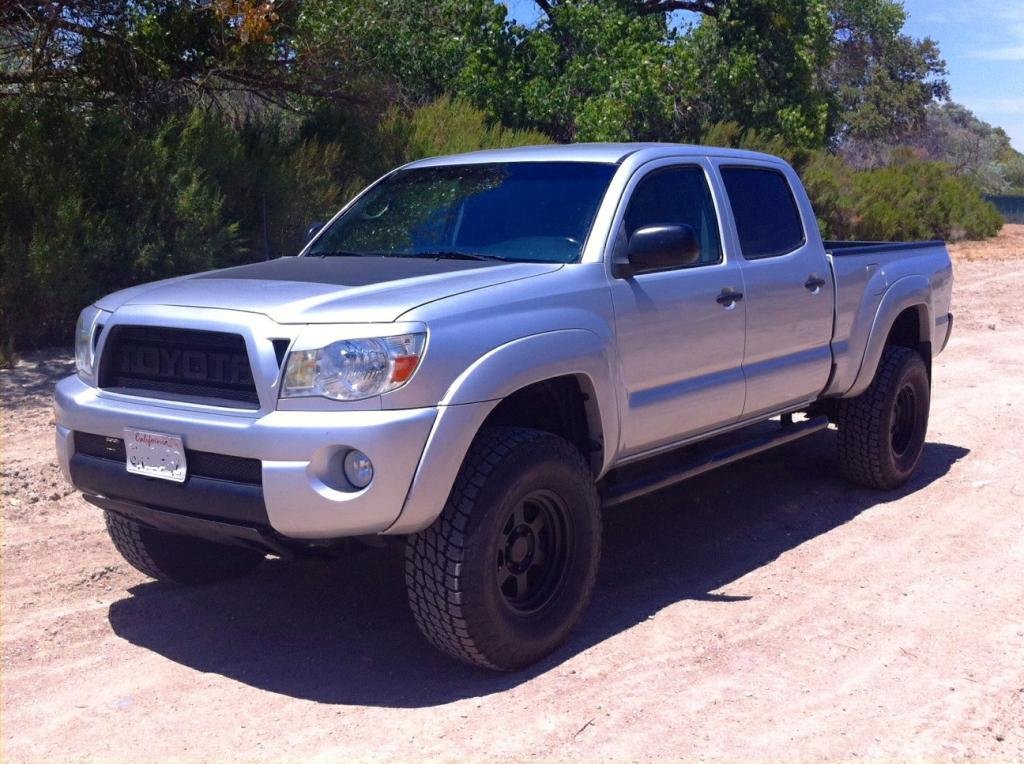

    Toytech Ultimate Lift Kit set at 3", FN Countersteer Type X wheels, Nitto Terra Grapplers 285/75/16. Had some rubbing but did some minor trimming, no big deal.

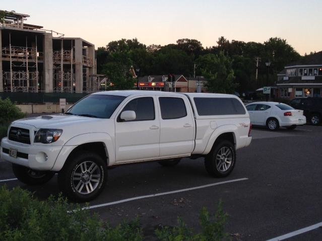

    5100s and Toytec coilovers. 285/75/16 BFG KM2s.
    Trimmed a good bit of plastic, but no metal. They rub VERY occasionally, seemingly at random times. If I'm not in a hurry, I'll get out and locate the issue to cut it out.

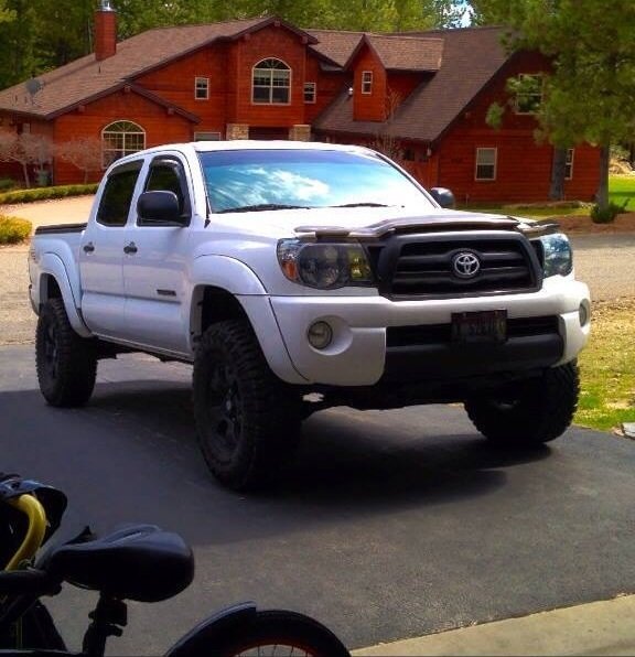

    3in lift, 5100s front and rear, OME 887 springs 2in aal, 285 75 16 Duratracs, mb 352 black wheels, white sport grill, derp'd lower valance, derp'd front toyota emblem white, tinted windows, tinted tail lights, trd shorty antenna, trd hitch cover, trd valve stem caps, trd neoprene covers, trd all weather floor mats, kenwood double din, stampede window visors, flyzeye interior leds, anytime fog light mod, flashlight mod, kool vue intake, LED dome light, Lund bug shield, TRD shift knob,front mud flaps removed, Debadged, truxedo roll up bed cover, led fog light bulbs, led parking light bulbs, led dtrls bulbs, led headlight bulbs, led back up light bulbs, led license plate bulbs, tinted license plate covers, 18" magnaflow muffler, 32in ebay, light bar, coverking neoprene resr seat cover, oem trd skid plate, trd decal on center caps, oem trd exhaust tip, blacked out pinch welds, color matched mirror covers.
    285 75 16s 2in lift roughly
