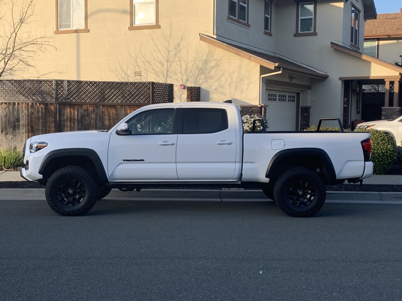

    5100’s 1.5” lift stock coils 1.5” rear lift. 4th Setting no sagging. Ride is not harsh at all. Just my opinion. I was going to get Springs But opted out. After all the members in the post I’ve read how the springs were sagging. Stuck with the factory coil’s. Ride is not harsh at all. Maintained factory rake.
