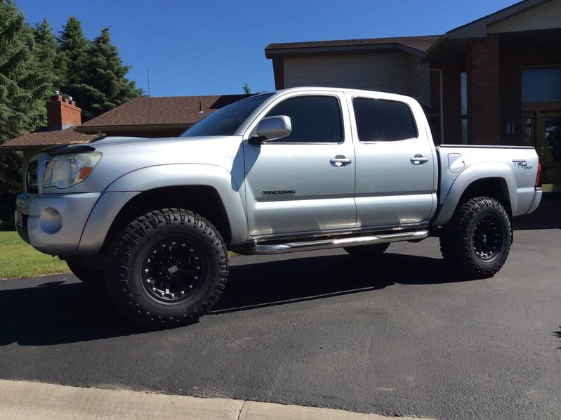

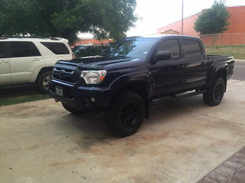

    Get the OME/bilstein bundle kit at headstrong with with 885s or 887s! I just got the 887s, about 2.75 inches of lift and ride is fantastic. Here is the link to the kit I got...don't need the diff drop, UCAs are optional (recomended but not required). Labor at my dealer was $475 with an alignment (no UCAs and unassembled coil over).

    No spacers, 2.75 inches of lift. For three inches go with 885 coils and get the top plate spacers. Either will be loads better than a straight 3" spacer.

    The link above the pic I posted. Call or email them before you order and tell them exactly what you want to achieve, they are very helpful.
