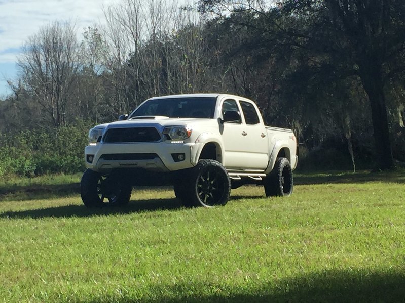

    You could add maxtrac spindles on top of your 3" you already have since your a pre runner. It's really simple, doesn't effect anything, just adds track width and height and keeps stock suspension geometry. You'll have over 6" of lift if you do that tho, 3" + 3.75" from the spindles.
    I have maxtrac spindles and 5100s Set at 2.5".
