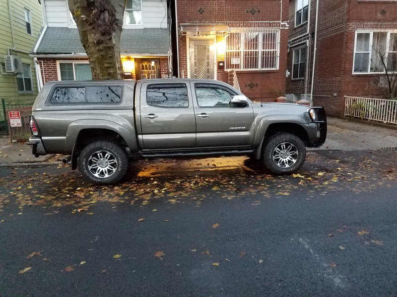

    Work in progress
    ARE cap, wade inchannel vent visors, weathertec floor mats, ranch hand grill guard, tuffy security boxes in bed, lockable tailgate handle. Still have stuff that needs to be installed and still have stuff ordered lol.
    i have 5100s up front set to zero with 886 coils, dakar leaf springs in rear with 5100's, carrier bearing drop, taco lean spacer

    What size wheels and tires do you have there?

    17x8.5 rims lt265/70r17 tires
