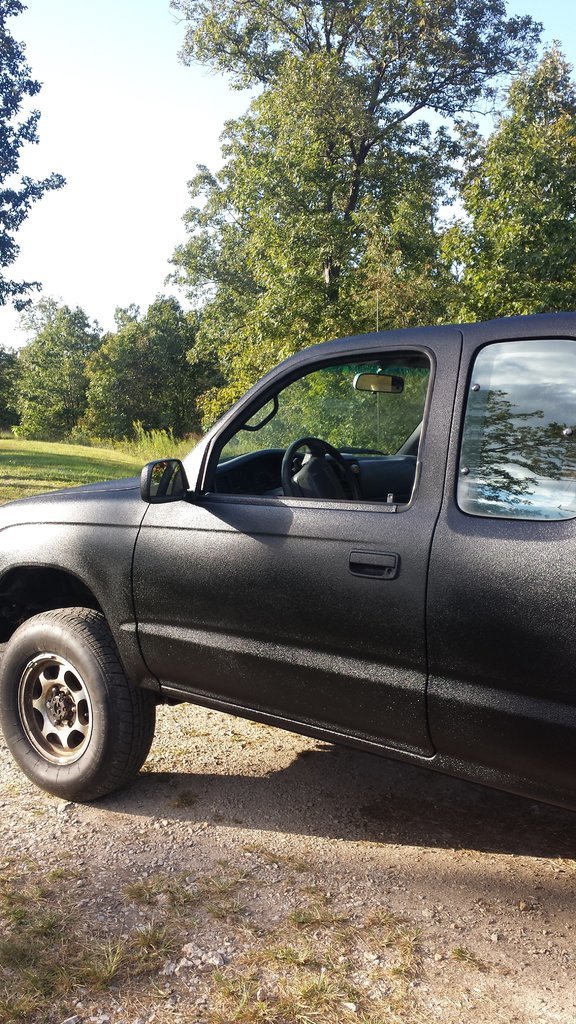

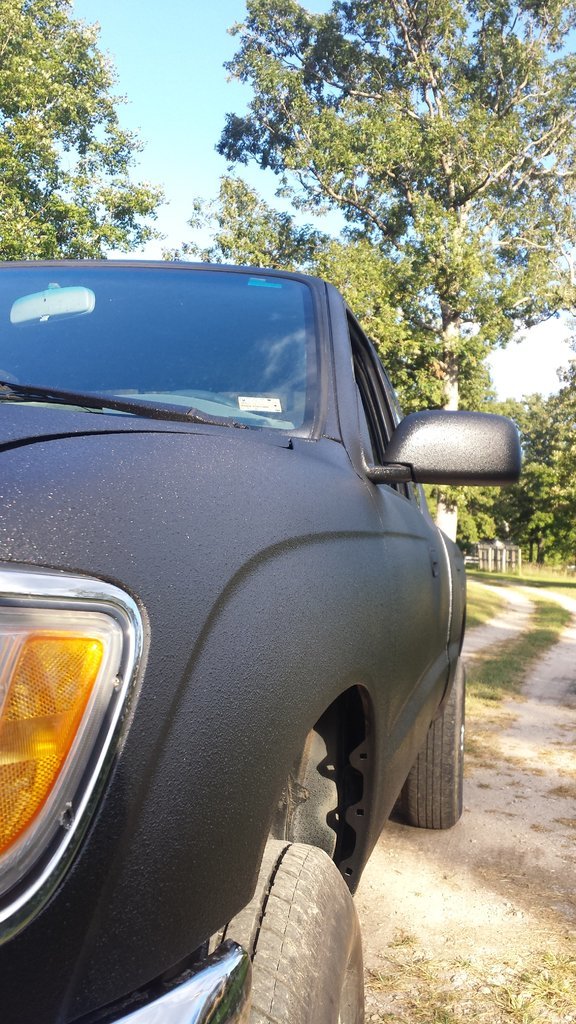

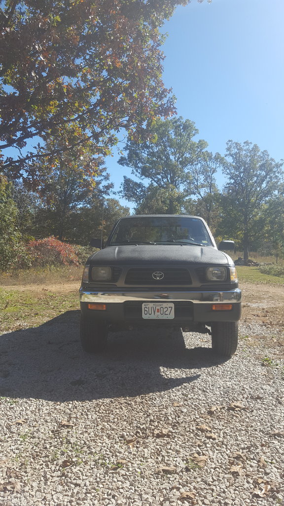

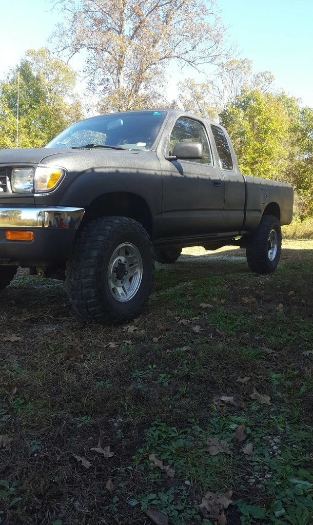

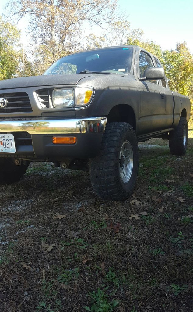

    I think ive decided to go with a 3 inch lift. I already have a 2.5inch leveling kit up front. Would I notice a lift difference between the leveling kit and a regular coilover lift? 20160902_175419.jpg 20160902_175428.jpg any suggestions on what brand/type of lift to go with? Pictures/setup descriptions are welcome. First 2 pictures are with stock tires size I believe, the other pictures are with 31x10.5. All pics are with the leveling kit already instaled. Really looking to get some extra height but can't afford $1000+ lift lol20160902_175419.jpg 20160902_175428.jpg 20161022_114515.jpg VZM.IMG_20161022_142847.jpg VZM.IMG_20161022_142817.jpg

    Not clear on what you mean. By leveling kit do you mean a spacer lift? If so, yes you will notice a huge difference between that and coilovers. Even bilstein 5100's with stock coils will do better than a spacer.
    If you are looking to upgrade most or all of your suspension components, you'll be hard pressed to do it for under $1k after all is said and done.

    You probably won't notice anything from a height/stance perspective.
    But like drr said, if you're going from a spacer lift to coilovers or 5100's, you will see a huge difference in ride quality, handling, articulation, etc. How much are you looking to spend? ;)

    Thanks for all the info. I didn't really think I could get a full lift for less than $1000. But I guess if I'm wanting to get a taller stance I'll have to pay a little more to achieve the look I'm trying to get. Any recommendations on how to get a taller stance. Without giving an arm/leg? I wouldn't be opposed to a small body lift, but I would really like to stay away from them if at all possible. I hear they are terrible, never really had one so idk how terrible they really are.
