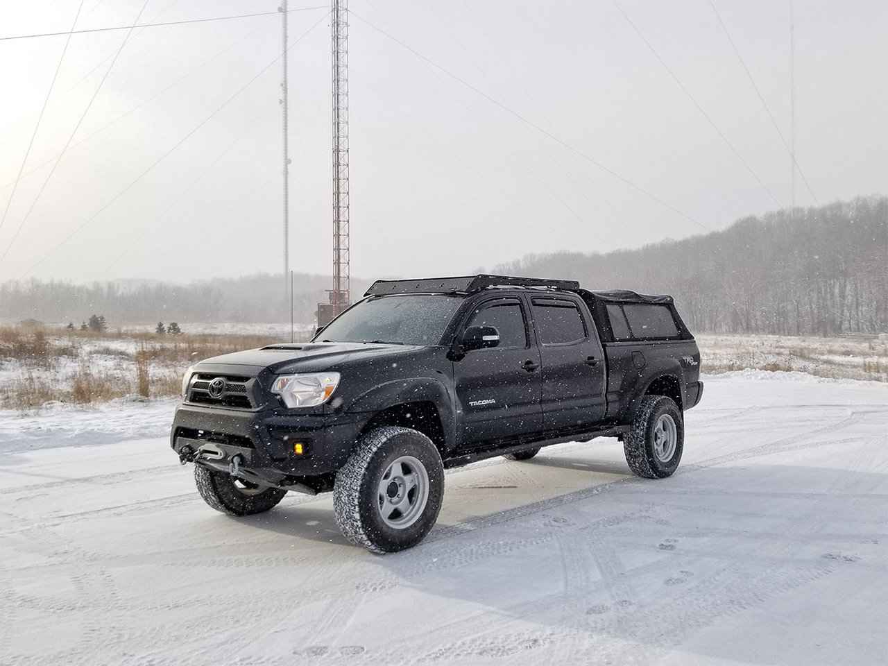

    Hey webdr, nice truck! Do you have posts regarding your setup and mods?

    Thanks! I'm going to do a build thread one of these days. ;)
