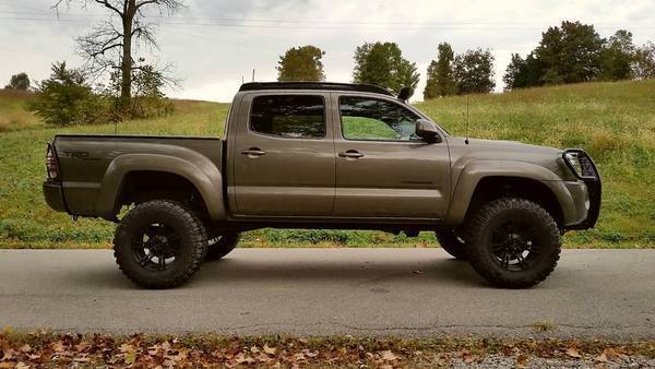

    Nice rig! I actually like rake but wouldn't mind coming up just a tad in the front. What is your setup? Did you have center hub to fender measurements to share?

    Can't remember the measurement off the top of my head, would have to remeasure. Lift is Toytec ultimate set to 3" in the front and corrected for lean. Dakars in the back with SOS Shackle Flip and stock shackles. Shock relocate to follow with fox 2.0.
