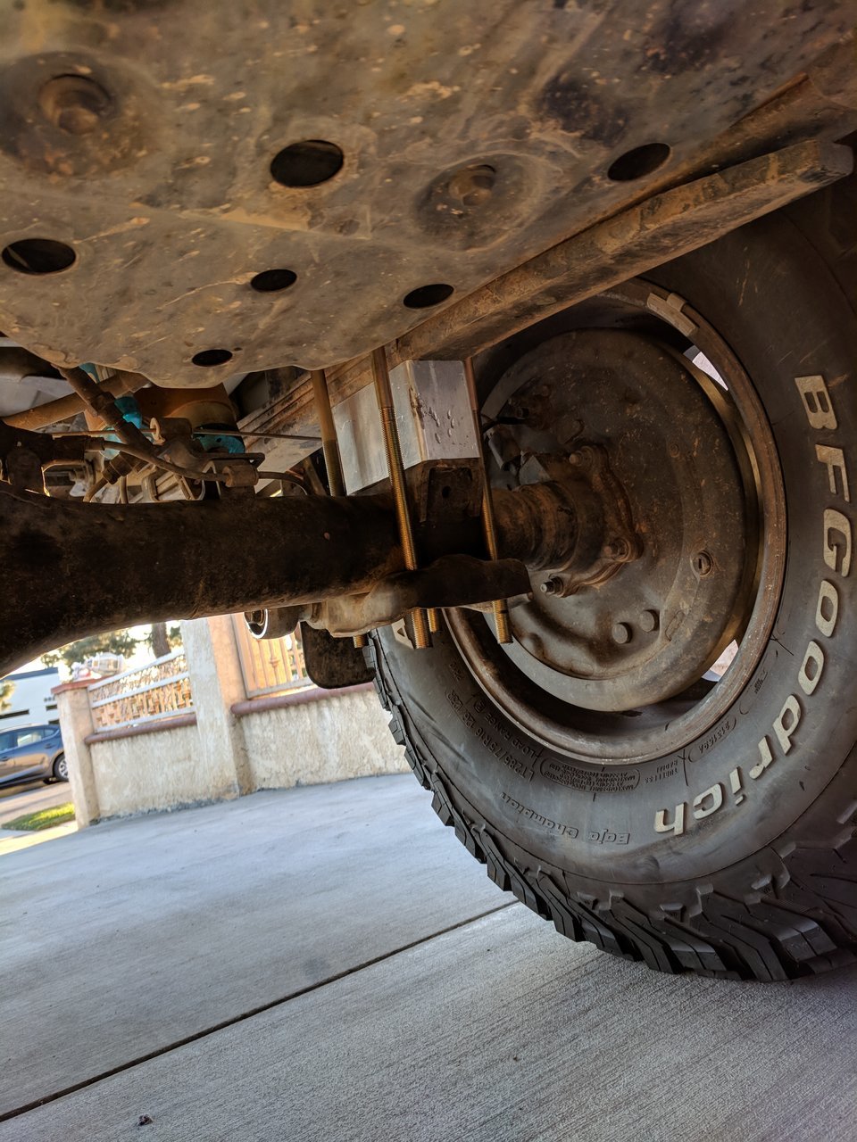

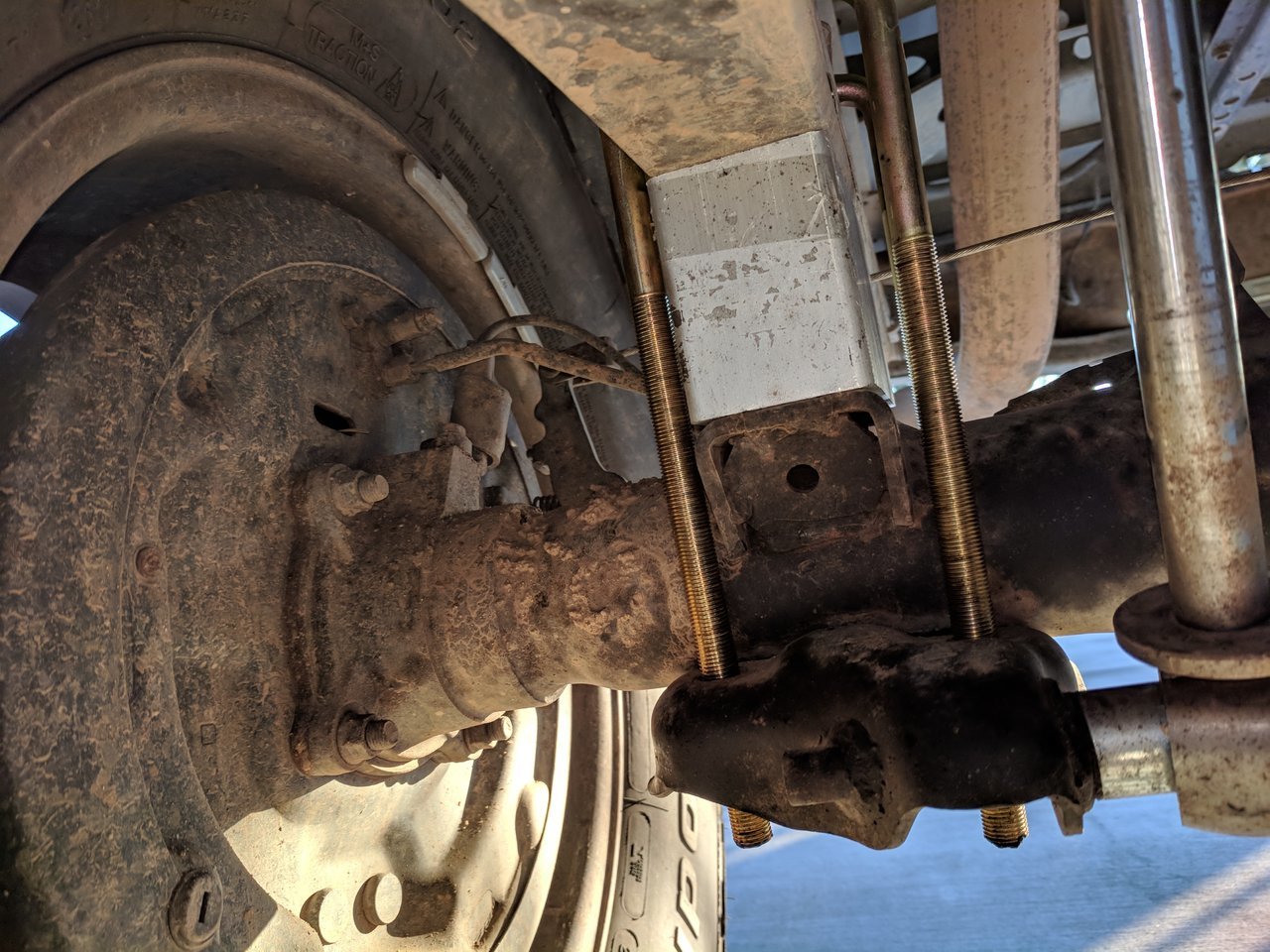

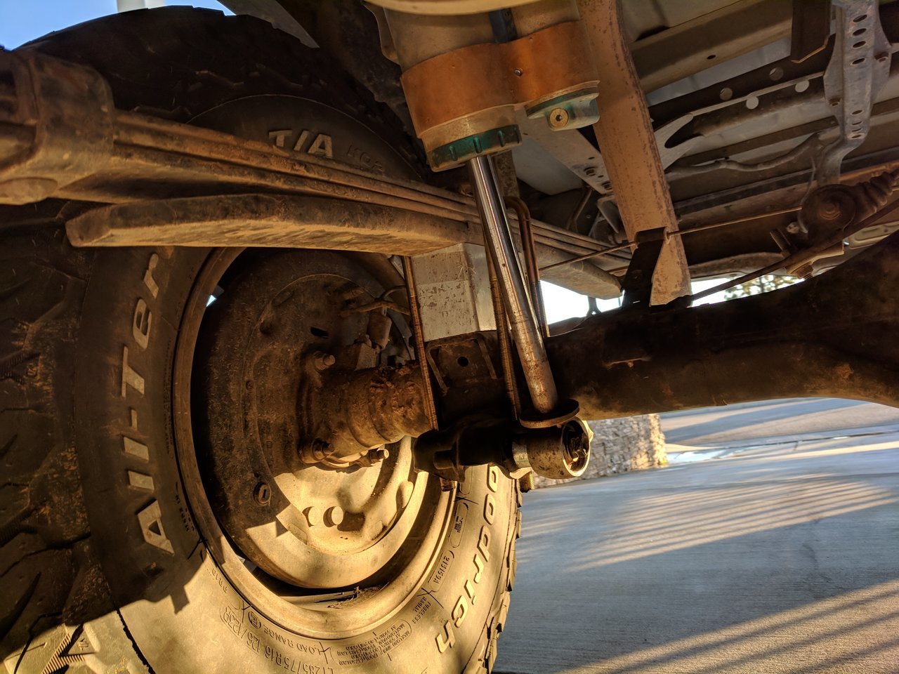

    Hey guys new member. I just did a king front and rear shock with coil over. Wanted more height so I added 1 inch spacer in front and 3 inch block in rear to level truck out! Now my rear is bouncy when I drive!!! Any suggestions on how to fix. Maybe an add a leaf?

    Swap out that block for a custom leaf pack, or add a trac bar.

    The blocks make it ride like shit. That said, either get used to it or remove it and get a leaf pack installed.
    To be honest I went the same route with blocks in the rear and bilstein 5160's, got used to it. Will eventually move to Dakars

    Welcome to TW. Had those blocks on mine as well, they are terrible, get a AAL instead with rear struts.

    Add a leaf

    Is that an aluminum lift block??

    On yah that's what I'm going to do add a leaf
    Question- I want to keep my height should I leave the block in and still add an AAL?

    Yes aluminum block
