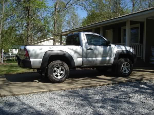

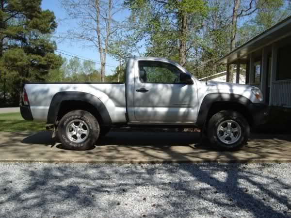

    i dunno why everyone wants to go 3" of lift....i mean why not just run 32" tires?...it's not that big of a difference.....when you lift the rear you can run into vibration issues and such.....i did it the easy way....the rear was plenty high enough for me (no tsb needed on the reg cab)...i left it alone....i got bilstein 5100s all the way around and set them at 0" in the front and got OME 883 lifting springs which lifted the front about 1 1/2"...now there is plenty of room in the front too and the ride is not any harsher than the stock ride....rides great and no vibration problems or anything to worry about....for all four shocks and the two front springs it was $450...not bad

    I agree, getting 33s on a Taco takes a lot, 32s take nothing. I'm about +2" front and +1" back and I run 32's.
