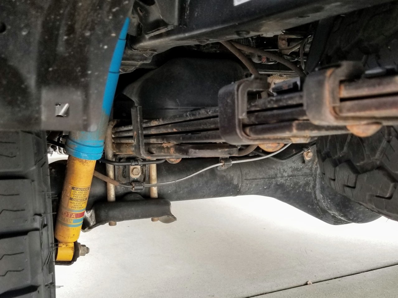

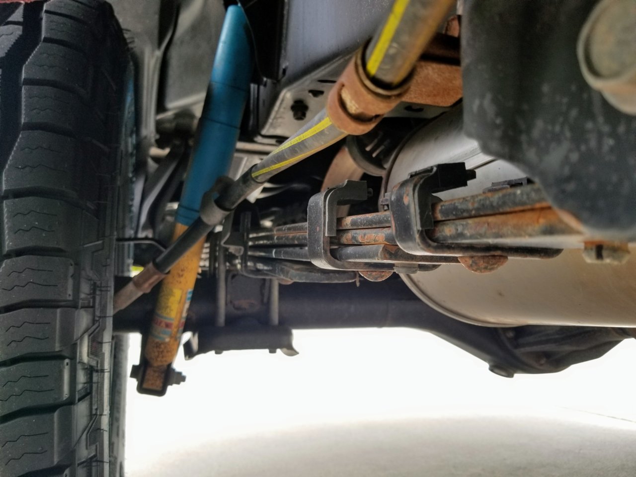

    I've recently purchased a 2015 DCSB 4x4 with the TRD Off Road package. It's got about 93k miles on it. I'm doing research on suspension improvements/lifts. I'm pretty set on 5100's with 884 or 885 springs in the front and JBA UCA's. For the rear, my initial thought was a 3 leaf progressive AAL from Headstrong, probably WITHOUT the stock overload. I'd go with 5100's or maybe 5125's in the rear. Below are pics of my stock leaf springs. I'm wondering if the progressive AAL will work well with these, or do I need to go to a new spring pack (like a Dakar)? I'm asking because the stock springs look so flat. They don't appear to be inverted or anything, but there's close to zero arch in them. The truck will see offroad use maybe 1 weekend a month. Most of that use will be in the desert/dunes. We won't be hammering on the truck too hard. It will occasionally tow a flatbed trailer with a SxS on it, maybe 300 lbs of tongue weight at the most. Otherwise, it will never carry a load. So, do you think the progressive AAL will work out well? I'm thinking maybe the Bilstein 5125 (33-230337) for the rear to avoid topping out the shocks and get some extra droop.

    leaf packs do flatten out over time. If you did the AAL it would probably be nice for 6 months or so and then flatten out. You could either get a new pack or find a newer take off pack and do the AAL to that. As far as shocks go, Bilstein 5160 look and perform decent in the rear as well.

    I have a set of 2015 take offs (3 leaves) on mine with a 3 leaf add a leaf and no overload. I bought them used together with 5100s. They still have plenty of positive arch and gave me 1.5 inches of lift over stock and I still have that much. I have hauled up to the payload capacity quite a few times and it has been fine. The ride is also very nice, especially with 50-100 lbs in back. I am at stock height in front. I think the guys that have trouble with them have constant weight in the bed.... tools, caps, armor, camping stuff or any combination of them. If you don't carry weight constantly they should be fine for you. If you do carry significant weight constantly or regularly then the Dakars would be a wise choice. You will need the longer 5100s with the 3 leaf though. The stock shocks are too short and will fail. Some of the vendors here have suspension packages at good prices. A search will turn them up.
    I wonder what the original owner of your truck did to flatten them .My original off road package springs were two leaves plus overload. They were not flat like that. They just bottomed out with 4 normal sized people in the cab.

    You look to have what I got, 3 leaves plus the overload. Mine had original springs (or maybe replaced under recall by the PO) with just the 2 leaves... and had a walk-in ARE MX cap when I bought it. I have no idea how it wasn't totally dragging the ass end.

    Single add-a-leafs are a waste of time and money (but that's not your question)
    The 3 leaf progressive is a good solution for the price. I installed a set on a buddies 2015 DCSB. He chose to reinstall the factory "overload leaf" at the bottom of the new pack. I wouldn't have done that personally as it seemed to me to be only good as a lift block of its own thickness. I doubt the ends of that leaf will ever contact anything given the 3 new progressive leafs above it.
    That said, the truck rides as it did before, less axle wrap and sits 1.75" higher (with overload) and didn't cost much. Install was dead easy.
