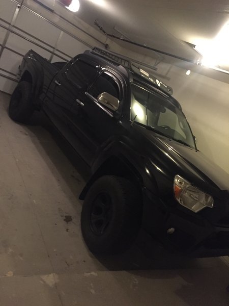

    Did a 3" leveling kit
    Can I put 255/75/17 covert (32.1) tires on a 3" leveling kit without rubbing? Any suggestions I can do! Please help

    Yes and no.

    Probably have to remove the front mud flaps and trim the fender a little bit.

    I don't see 255/75 being an issue.
    I had to do some trimming to make my 255/85 clear though.
    That said several things influence tire size fitment. Upper Control Arms, Alignment (forward Caster mostly), wheel offset/backspacing, and of course tire size.

    Okay thanks, I have also a 2" wheel spacer on, maybe that would help. I would probably have to go higher?

    The wheel spacers will actually make it run worse it I remember correctly

    Wheel Spacers aren't... highly recommended.
    They can change the angle of the tire compared to the fender edge. This can increase the chances of rubbing because the tire itself doesn't stay within the wheel well the entire time as it rotates left to right.

    Wheel spacers are no different than wheels with wider offset....They CAN cause problems. They CAN eliminate problems. So can wheels with wider offset. Track width is track width....

    3" isn't a 'leveling kit'. It's a lift.
    And it will need UCAs to get a good alignment.

    So just take off the wheel spacers and try to put on 32" tires, to check if it still rubs. Then maybe adjust the suspension height a little higher. What's the best solution?

    So do I take my spacer off? Put my 32" tires on and check to see if it will still rub my fender. What should I do if it rubs? Should I go with a bigger lift? Smaller tire?

    The first question (for me) would be why do I need a 3" lift and 32" tires?
    If it was for looks only, I'd back off until I wasn't creating new issues to address. Or be prepared to pay the piper.
    If it was a functional need (ground clearance, extra grip, etc) I'd get all the right stuff and do it correctly from the beginning.
    Only you can decide 'why' you are on this path.

    You can cause I'm running it right now
