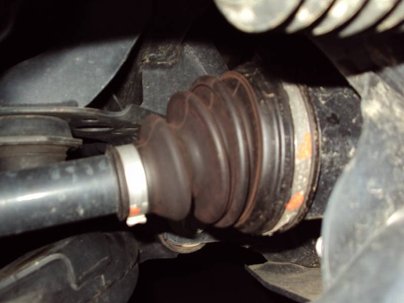

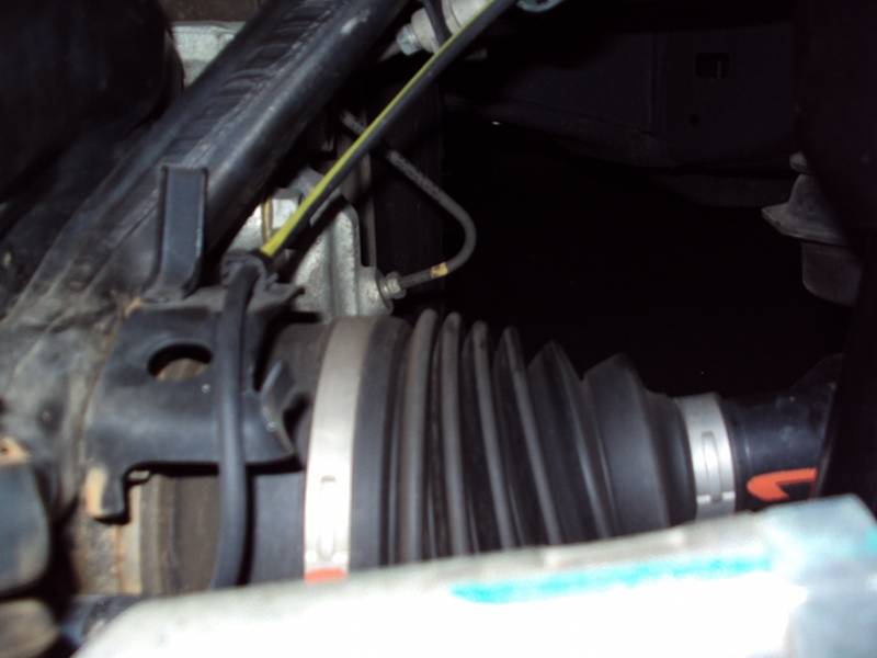

    Here is my angles with 3.5" of lift on a 1st Gen with the diff drop.

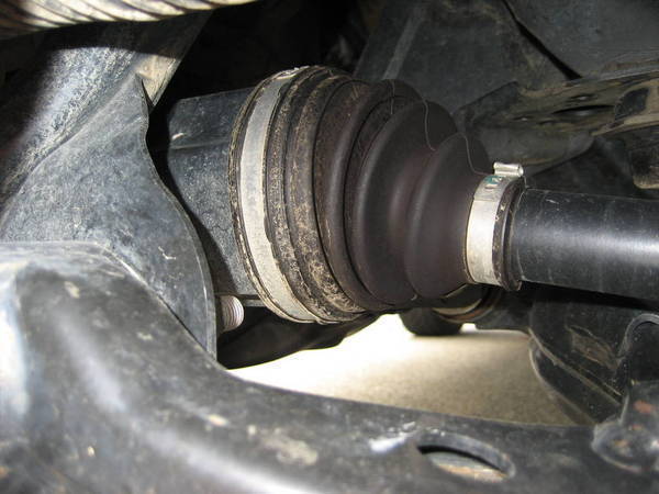

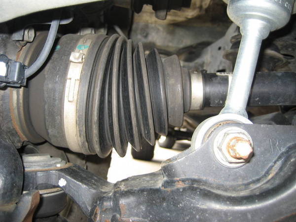

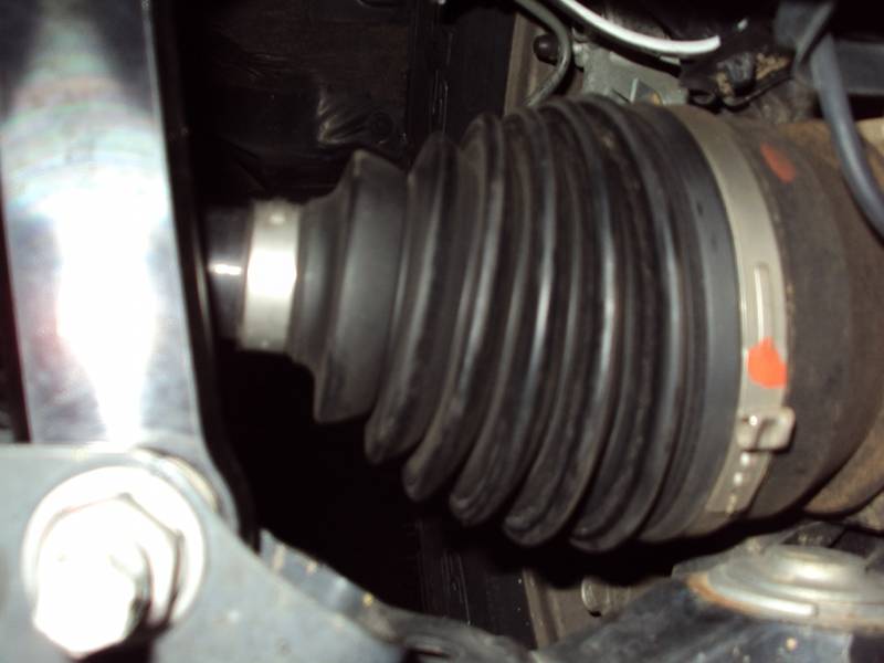

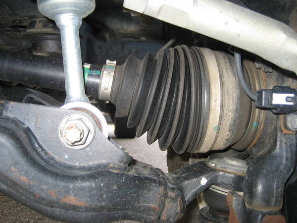

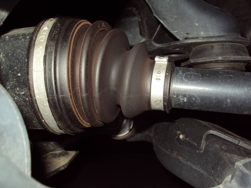

    Here are some of mine with the Toytec Ultimate lift kit. The first pics are the Toytec kit which kept blowing CV boots. The last pics are of the RCD kit which I have had absolutely NO trouble with.
    Toytec
    RCD kit

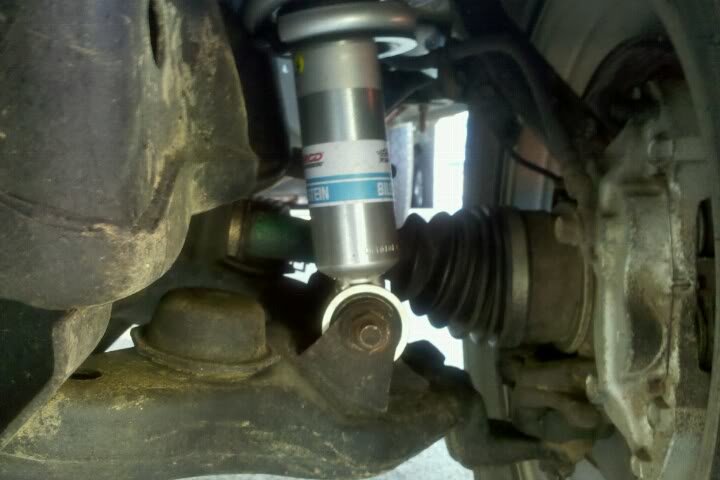

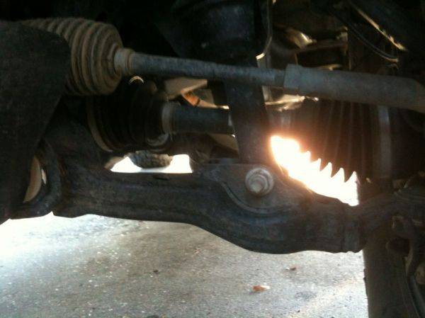

    Here is a crappy cell phone pic. Went outside at work and snapped it real fast.

    My Toytec kit started blowing boots after I adjusted it to a higher setting. Right now with the RCD kit I'm at 4.5" according to the company. Ride is definately a 100% improvement over the Toytec.

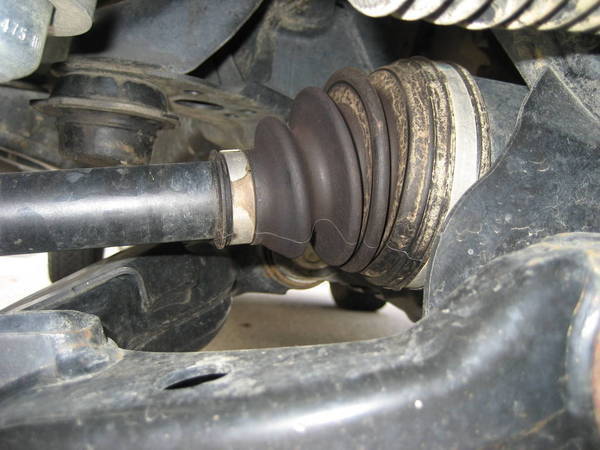

    Ok, cranked it down to the following measurements tonight and the CV angles are MUCH better. Pics below. My pet theory is that erroneous 39" ground-to-fender measurements are being reported as a 3" lift by people who install non-adjustable lifts (OME, Toytec) on Prerunners (which are lighter in the front than 4WD by a couple hundred pounds).
    Bonus item:
    Dropping from 39" each side to 38" cured my takeoff shudder. No more need to dick with the pinion/carrier bearing!
    Ground to Fender:
    Front Driver: 38"
    Front Passenger: 38.25"
    Rear Driver: 40"
    Rear Passenger: 40.5"
    Hub to Fender:
    Front Driver: 23"
    Front Passenger: 23.25"
    Exposed thread on COs is about 1.5" driver and 1.25" passenger. 3/4 tank of gas.
    Pics:
    Driver Inner:
    Driver Outer:
    Passenger Inner (the angle makes it look like the fins are touching, but they are not. It looks like the driver side.):
    Passenger Outer:
  18. Nov 3, 2010 at 5:43 PM
