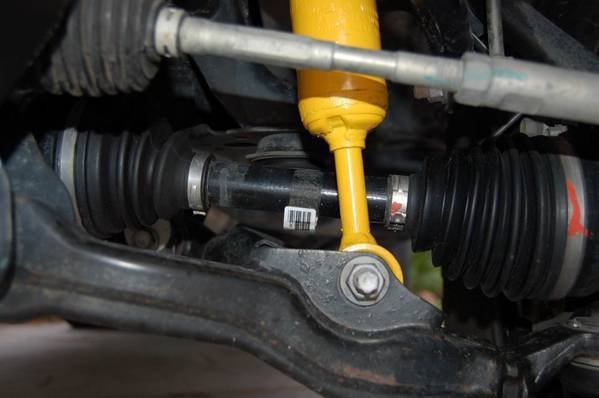

    I measured it today and it's 2.3" higher than before so probably about 2" higher than stock maybe a little less.

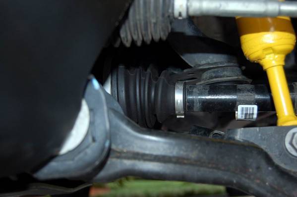

    Angles look gravy though, which is good. Seems like 2.5 to 2.75" is the max safe zone.
    I hope Wyatt gets those high-angle CVs over here at a decent price...I'd totally crank 'em up after adding a pair of those suckers.

    I think they look pretty good to. That's one of the reasons I didn't want to go with the 886 coils.

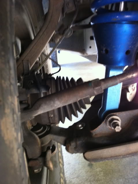

    You guys need to do hub to fender heights. If someone is running 30 psi and another is running 40 psi that will skew the ground to fender comparison. Here is mine. toytec ULK w/ diff drop and carrier spacer. Set to 3.25" of lift, rides buttery smooth.
    25k miles lifted w/ 32" tires and supercharger fun. No probs.
