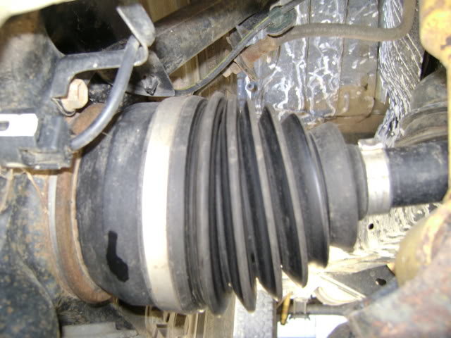

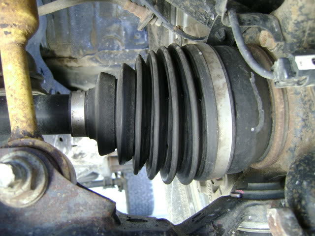

    I know I'm late to chime in but here goes. Toytec lift 3" so said.
    Ground to fender
    Drivers Front- 37.375
    Drivers Rear- 38.625
    Pass. Front- 38.625
    Pass. Rear- 39.375
    Hub to fender
    Drivers Front- 21.375
    Drivers Rear- 23
    Pass Front- 23
    Pass Rear- 23.625
    Drivers side
    Passengers side

    That's a big difference between drivers front and passenger front.

    Its horrible! And drives me Batty.
    I have no clue why its soo bad. However I don't have the funds, due to having knee surgery earlier this year, to replace my lift. My truck was level before the lift and for a while after, then one day it just all went to shit. When I go wheeling she levels out for a few days then back to this lopsided mess. I'm open to suggestions. lol. I was thinking I may have gotten 2 different coils. My lift pertains of new front coils (should be 885's), stock shocks, and rear lift blocks, with the rear TSB springs.

    Probably due to settling. With all the heavy mess on driver's side, there's a chance for a bigger change once the new springs settle.
    This is why I went straight to coilovers - the ability to correct that with a floor jack and an Allen Wrench set. When you do get around to replacing your front suspension, I'd recommend some front coilovers.

    I thought about going that route (coilovers) but it just seems crazy to think that my present lift settled over an inch on 1 side.

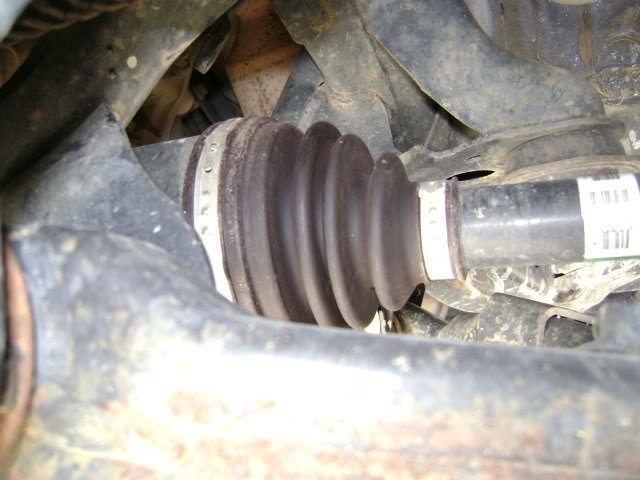

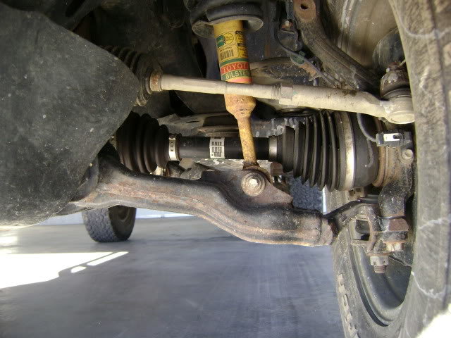

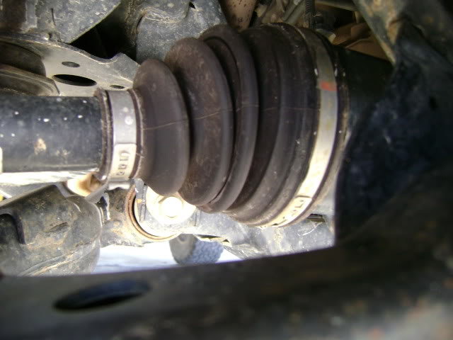

    Some of you are showing the outer boot, those are not the boots that normally tear, it's the inner boots you need to check into.
