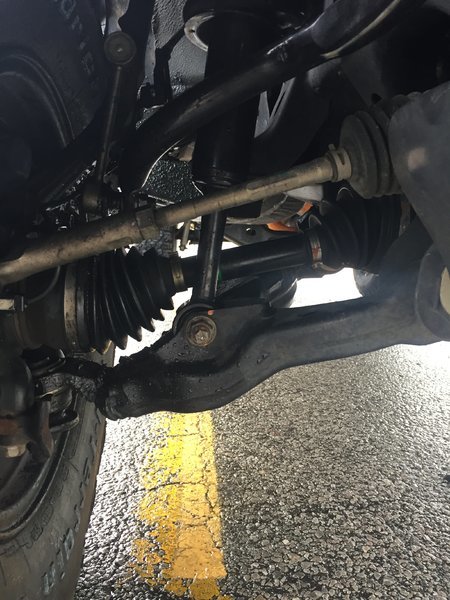

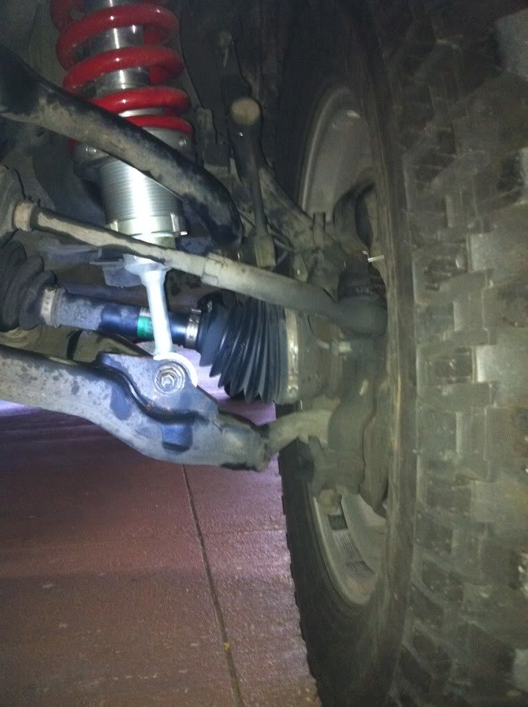

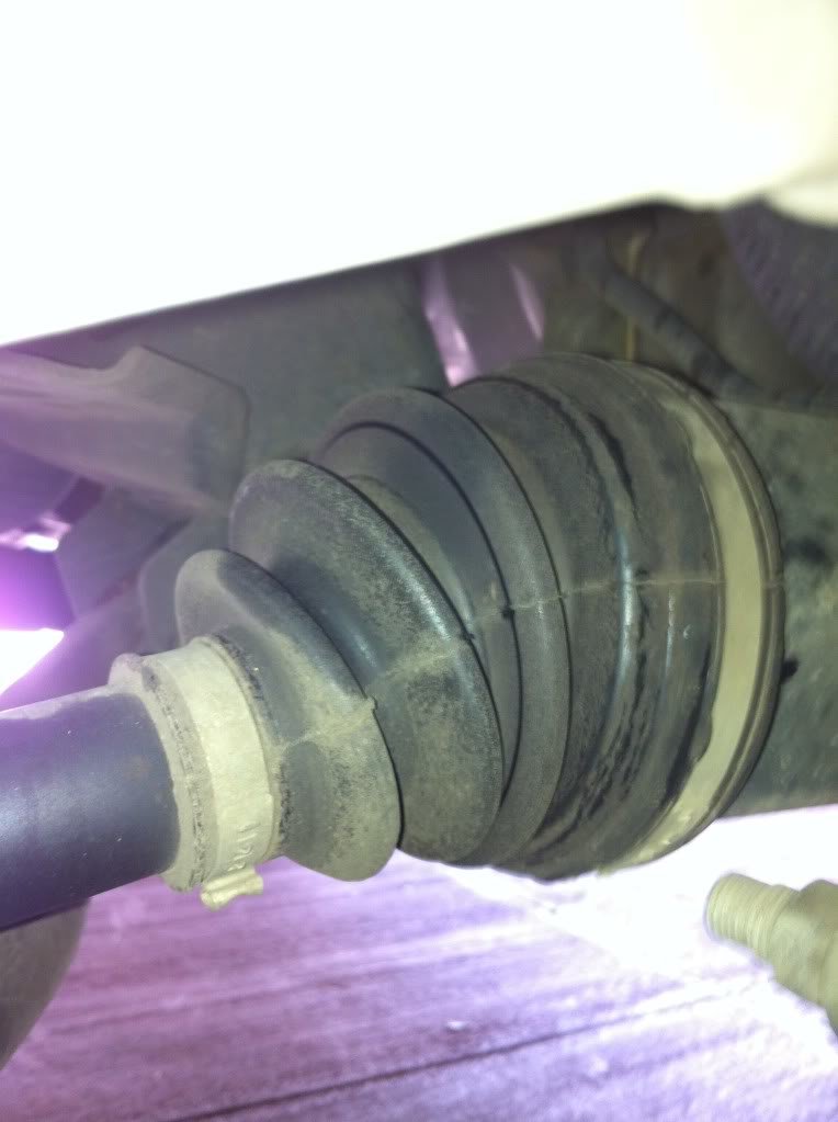

    how does this look?

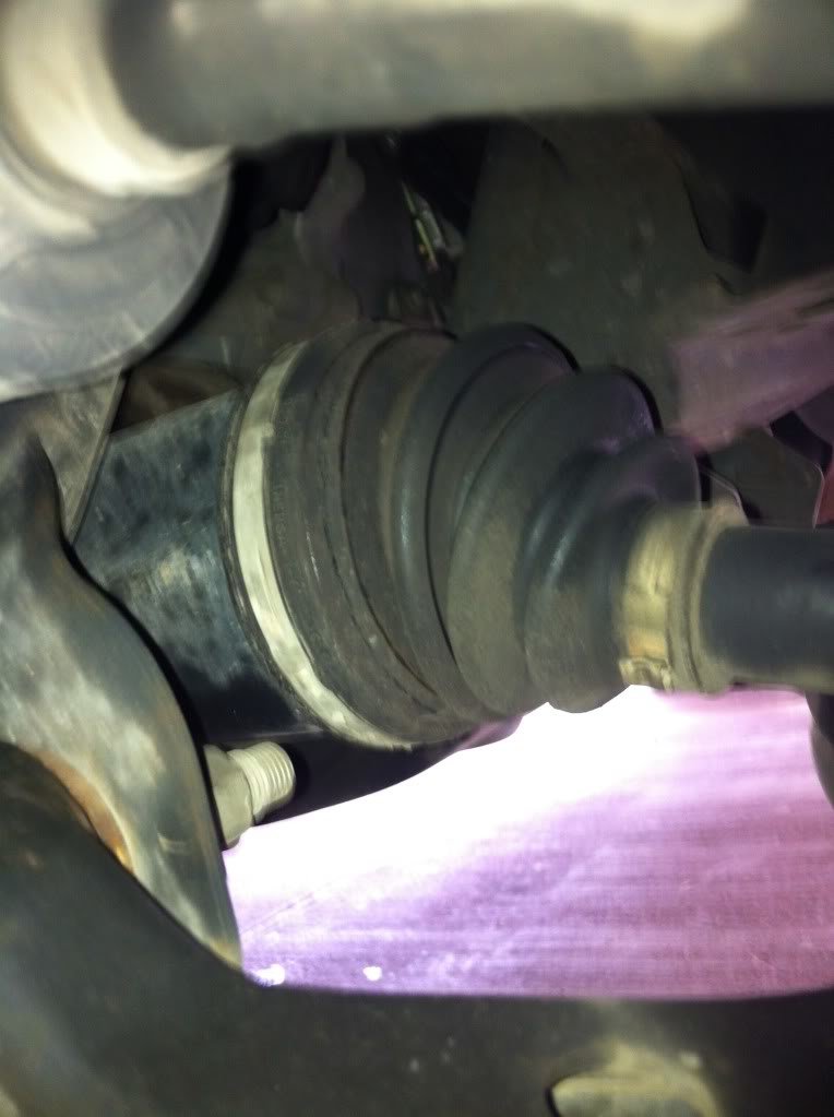

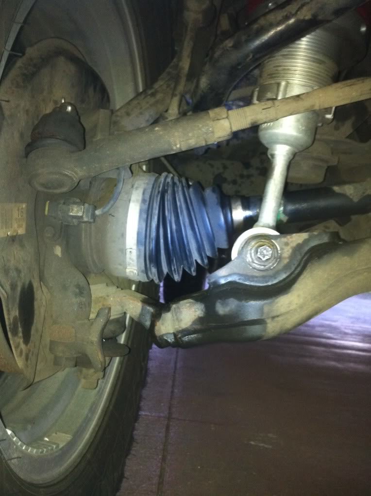

    Here we go....
    passenger side
    driver's side
    and look what else I found. FUUUUUUUUU :(

    jesus christ :eek:
    fucking thats not looking good buddy.
    i thought mine where bad when i got my lift done.
    i went with the procomp lift and that particuar lift has a spring rate of 730 pounds! my truck no shit sat at just over 4.75 inches the day it was installed. its impossible to tell from the pics but the fins where not actually touching they where extremely close but when i got down there with a bright light they where not touching at all. maybe yours are the same way and i can't tell from the pics all i know is there looks like a nice little groove forming on your cv boot there so that tells me at some point during your driving they are touching.
    lol i actually thought mine where ok thats what the shop told me :facepalm:
    so i go posting pics on tw acting like mine are ok an shit lol everybody was like dude those look horrible :laugh:
    so i put on an arb bull bar that helped a tiny bit then i added a warn m8k
    with steel line and its finally acting and riding like it should plus i have a plate steel front skid.
    i would get a diff drop installed asap i have one and i'm actually glad that i installed that piece of crap now. i know that they do not make a big difference on the 2nd gens but, fuck at his point it ain't gonna hurt things. try getting some weight out front if you don't already have a steel bumper and winch i would either take that lift off or start saving for them now.
    for reference heres what mine looked like the day after the instal @ over 4.75 inches above stock. i know it might not look that high in the picture but, trust me it looked huge in person even compared to other lifted tacos.

    I'm going to lower the coils tonight, hopefully that will help with the angle some. :(

    Checked it out last night and they are definitely touching. Attempted to adjust the coils but wasn't successful. Just going to bring it back to the shop next week. Hopefully they hold up till then. :(

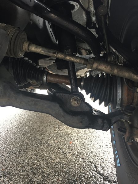

    Fidgit07. Your CV angles look really good to me. Those look like a just under 23" center of hub to bottom of wheel measurement. Are you measuring from the center of the hub? I'll take some pics of mine and also post measurements.

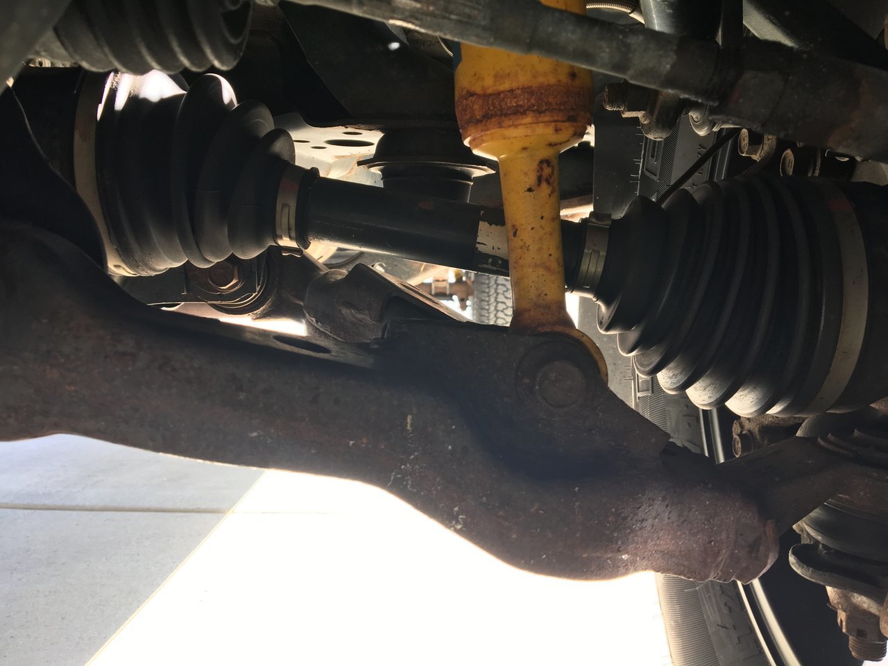

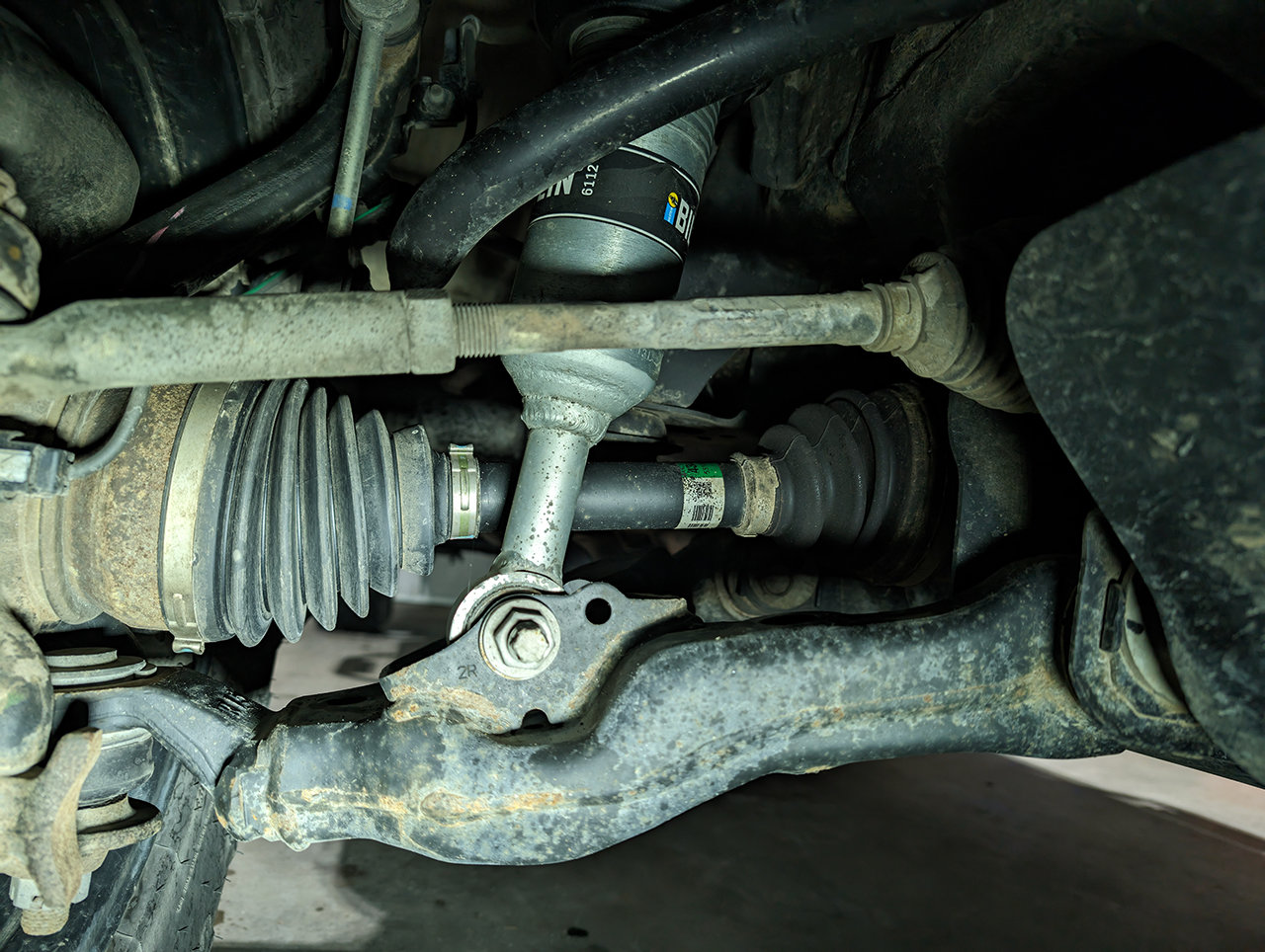

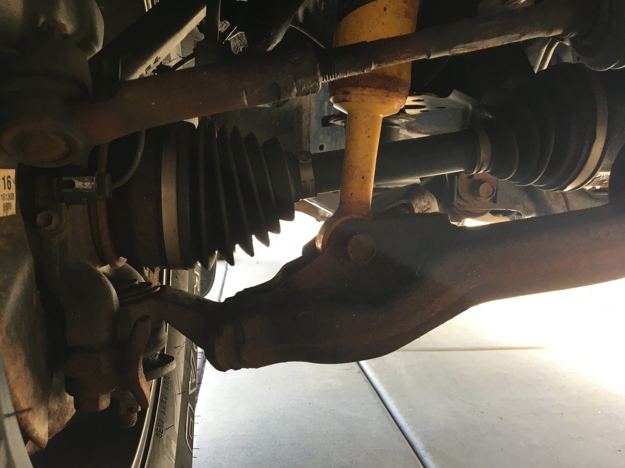

    I'm at 23" driver and 23 1/8" passenger with my OME struts and 887 coils plus taco lean driver side spacer.
    Pics of my CV's
    Driver
    Passenger
    Drivers side inner boot looks a little f'd because of the angle

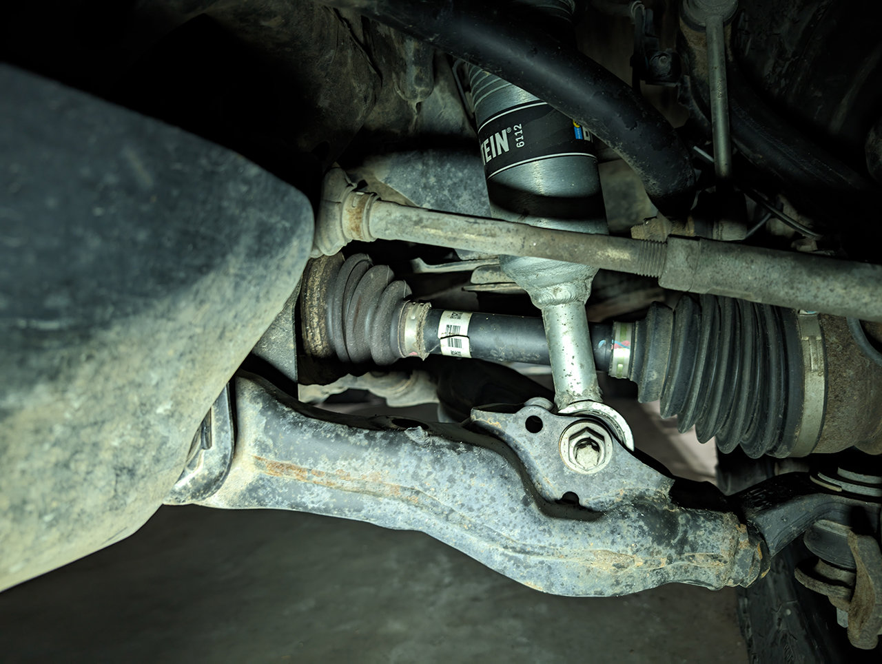

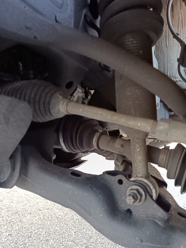

    How do these angles look? I'm sitting at 37" 1/4" driver side and 37" (From the ground to the fender)

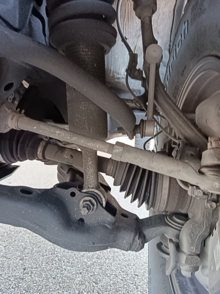

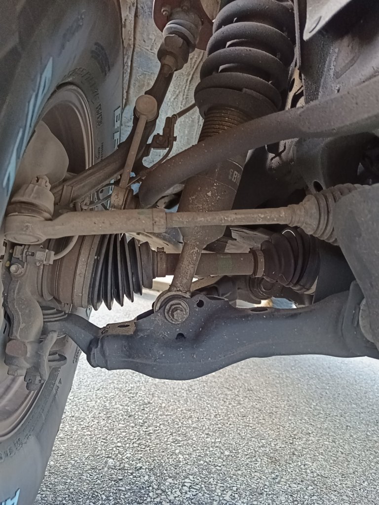

    I wanted to get opinion on my CV angles. I have bilstein 6112 on top notch with 650 coils. Plans on a bumper eventually.
    Passenger side
    Driver Side[
    ATTACH=full]5843501[/ATTACH] IMG_20240916_075634_517.jpg

    Inner boots looks like there touching. With a bumper in your future should lower a bit with weight IMO.

    Good deal thanks, probably going to lower it here in the next week or so. Any thoughts on clip setting for 650 coils. I have the 11 clip style
