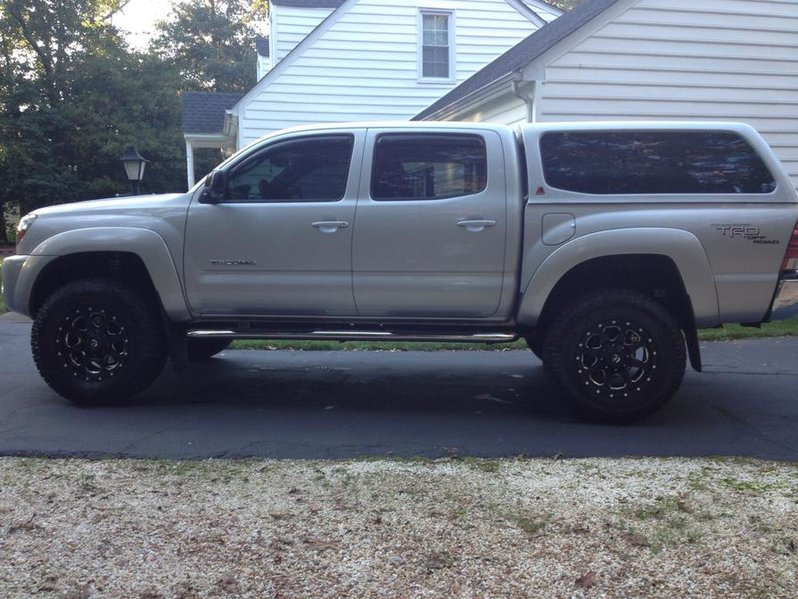

    Finally got my lift done on my 2011... I went with 3" Bilsteins 5100's pre assembled w/Toytec top aluminum mounts and urethane bushings.Out back I went with OME/Dakar rear leaf packs (CSO47R)..also I went with 17''x9'' Fuel Boost with a 1mm offset (5'' backspace). Toyo Open country AT 2's LT285/70 R17... Everything went together flawlessly and the ride is perfect..

    Looks nice. Did you add the overload spring into the Dakars or just go with the original 7 spring pack?

    No....I didn't add any. Installed them just the way they came..
