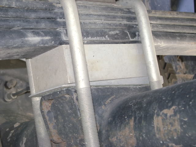

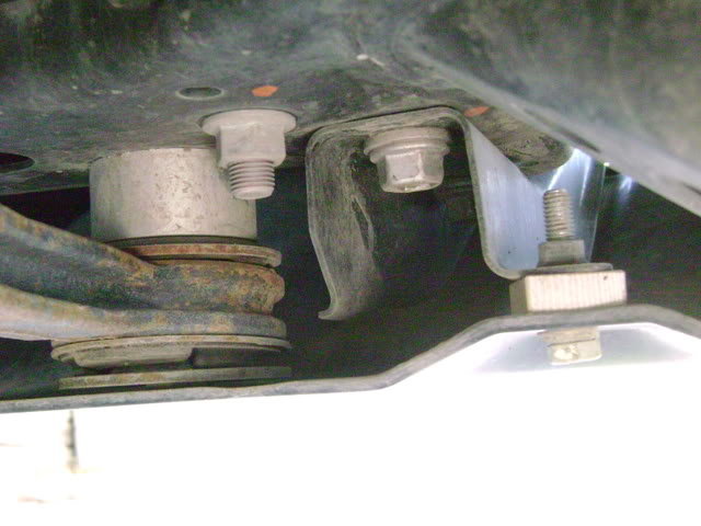

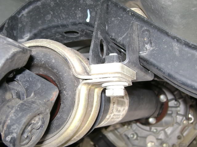

    Chris hit the nail on the head, I have a toyetc 3" lift with rear block and haven't had vibes, I did install the drop kits.
    here are the pics.
    front diff drop and skid plate shim.
    Hanger bearing
    Rear block and shim
    You could easily use longer bolts and washers instead of buying the drop kits. $.02
