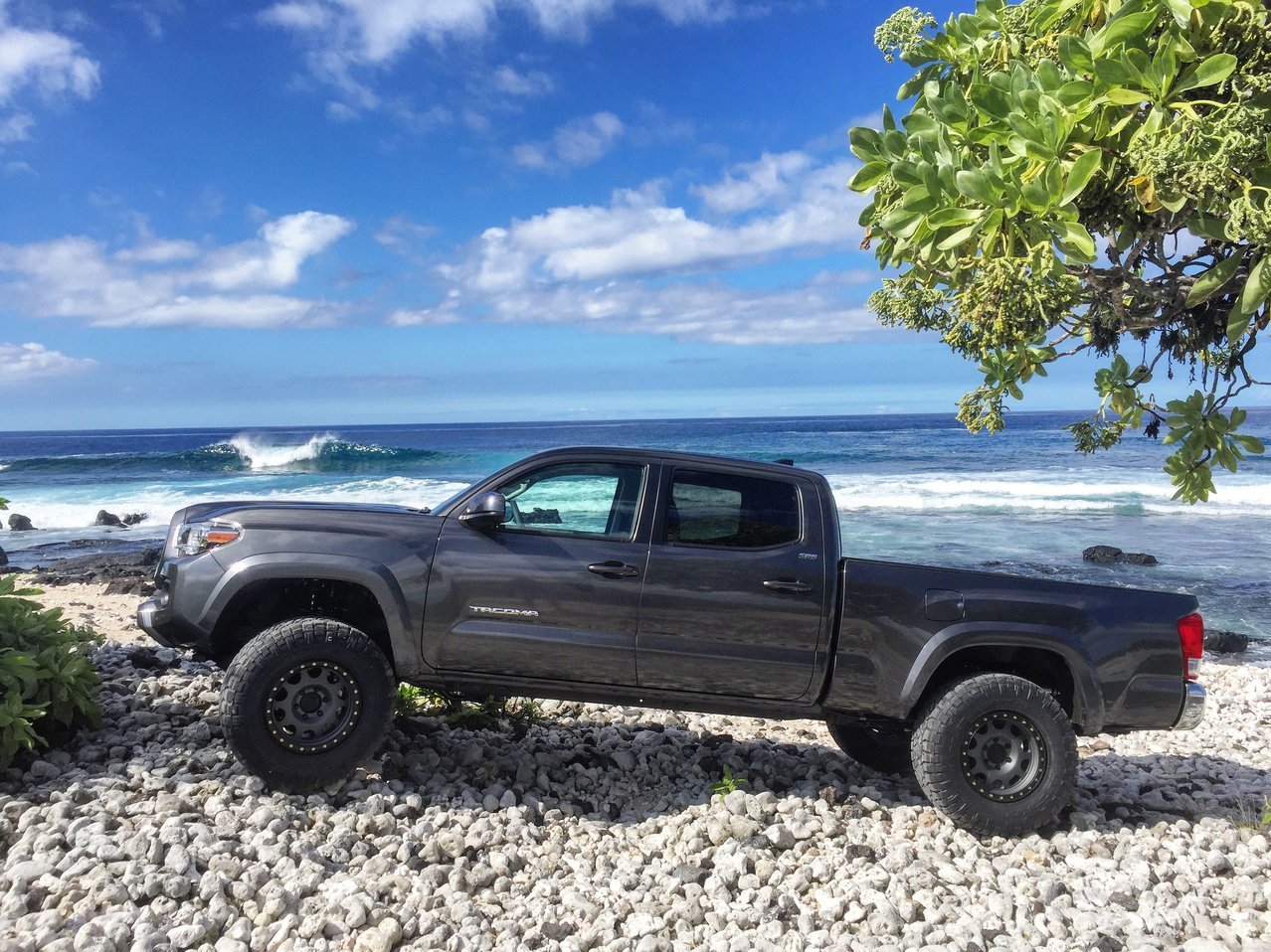

    Billstien 6112 spc uca 5100 resi rear with deaver add a leaf all from headstrong off road.

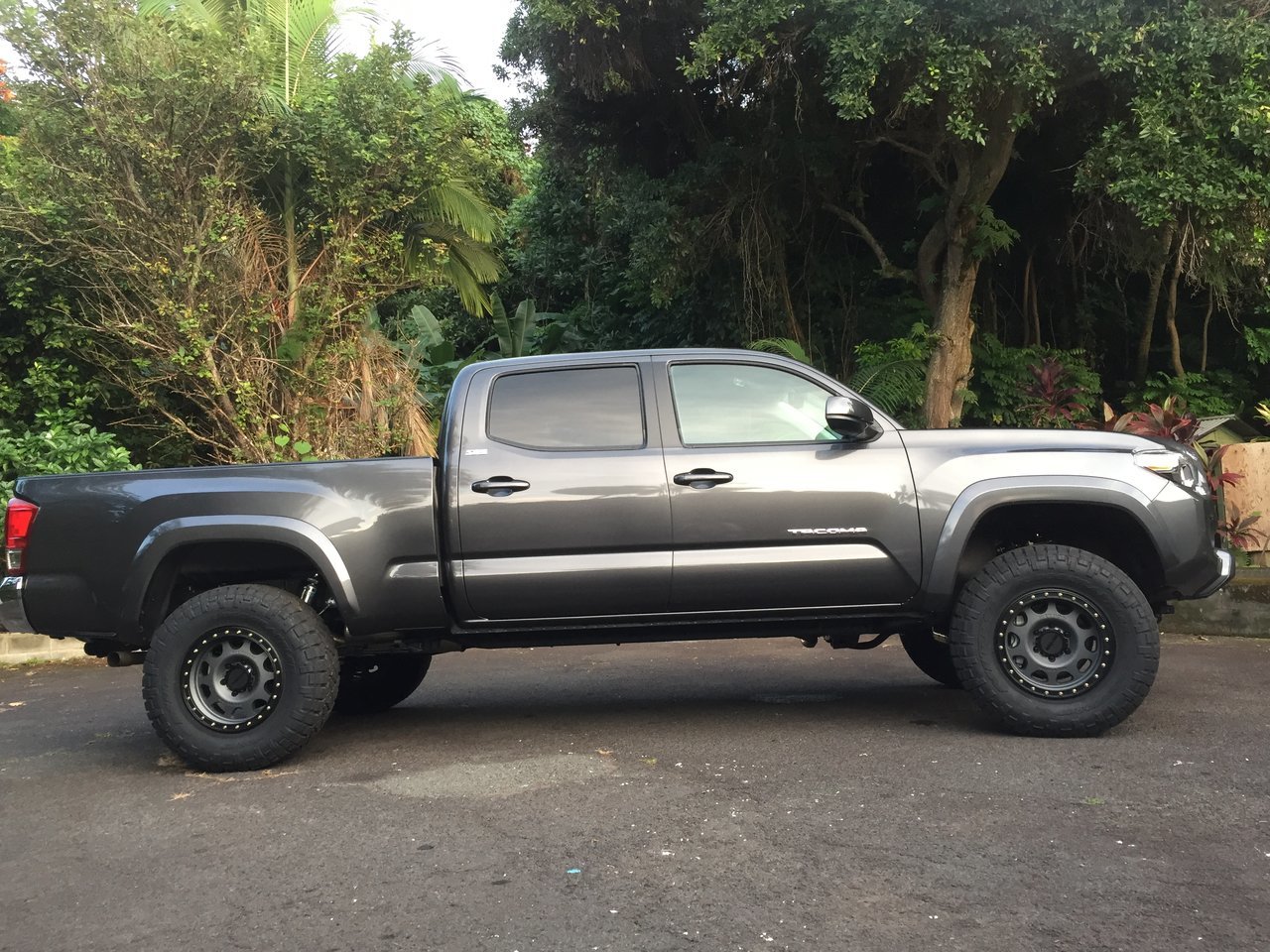

    Method vex titanium 285/70/17 ridge grapplers

    What offset and size are your wheels. Also any rubbing issues. I just purchased 17x9 LEVEL8 MK6 with a -12 offset.

    17x9 4.75 backspacing zero offset.. little rubing at full lock going over bumps

    Looking at a different wheel with the same measurements. Three questions for you: 1. are you lifted at all? 2. what's rubbing? is it the tire on the fender or body mount, or is the wheel itself hitting something? 3. are your tires sticking out past the fenders with that setup?

    Billstien 6112 spc upper arms deaver add a leaf all from @HeadStrong Off-Road
    Rubs lower fender well. Super minor

    Installed in my driveway over a weekend.

    Thank you so much for your recommendation @jacobs808! I just love this beach picture. I am so :jellydance::jellydance::jellydance:
