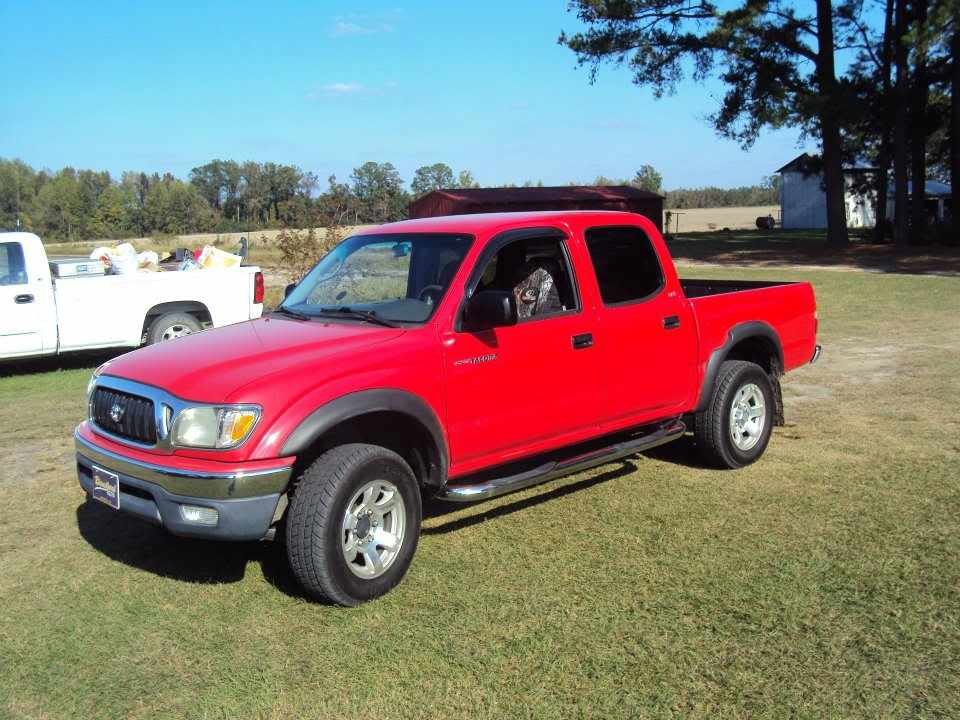

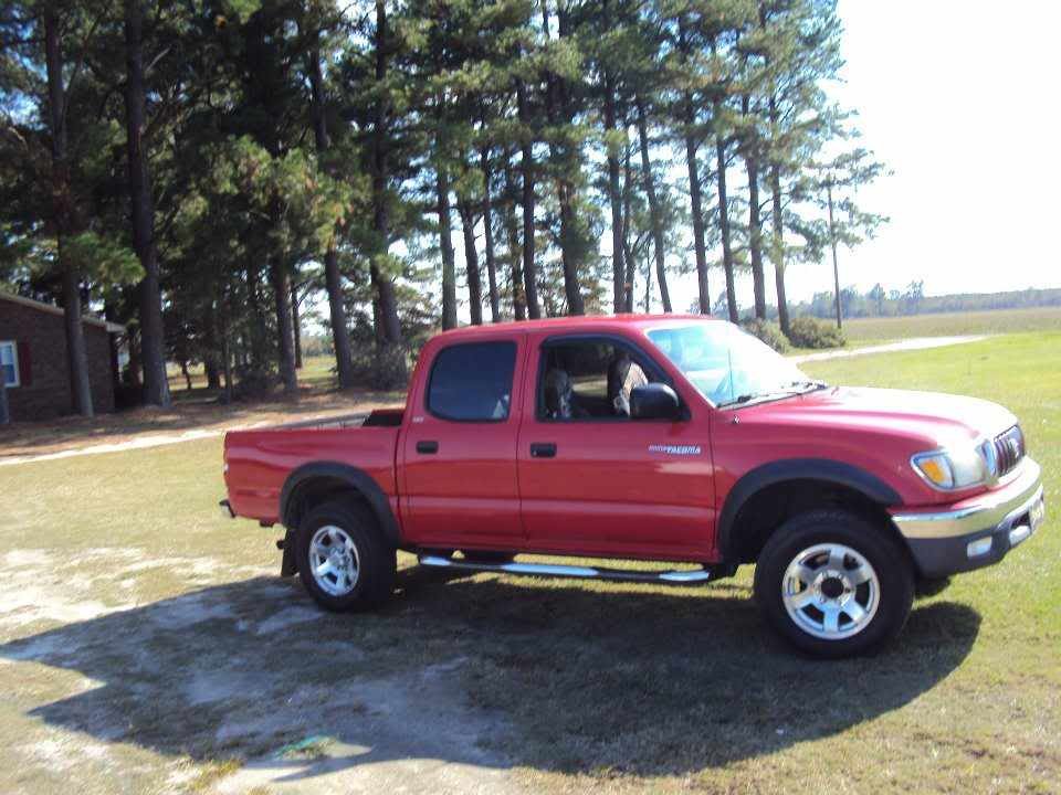

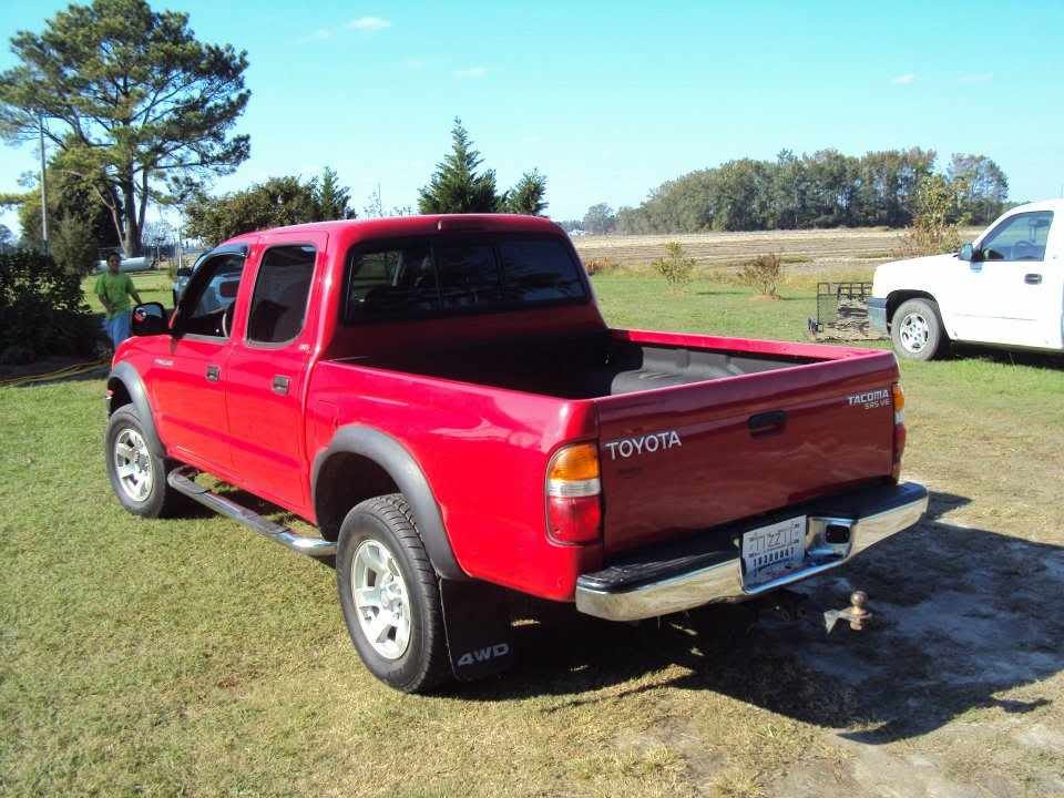

    Hello everyone, I just bought my first Tacoma about a month ago :D and I absolutely love it but now I'm ready to lift it so I'm getting the Revtek 3'' lift and the website says i can fit 33's but i just wanted to make sure before i buy the tires that they will fit. If 33's won't fit then would you please tell me the biggest size i can run. btw they will be mounted on my stock 16's till i can find some i like, Thanks
    Here are some pictures of my baby the day i got her
