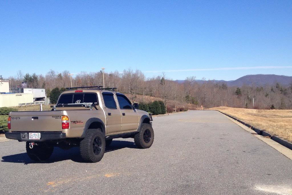

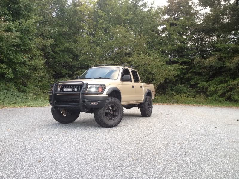

    same setup you're after, but i run 285/75/16 with 1.25" wheel spacers. trimmed the inner fender behind front wheels and hammered the pinch weld flat. no rubbing issues around town
    1D91F3E2-E57A-4904-8CB5-2AC44A244C78_zps_fa2b246e77aa0a1a74badfa00408ba1e4e81851e.jpg
    D796E291-3B67-4C03-8030-E3AA18864C66-835_38342d13686a6415e980cdb07963920ab4b693b4.jpg

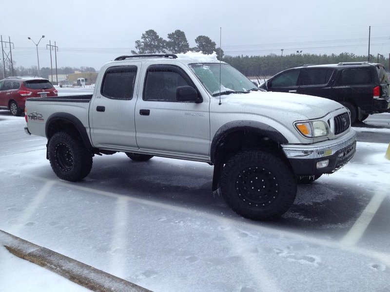

    My 3" toytec ultimate lift and 33x1250 duratracs. I believe the wheel has a -30mm offset

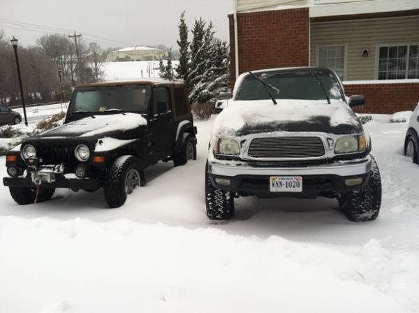

    Well I run 33x12.50x15 on my 04 X-Cab with a 2.5 lift and had to trim my fenders and pinch weld alittle bit but other than that I'm fine doesn't rub and I do off-roading and daily driving with it.
    Not the best pics for the stance but you can see kinda see it.
