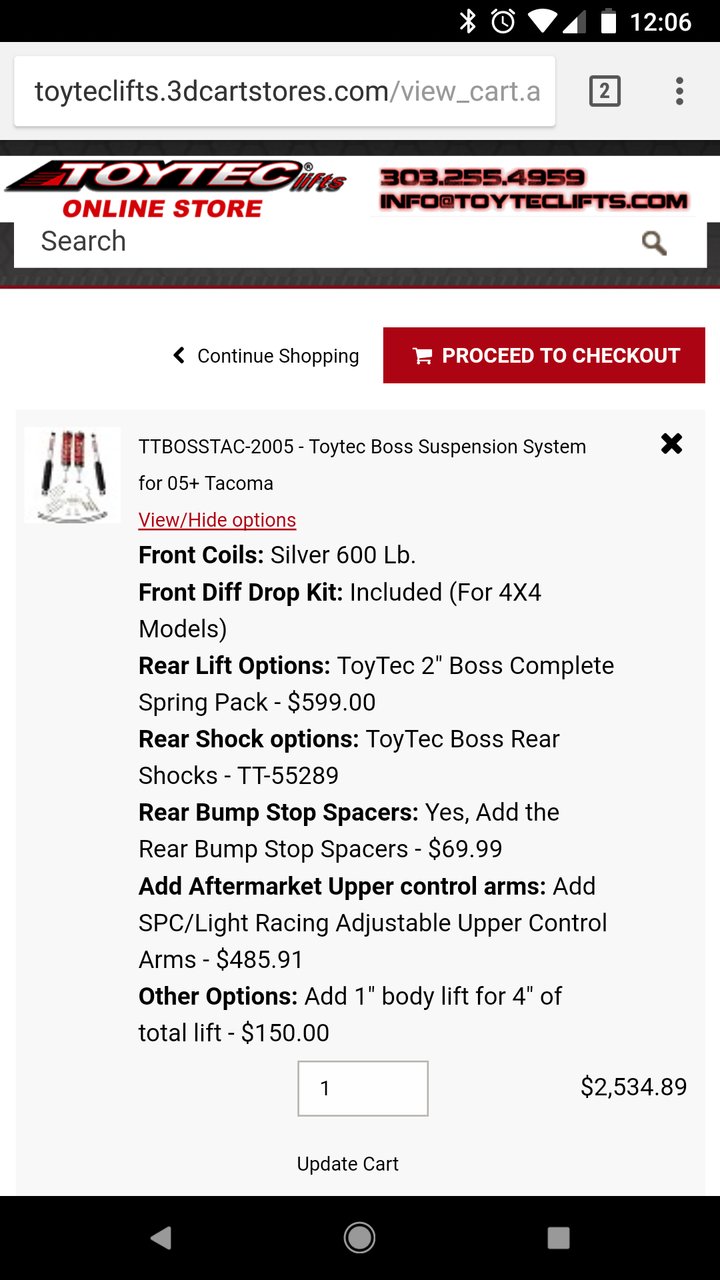

    I can't see the 1" doing any harm, maybe a pain to install.
    With or without the 1" body I'd really like to stuff 33's (285). I'm ok with trimming a little for no rubbing at full lock, but don't want rubbing for daily driving.
    I'm currently running the stock 265/70/R16. I'm thinking with or without the 1" body I would be safe w 265/75/R16 just worried they may look too small w the lift...???

    If you'd like a really good option and aren't hung up on a wider tire you can fit a 255/85/16 on your stock wheels or jump to 17's with a 255/80/17. These are dubbed skinnies or pizza cutters but depending on your choice of brands thy don't look skinniy at all. In reality they are only 1" more narrow than a 285 I believe and are a true 33 where the 285's are really more or less a 32. Because of the decreased width clearance isn't an issue and even though they are heavy (I believe all or most in this size are E rated) the decreased contact patch offers less rollig resistence so you don't "feel" the extra weight much at all if any. Just an idea

    285 = 32.8" tire

    Tons of folks run 2-3" lift with 265's, 255's on stock rims shouldn't rub with a 2-3" lift.

    Ok I was wrong IDK WTF I was looking at. The 255's are only a hair taller pretty much the same I guess it's more if you want a wider tire or not i guess

    Hell I had the 255's on mine with stock suspension and they barely ever rubbed once I did the lift no problem at all

    See @TacoUSMC 255's for the win or break out the snipes and a sawzall.
