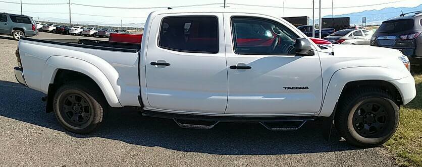

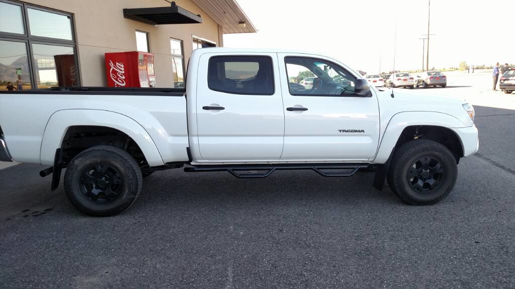

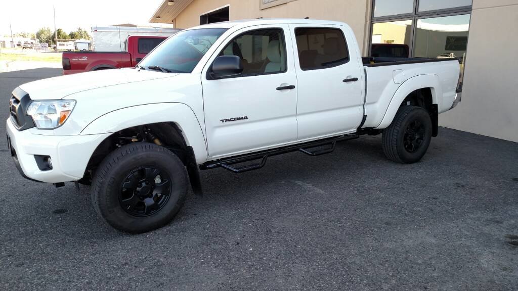

  10. Jul 31, 2015 at 9:28 PM
    #170
    Kyitty
    Kyitty Mr. Beard
    Feb 20, 2015
    #149179
    9,586
    Bozeman, MT
    2015 Tacoma DCLB Better Than TRD
    See Build Page
    Just got my OME lift installed today. Have only had time to drive it straight home. Had all the old suspension in the bed sliding around.
    Definitely notice the difference in height.
    OME Nitrosport shocks front and back. 887 springs up front. Full Dakar rear leaf pack. Light Racing UCAs.
    Tires: Michelin LTX M/S 2 265/70-16
    Before:
    After:
    dborrer, luchin and pyriteCO like this.

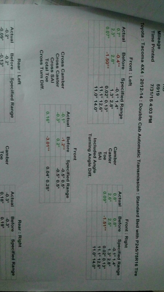

    How critical is it to align the truck immediately after installing a 3' lift?
  14. Aug 1, 2015 at 6:32 AM
    #174
    Kyitty
    Kyitty Mr. Beard
    Feb 20, 2015
    #149179
    9,586
    Bozeman, MT
    See Build Page
    Probably critical.
    My right side was barely adjusted. The left needed help. The toe was way off on both. This is on a new truck with 5,900 miles on it.
    pyriteCO likes this.
