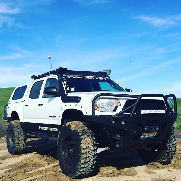

    Allpro Long travel with Long travel Fox resis. Old man emu Dakar leaf pack with the add a leaf. Bamf rear shock relocation with 12 inch fox resis.

    You will have to remove the fender liners and flares, trim the fenders, fold the pinch weld and you will still rub on bumps. I highly recommend regearing. Its my next mod going 4.56. Your truck will be very slow without and it wont be good for your transmission. But dam 35s look good.
