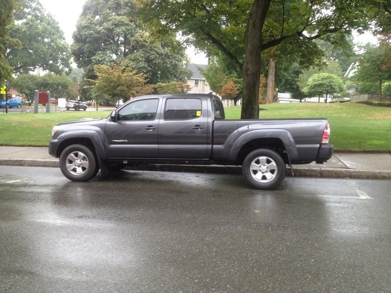

    I have a 2015 TRD Sport with 1k on it still smells new. i want to put a 3" lift in so i can fit some 33"X 11.50. I'm not not afraid to spend a little cash on it. I'm not planing on doing any rock climbing or serious wheeling. I surf in the northeast so sometimes getting to spots means wet/snowy roads and long road trips. I just want to get a more aggressive look with our sacrificing ride quality or damage to the truck. any one have a good set up to research to help me achieve this. It seems like new leafs in the back and coil-overs with reservoirs up front and maybe some type of chip that corrects the computer in the truck to shift and read speed properly with the bigger tires? thanks for any help if theirs threads about this please let me know! thanks Everyone!!

    The best way to avoid mechanical problems is to limit your lift to a couple of inches.

    Old Man Emu Dakar springs in the back with the 3rd leaf removed, Bilstein 6112 shocks/coils up front set on the 3rd groove. Bam.

    Toytec BOSS setup would also work. A little more cash, but the ride is worth it, IMO. Even my buddies with this setup on their Tacomas like it.

    OME dakars nitro chargers with 886's up front. Go with 885 if not running bumper winch and sliders. I never installed the front dif spacers. Took me and a buddy 4 hours for the front and back install.

    Cool truck op!
