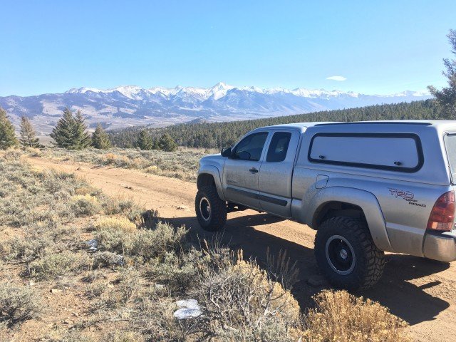

    05 TRD OR Access Cab
    3"OME, 255/85R16
    6" Fabtech on 305s. No trimming necessary. If you go 6" make sure you get a kit with full coil overs and not a spacer on the front. I also ditched the big ass rear block for a set of 4" HD leaves and a 1" block.
